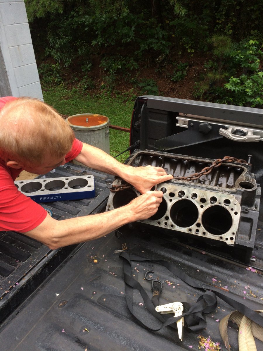

  16. Fun sweaty weekend of pulling elephant motor guts while all my friends were at the Meltdown . Jack got his new go cart running and said - I'll be back - he rode off - never saw him again ;)
    Monday morning doctor visit - say ahhhhh
    The power is out so we did some tailgate ring research .....
    So - the doc thinks its not the ONE thing - probably a little out of round and the gaps were a little too big - not bad but loose - the 14# oil rings are on the light side. He's going to torque hone and or the 19# oil tension. He will have it on the Sunnen machine later this week to see if its out of round.

    Have Johnny Beechem or Dykem a few bores and have him take a few strokes with the hone while the torque plate is on. That will show how out of shape they may be in.

    Enlarged the text to a readable size in that page outta the ring catalog, and it does seem to imply that the special low tension are intended to be used with "vacuum control systems which create a vacuum in the crankcase to assist the oil ring in controlling oil".:rolleyes:

  24. Yeah that's what we are thinking - something is on the edge of failure so why ride the hairy edge?
