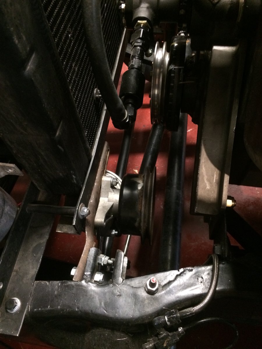

    Finally Gabriel said let's go get a diesel truck vacuum pump and see if we can suck the crank pressure low enough to seat the rings.
    So off we go to Advance Auto and came back to make up brackets. We needed a pulley and asked everyone we could find - nothing turned up. Gabriel needed to make some practice runs befor 10:30 track closing so that pretty much ended Friday.

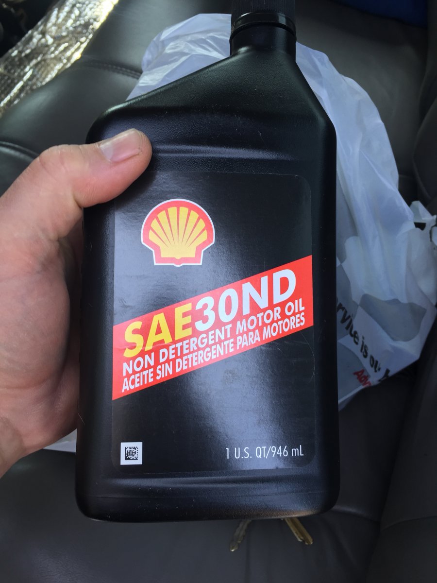

    So while hooking up the pump Jimmy calls Gabe and says get 30w Non-Detergent oil. So I called @3dnsouth who was inbound and he searched until he found some at a Shell station
    Sorry for the low picture count
    So we finish the pump and pulley and drain the oil and wait for the new oil.
    Here is the pump - no belt because it slung off after it did its job.
    We put in the new oil and Jimmy Huff gets there. We start it up and it smokes to beat hell. Jimmy says "whack it" I'm like ok. 4,000 rpm , 4,000 rpm - we can't see anything now - he says no WHACK IT - I put my head inside to watch the oil pressure - the Jimmy grabs the injection and the tach goes to 8,000 and back down and then 8,500 and back down and he did this about 6 times. Then we shut it off.
    He says - tow to the start - do a short burnout and run down to the end hard - but only to 3rd gear - then let off the gas and drag it down to the end of the track with the clutch engaged.

    So if I'm understanding this, the vacuum pump plus the "back down on the engine" in third gear sucked the rings out against the cylinders enough to seat them! Amazing! I've learned something today for sure:eek:o_O:D
