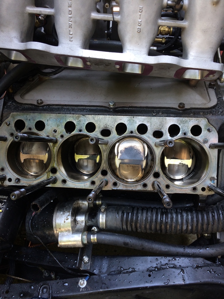

  15. Pulling the head and pistons out and watching the Union re cap

    Am I seeing #4 being the problem?
    loudbang and Tyresmoke like this.

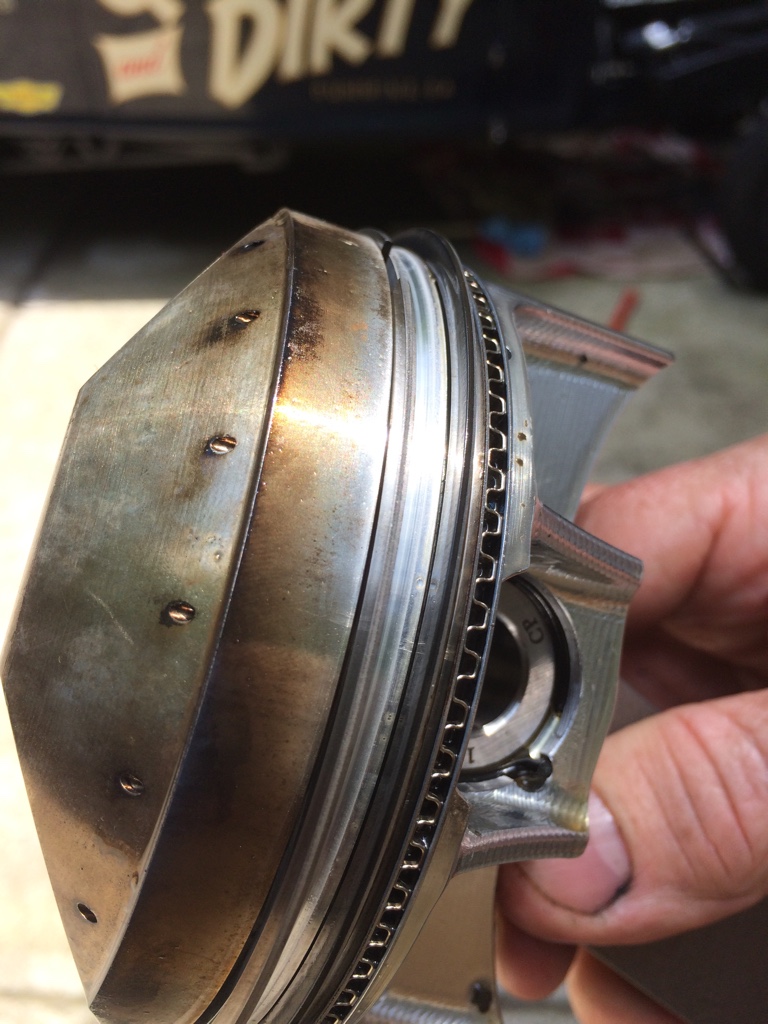

    Is the top scraper on the oil ring setting correct? 6d0610791099b9eab738f1705fe65d06.jpg
    It looks lower than the lower scraper starting about center of the rest pin.

    Tyresmoke has a good point has a good point about the underside of the piston head possibly being an indicator of localized heat.
    But to me, the dead giveaway here is the carbon coating the crown of he piston head in the center, while relatively clean out on the perimeter where the influx of oil has kept the carbon washed off.
    Also the holes that allow gas pressure to push top ring out show a tinge of carbon stain surrounding them. And this seems to indicate that so much oil is getting past the oil ring that some of the excess is actually getting to the piston crown via these holes.
    All of this indicates that either the oil rings aren't catching the oil efficiently, or else there's simply so much oil there they are just being overwhelmed by the flood of oil thrown from the crank to the right side of the engine, aggravated by the lack of an oil scraper.
    I'm assuming that the static oil level is below the reach of the crank and rods, etc?

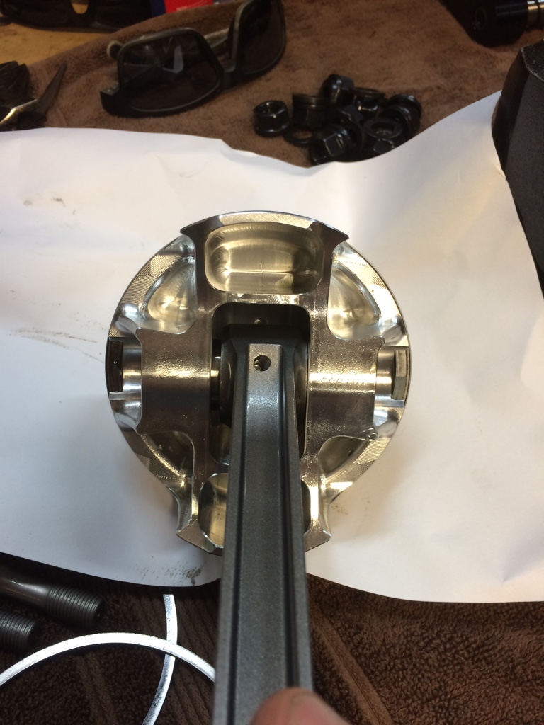

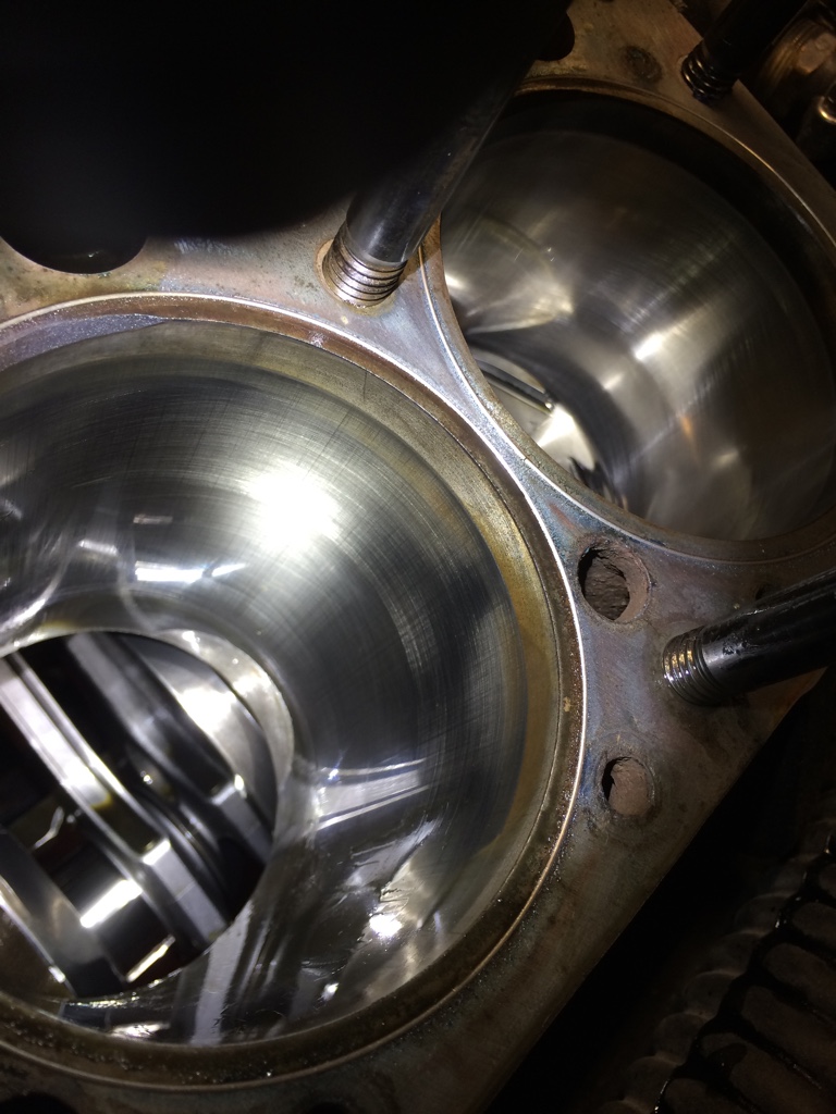

  22. Just happened to pull #4 but all of the cylinders feel like Vaseline on the walls. Never seen that before. Here's a shot from the bottom
  23. Nothing is jumping out at me. The cylinders look like they were polished. I wonder if the rings didnt seat. Were the rings standard tension or light? There seems to be a difference on the amount of carbon on the pistons. What does the head look like? The only sugestion i have is to put the dip stick in and make sure the full mark is below the crank level .

  26. Light tension - same ones that worked fine the last 2 seasons. The other set was in the 392 motor. The only thing I did different this year was the first batch of oil was Lucas 20W-50W Break in oil. The previous years were just Mobil 1 10W-40W conventional that was on sale at WalMart - probably should not have done the fancy oil .....
    Johnny checked the bores really close - he freshens up roundy round motors all week long so he knows what he's doing. The only thing different is the low tension rings. He hadn't seen anyone doing that with wet sump before. He was concerned. It worked 2x before though ..... he'll probably say it works 66.6% of the time - do you feel lucky?
