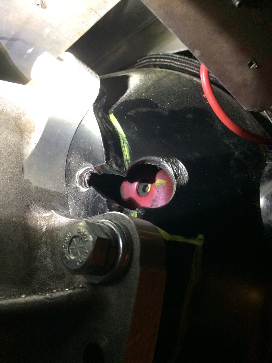

  20. Finally got tired of the access hole to the clutch springs - posting so anyone running a RAM cintered iron might save some time if you do this on the bench instead of the car. I used a drill, hole saw and a air powered sawzall .

    Tony, not having seen that bell hsg before and that pic being so close up on it when taken, its hard to visualize what you've done, but Hopefully that'll make adjusting an easier job.
  26. Yeah missed 3rd about 50% of the time - then broke the shaft on 3rd because it was gonna go damn it - $700 to fix it and it missed 2nd 2x so I sold it cheap. The Jerico - - knock on wood has never missed. Probably the driver seat position is too high in my car because the 55 Chevy guys shift the hell out of the Hightower.
    Here's a better pic? Just having a hole you can't see in was some of the issue.

    Only downside to ur mod is it won't pass a true nhra tech inspection
    Sent from my SM-G900V using The H.A.M.B. mobile app
  28. No Hot Rods Allowed
    Hatchet, Mtn Goat and loudbang like this.
  29. greybeard360
    Joined: Feb 28, 2008
    Posts: 2,079
    greybeard360
    Make a bolt on cover for the hole... Probably pass then. There are scattershields made with large removable plates just for adjusting the clutch.
