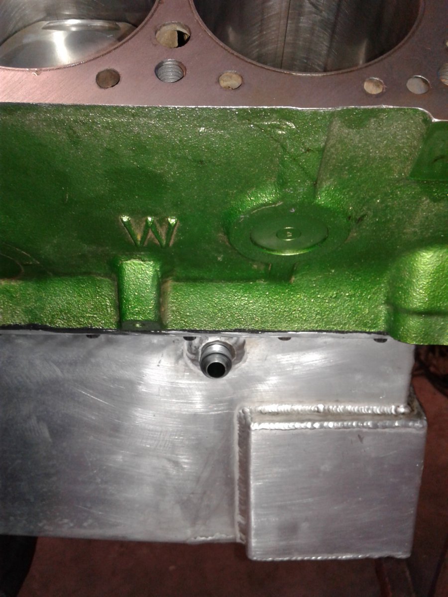

  1. Heres a few russian hacked spy photos. Dont run restrictors with roller rockers. They need a constant 35lbs of oil pressure. A nitro dragster can get away with restrictors because they are pre oiled before a run. They are also towed around. The total running time is very short. To change the valley cover a head needs to come off or slide it forward but this makes a big mess. 20170418_091246.jpg 20170418_091302.jpg 20170418_091144.jpg

  2. dirty old man

    Thx Racer-X, for the pics and the info. I've never twisted a wrench on a hemi, always been kind of intimidated by their complexity, sheer size, and weight.

  5. Awesome info racer-x ! I thought you guys had done something to improve the flow. I've been pouring the oil very carefully in the valve cover with the #1 or #2 plug out for 3 seasons - it doesn't get into the cylinder, use a flashlight and take your time. BUT - believe it or not this first start on this engine was all poured in the valley because the intake and cover were off. It didn't start this goofy smoking until I drove it around to warm it up. Never smoked loading on the trailer and initial testing. So it does make me think it was oil pilling up on the exhaust valves which have no seals. Then to really fog it down the evac tube was on the lower back of the cover so it probably got deep enough to Exxon Valdeze and that's when I was waived off the starting line.
    Now - the valley pan is getting swapped out to one with a real baffle and fill tube. You can remove it with the radiator on and so right now is a perfect time to swap that. I'll shot some pics tonight. All good info - Smithberg was not interested in limiting the oil flow to the rockers either .

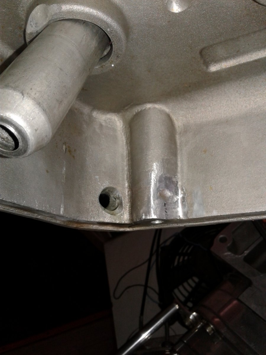

  9. The oil drain back hole was about 50% plugged with the Hylomar boogers. After looking at these holes, I would have opened them up and aligned them better when this was on the engine stand. The hole in the head an the hole in the block are only 75% aligned. This is probably why last 2 years it never smoked like a bug fogger - the drain back was ok for 1/8th mile passes. If I don't run out of time, I'll drop the pan and do a Racer-x hose. The 1" spacers would make it super easy on the top. Dropping the pan is lower on the list still.

    The new plan for a cleaner pan evac is to use a real 392 valley pan because its pretty well designed. The plan is to weld a T fitting to pull from both headers. Then a threaded bung to allow for real oil filling instead of pouring into the valve cover. This stuff never ends from what I can tell .......
