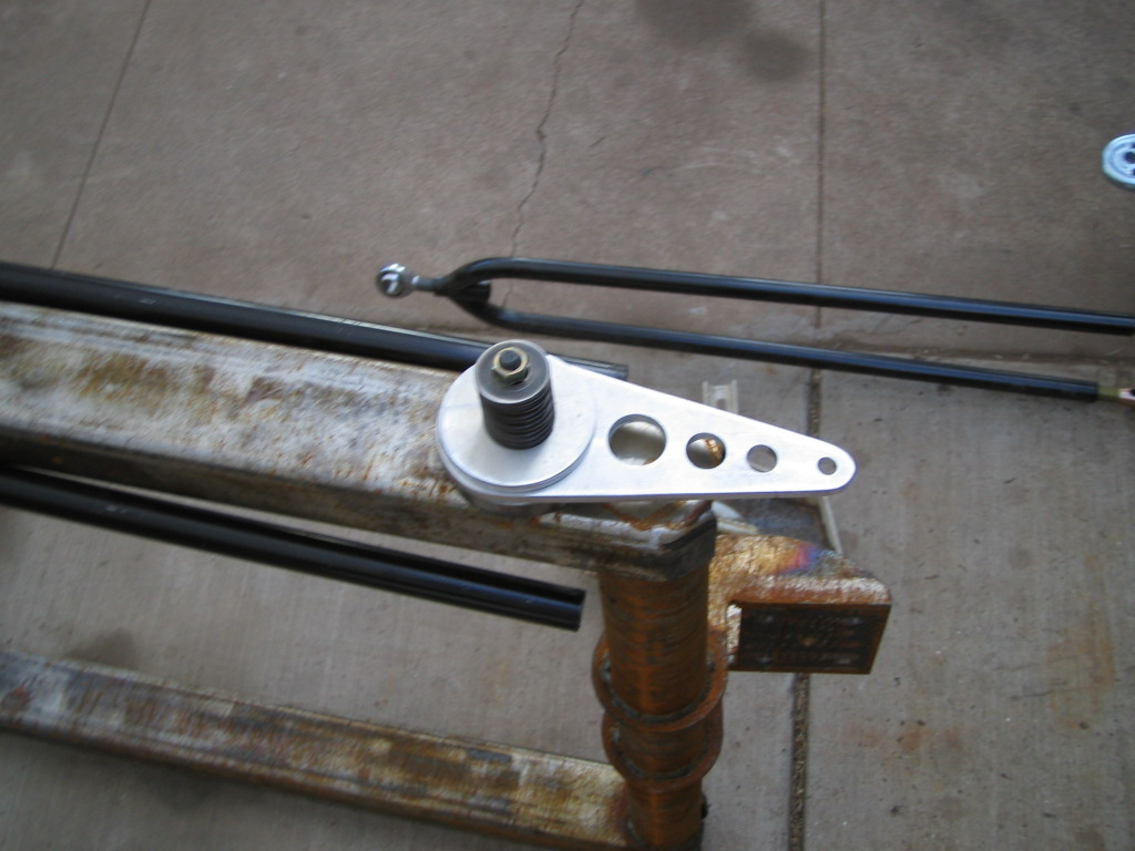

    Speedway and others have been offering a cast aluminum type for years now that as shipped are not very functional. Most I have seen have no friction material in them, and no spring to control the tension. Put a longer stud in, grab a valve spring and retainer from what ever engine you have laying around for parts, and use either the urethane suggested above or a fairly thick chunk of leather as a friction medium and things will get lots better.
    Here is a picture of the type I make for customer chassis. Super basic, and with the spring and friction material, quite tunable.
    Might want to check the balance and roundness of those front tires too. I use the balance beads in everything.

    Short like need louvers ? posted are the way to go. I see many that are 10 inches or more in length, and mounted inboard or back off the wishbone, not the way to do it. If they are long, or mounted as I stated, when the suspension moves, say, 2 inches the shocks have moved maybe 1/4", not much in the way of dampening is done. As with any shock as close to the wheel as you can will help them to better do their job.

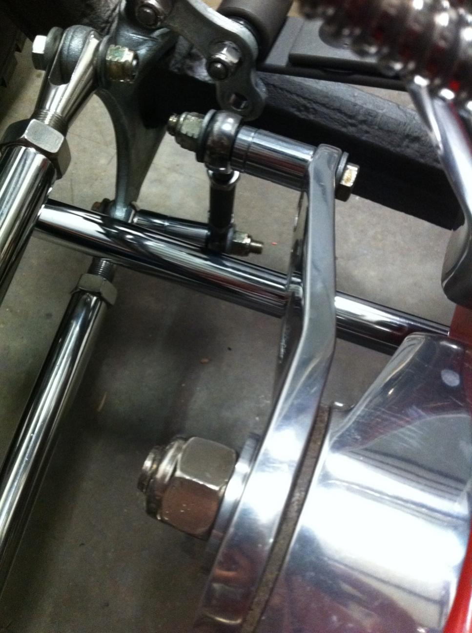

    Hi Guys:
    I am dealing w/ the same thing- hit a series of bumps and both wheels basketball in unison.
    I had the shock mounted to the shackle plate at the spring side, which I think was the problem. Now I have hooked them up to the bottom of the hairpin/ batwing hole like this:
    Any problems you all can see w/ this setup?

  16. need louvers ?
    Joined: Nov 20, 2008
    Posts: 12,911
    need louvers ?
    I'm not a huge fan of that long bolt and extension on the lower batwing mount. Too much length to move around and cancel out the movement of the shock itself, not to mention fatigue at a critical suspension connection point. Ideal would be a small mount welded or bolted to the back of the axle itself. That's what you are trying to control and what will have the most range of movement. Just as I was saying in my post above, if you added a second outer friction disc and backer, longer stud and spring you would have a much more control able and tunable friction shock.
    Just a note, My picture above doesn't yet have it's friction materials in place in the photo.

  18. DaveyJonez
    Joined: Feb 20, 2006
    Posts: 402
    DaveyJonez
    from Houston
    That's what my gut told me as well, just hate to drill my 32 axle...
    But that's the right way to do it. I'll modify my shocks per your suggestion as well- thanks for the input.
    Dve

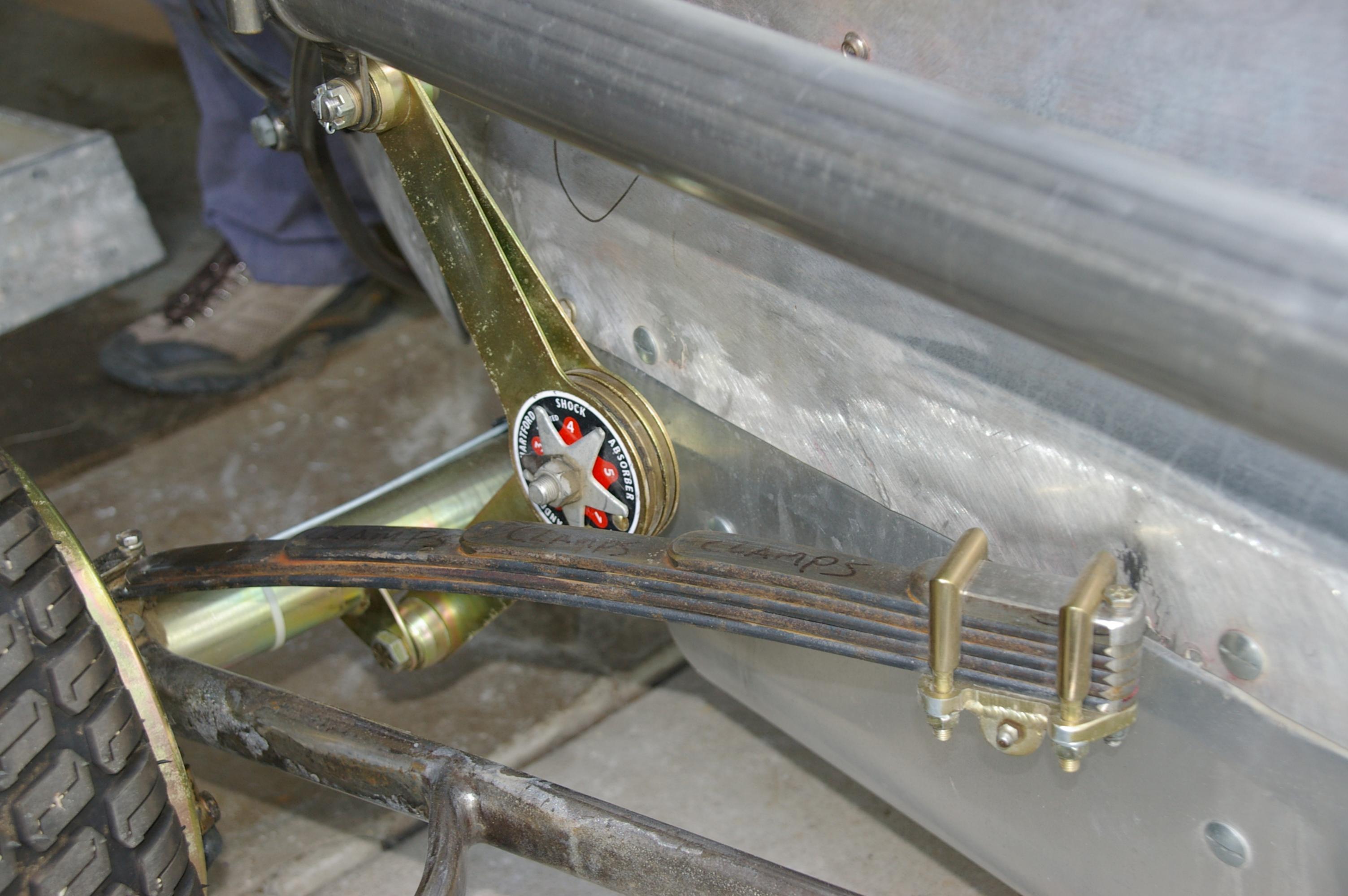

  26. These are the ones I made for my roadster..This is not a very good view ,but I use two discs of UHMW .. I made up a little bracket and used a roll-pin to keep the outer part from rotating.I use a flat-wound die spring for clamping force... I know friction dampers are not the same as a hydraulic shock absorber, but these seem to control my frt end very well...and they fit the look I was after...
