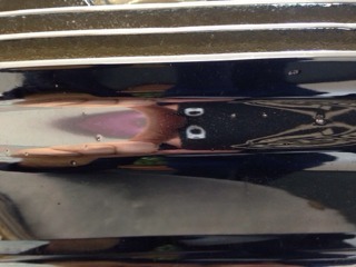

  18. Chevydeuce
    Joined: Apr 20, 2006
    Posts: 136
    Chevydeuce
    I bought a set of "NOS" "moon" covers for a 371 Olds.
    Don't know if there are any other finned no name covers around so I asume they are Moon.
    The casting looks terrible. Lots of little"holes" from poor casting quality.
    Are they all like this?
    Is Offenhauser the same quality?
    I didn't try them on yet, so don't know how they fit and if they do their job

  22. Rem
    Joined: Mar 6, 2006
    Posts: 1,256
    Rem
    I don't know about Offy ones, but casting pinholes are a fact of life with sand cast aluminium parts. If by "NOS" you mean they're vintage then it just adds to the feeling of history - a couple of guys in a small foundry turning out speed equipment for a burgeoning industry :)
