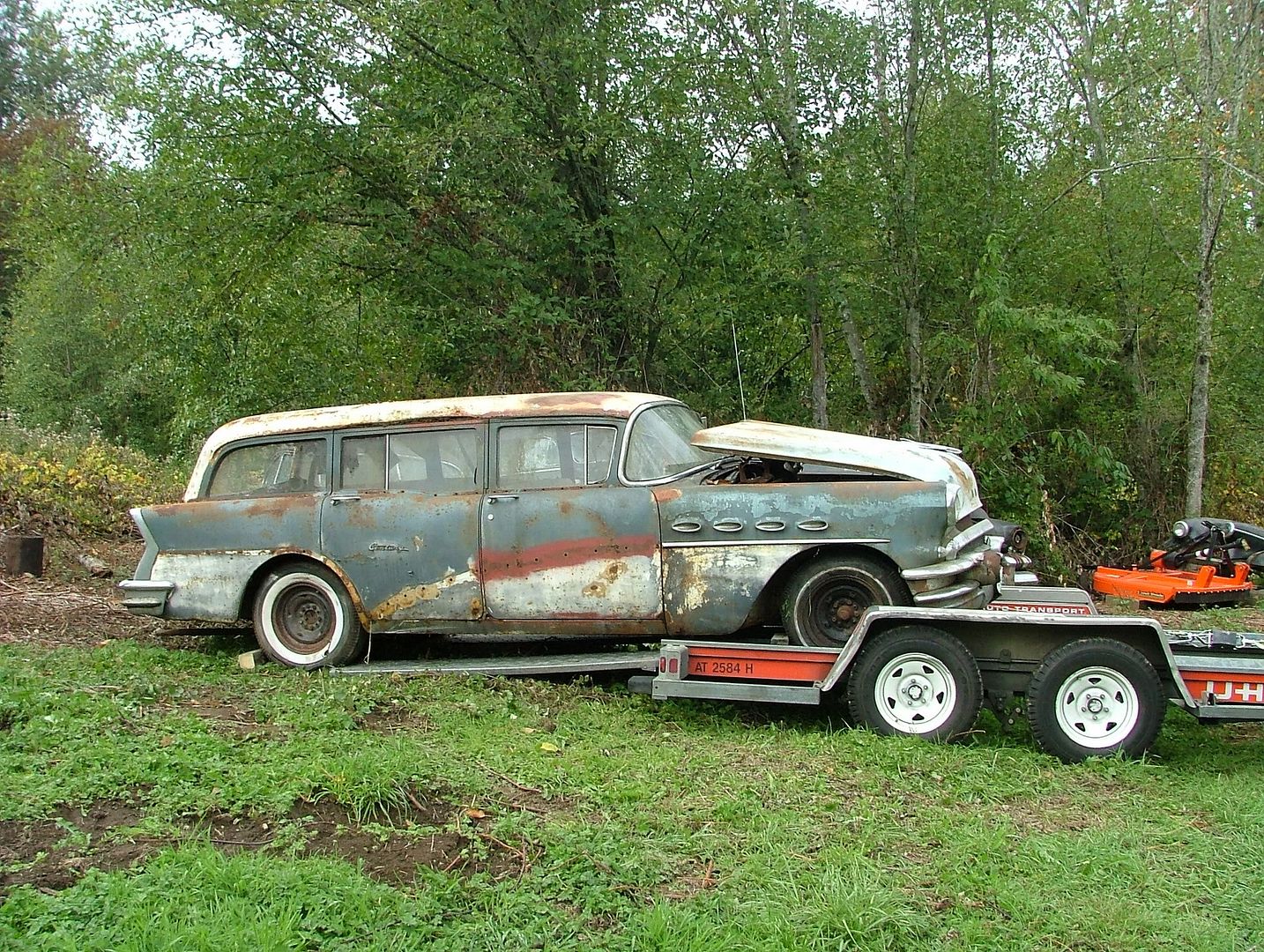

    I've made a couple posts about cars I've been looking it. Well its finally happened. I bought my first car. I probably made a common rookie mistake by biting off more than I can chew. But so far so good. I drove 500 miles round trip with only me and a good friend to get this car (I'm 17, he is 18). Neither of us have ever done any major work on a car or even loaded one onto a trailer. We got up at 6:30, drove to Uhaul in a 1993 Isuzu Trooper borrowed from another one of my friends and picked up a trailer, then we were off. It took us a little over 4 hours to drive up. Using a come along we were able to fairly uneventfully pull it onto the trailer. It took awhile but getting it on the trailer was fairly easy even though one of the tires was flat.
    The place I got it is a piece of land a couple bought that was covered in stuff. They said it had 27 cars on it that they knew of when they bought it. They still had two Mercs, 1 2d and 1 4d, an old Dodge truck, bits of 20's sedan, and some other pickups. There was also a huge pile of metal, In it I could see a couple motors and transmissions, fenders, hoods, bumpers, some old dirt bikes, and even what looked like a whole car, all I could see was a bit of a fender and what could have been a roof line. They are slowly chipping away at the pile and said they would call me if they found any Model A's or the like. They also had a lot of other cool stuff laying around, a huge tractor, what looked to be a very large old winch, a very large Lincoln welder/generator.
    Anyways back to the car... We drove back down without a problem. We got home at 8:30 and were beat so we just went straight to bed. The next morning I got up and with the help of my mom, dad, a tree, and some rope we pulled the car off the trailer. We Basically just tired a rope to the car and a tree, then pulled the trailer and out from under the car. It actually went quite smoothly. Then next day (today) I went out and got the blown tire replaced, then spent a couple hours pulling everything out of the car and cleaning it up a little.
    As for what needs to be done; the whole floor needs to be replaced, a hole in the roof needs to be patched, the gutter rail on one side needs to be replaced, the engine needs to be gone through, rebuild the carb, all the fluids need to be changed, I need to get a battery, it needs to be re-wired, the radiator needs to be looked at, the brakes need to be re-built/replaced, it needs new tires, the frame needs to be inspected/cleaned up, the suspension needs to be freshened up... and I'm sure a whole lot more too. Did I forget anything major?
    Now for some questions. Where do I need to look to know what motor/transmission I have? Should I pull the body from the frame to inspect for rust or other damage? What do you think needs to be done to get the engine running?
    Here are some pictures: http://s97.photobucket.com/albums/l222/III_3_III/Mah BUICK/
    Still a lot more questions to come!
    Thanks,
    Ryland

    Not a bad start, I actually think mine is rustier! Yours is cool, don't see very many Buick wagons thats for sure.
    I dunno where to get sheet metal around Portland, but there are some places that fab floor pans and what not for that car. Last time I checked eBay it seems more and more parts are becoming available for mid 50's Buicks.
    The brakes on a 56 Buick are a pain in the ass because the master cylinder was only used in 1956. Swapping anything else out isn't an easy task due to how it mounts. There are some places that will rebuilt your master; it usually runs about $350.
    Engine should be a 322 Nailhead with a Dynaflow tranny, assuming it hasn't been swapped out for anything else. Does the engine turn over? Nailheads are expensive to rebuild, but that may be the best route to take long-run. The starting system is kind of Rube Goldberg-esque, you turn the engine over by putting the key to On and pushing the accelerator all the way to the floor. I'm not sure if the vacuum switch on the carb and the other odds and ends needed to make this work are available, so it may be easier to install a normal style ignition switch. (I did).
    I've never lifted a body off a frame, but I'm pretty sure thats a major job and you may even have to weld bracing inside the body to keep it from flexing while its off the frame. Its not a bad idea to do; it just is going to require a lot of planning. And something to put the body on after you remove it.
    Anyway, I am sure some people with more knowledge than me will chime in soon enough. Good luck, and very cool project.
