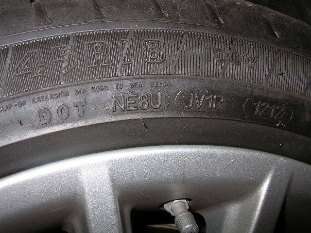

  23. Date code on a tire is the last 3 or 4 digits of the DOT number.
    This tire was built during the 12th week of 2012. The other letters and number indicate manufacturer, plant,tire size and model.
