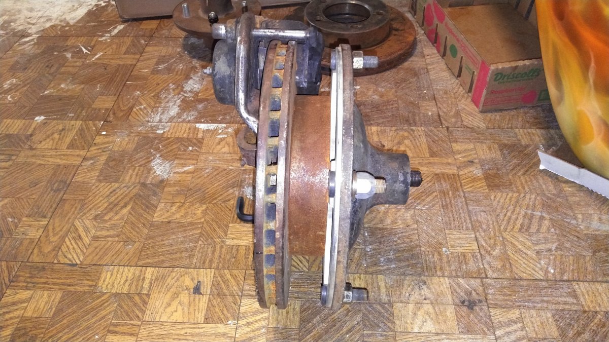

    55willys

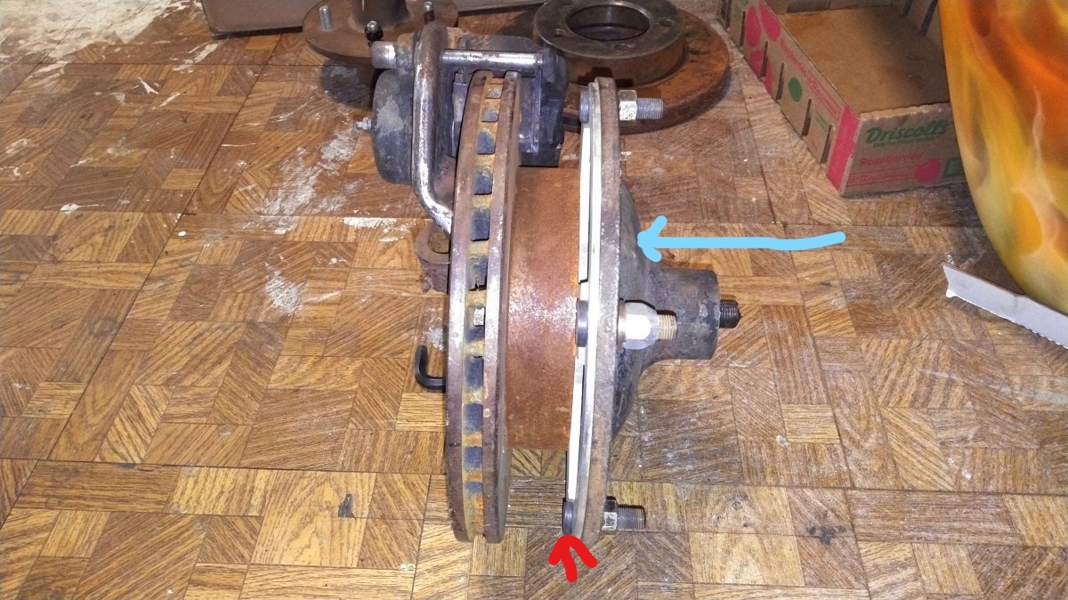

    brading
    Wonder would it be possible to machine off the drum part of the 36 hub so the hub ends up with a flat rear surface like the piece arrowed blue. Then use a 55willys rotor adapter as in POST#20 the piece arrowed red Adapter.jpg .

    55willys
    The 36 drum sits 7/8" further inboard and you will not have enough room between the rotor bolts and spindle bolts, plus it will run into the steering arm as well. You will need to use 37-40 or 41-48 spindles and 37-39 wide five two piece hub. You could possibly machine a one piece hub but I the stud hole size varied on these.

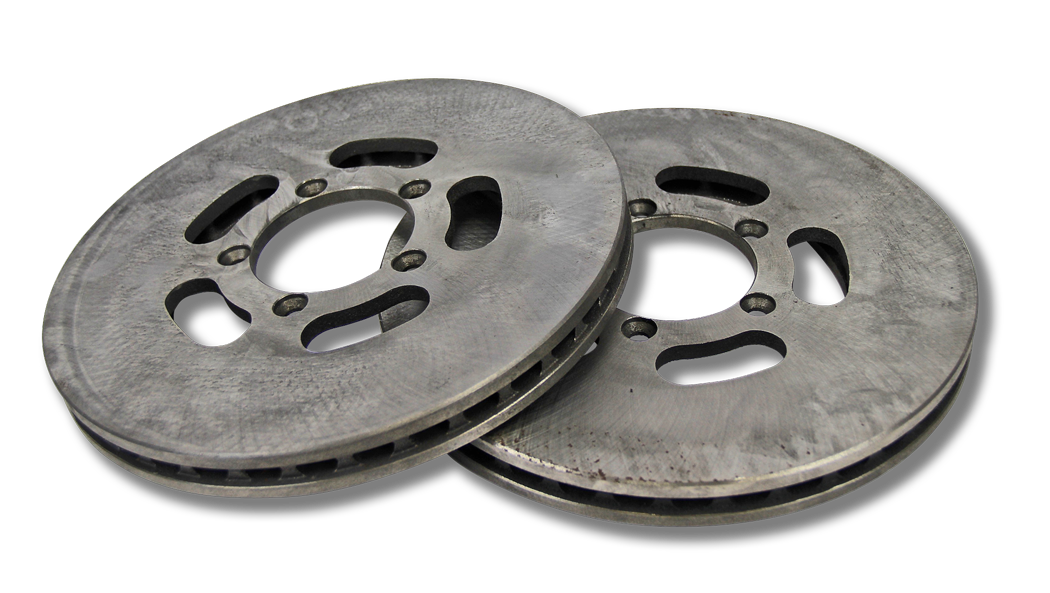

  24. @55willys , what brake disc were you using in photos above?
    We're they perhaps like these?
    Thanks.

    55willys
    I have the prototype done but haven't gone into production.

    55willys
    1994 F-150 4x4 rotors. The hat area is large enough to fit around the caliper and spindle.
