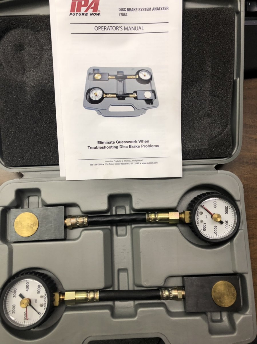

  15. The calipers slide freely on the mounts? There are force gauges that replace one of the pads to read actual caliper force during brake application as well.

  18. As I said, there are gauges for measuring output force of a caliper. Way smarter than a "destruction" test.
    Notice the line on the manual.
    Vincentnova likes this.

    Yeah i was looking at one of those..but they kind pricey...do they work with the wheel on rotor?

    Saw your reference to that but wasn't aware of such things, which being a bit of a tool whore is quite an admission. Neat. But if you have the pressure gauge and can also detect if the calipers are seized then it's kinda redundant. Still want one though, but unlikely to get one!
    Not exactly sure what's occurring in this pic though. Replace the disc? Why have two then?
