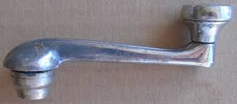

    This pic of a '48 Cadillac window crank says "yes", they are held on with the wire retaining clips.
