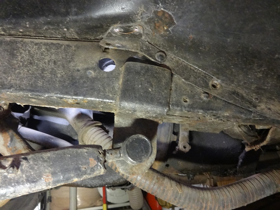

    While starting to cobble together parts for a cobbled together deuce framed roadster I came upon this all steel, all Ford, pretty much rust free '32 pick up. It had been sitting on SF Bay Area Craigslist for three weeks with no responses when I came upon it. I couldn't believe it was still there and I drove out immediately and bought it.... he even delivered it!
    It had an 8BA that the seller says he had running (no water in the oil)an Edelbrock twin carb manifold, headers, '39 trans and rear. It was an old hot rod and I want to retain the flavor with some safety and driving upgrades..... front dics brakes, unisteer, T5 trans. I'll go through the engine and check bearing clearances, etc and reseal it before trying to start it.
    I have a question..... it has a dropped axle but I don't know how much it's dropped. it measures about four and a half inches from the top of the spring boss to the top of the kingpin boss. I think it's a three inch drop but I have nothing to compare it to.
    I'm going to be cutting off that beautiful shock mount (?) I don't think there's a front side of the axle..... I'm hoping I can cut it and grind it down and make it look decent but then spin the axle around so that's in the back. Is there a problem with that?
    Thanks!

  5. the guy who welded on that shock mount must have heard that old saying " if you can not weld good weld a lot"
    yes, you can turn the axle around

  7. Ray Charles welded that up!!

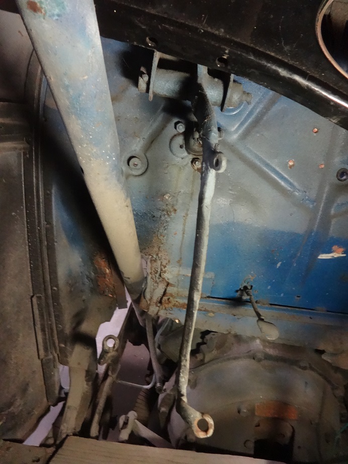

    Thought I'd post some 'before ' pics for your entertainment and cringing. My comments would be 'why use one clamp when three will work' and 'I wouldn't trust that brake pedal!'
    You can see there is no rust at all with the exception of surface here and there. Makes the work worth it.

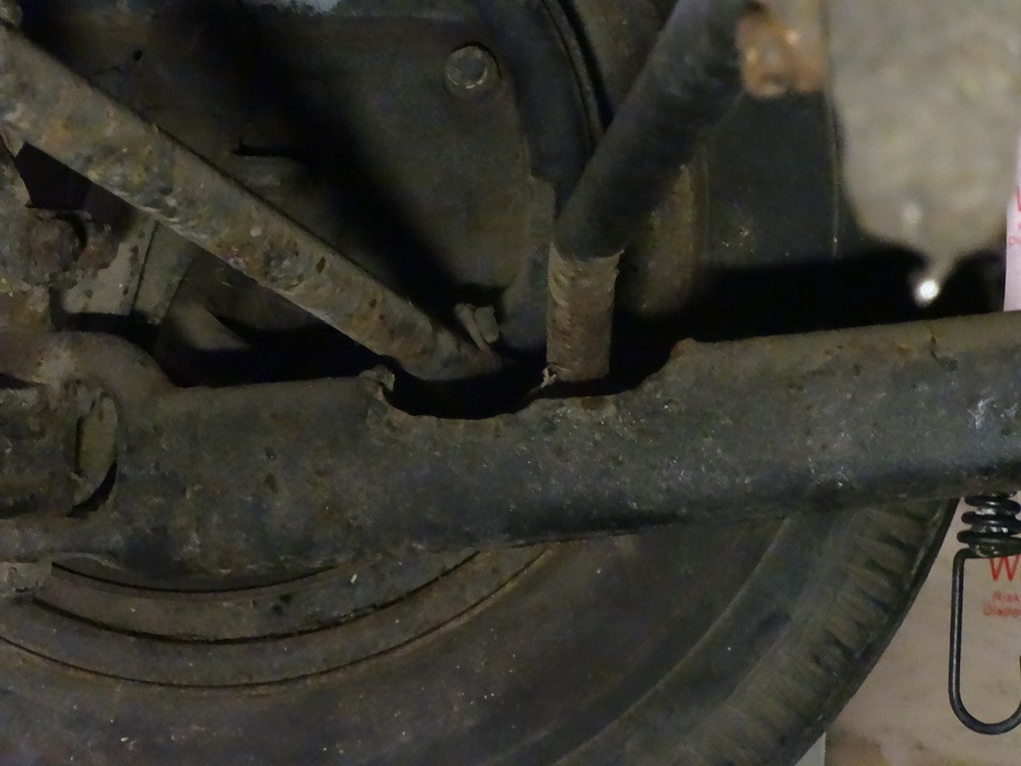

    Yikes. That front wishbone needs some fixing up front and proper bungs welded in the rear. It also kinda looks like the spindles steering arms were maybe cut off and rewelded with the same care as the shock mount. The brake pedal set up is unique. Ive never seen a below floor mount stuck up on the firewall. Im sure the arm was torchered to make it work. All things that need some rethinking.
