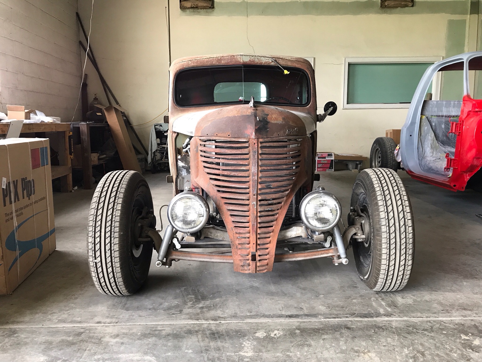

    Are you talking about the truck in your avatar? Looks like you have a lot of engine setback. That takes quite a bit of weight off the suspension. Show some pics of your suspension set up. Things are better with pics. What kind of shocks are you running, are they bottoming out? Can you make it bottom out by standing on the frame and bouncing it? If you can try it with shocks off.

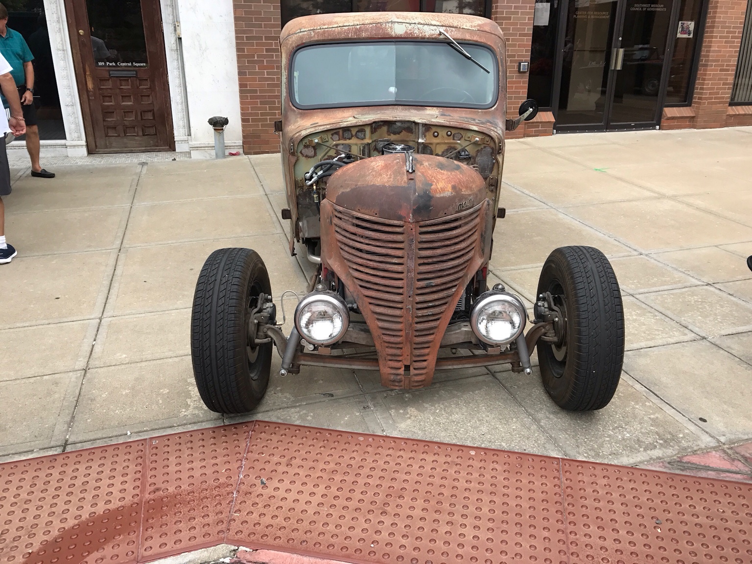

    Thanks for the advice ! It is currently apart, but it's made like this...the spring is on top of the axle (superbell) the radiator is just aft of the spring crossmember, the fan is within about 1-1 1/4" of the radiator. So yes, there is some engine set back. I may put it back together and try what you said. Will the shocks bottoming make it feel SOLID over every bump ???[​IMG][​IMG][​IMG]

    I am not an expert on those suspensions. Many others on here are. It looks like your frame is hitting the frame on compression. The middle pic is with the engine in the truck? I am guessing the spring is too long. Others should be able to give you better advice.

    Thanks for looking. The top 2 pics are the truck as it is now, running, driving. The last (bottom) pic is with engine, trans, etc, but no brake lines, intake, carbs, etc. Not finished. At rest there is maybe 5/8" clearance between top of spring and bottom of frame. I figure I may have to notch the frame for clearance. Anyone know how much clearance is needed ? Minimum 1-1 1/2" at rest ? I'm no engineer, and this is the first hot rod from scratch for me. Thanks to all that have responded !

    Your spring shackles should be at a 45 degree angle and yours appear to be almost 90 degrees in the second picture. Usually that occurs because of a worn out spring or one that is too long. Either of these will cause it to bottom out. I have a similar set-up with a 241, which is a little lighter and I don't have this problem.
