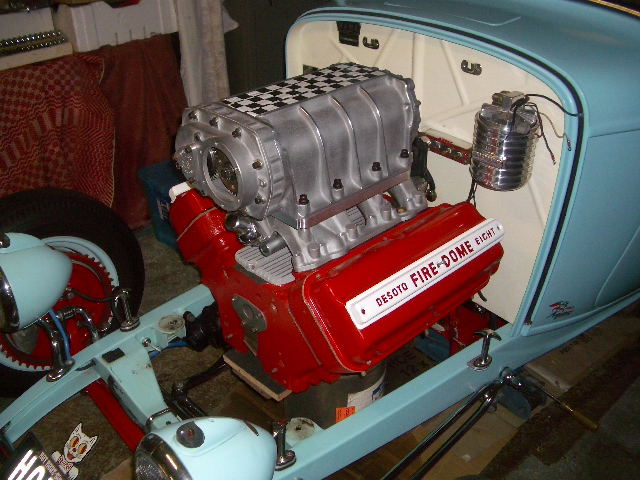

    more info on your intake?

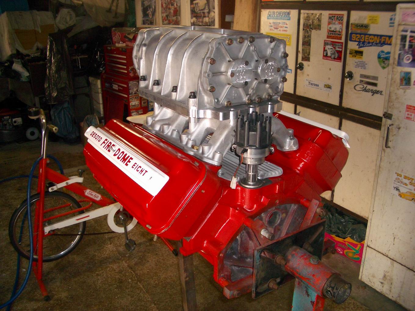

  16. Gullwing
    Joined: May 16, 2007
    Posts: 29
    Gullwing

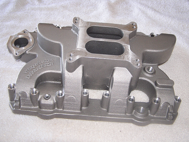

    I just got this casting back from the foundry. I still need to have it machined. It will mount Weber or Del Orto to tall deck Desoto (330-341-345). I still need to make the core boxes for the slightly smaller low deck Desoto (276-291). I included a boss to machine for Bosch fuel injector and of course it would be easy to tap for nitrous system.

    I am so glad I stumbled on this thread. I have been looking for a manifold to run 4-2 barrels on a 330. How much do you plan on selling them for?

    For me these were a labor of love. No way I can make any money doing this even if I don't factor in the time I spent making molds. I figure I will make an extra set of castings and list them on e-bay the reserve price being $400 which is what the foundry is charging me. If there is
    enough interest I will cast a few more sets or make the core boxes to cast the smaller 276-291 heads.

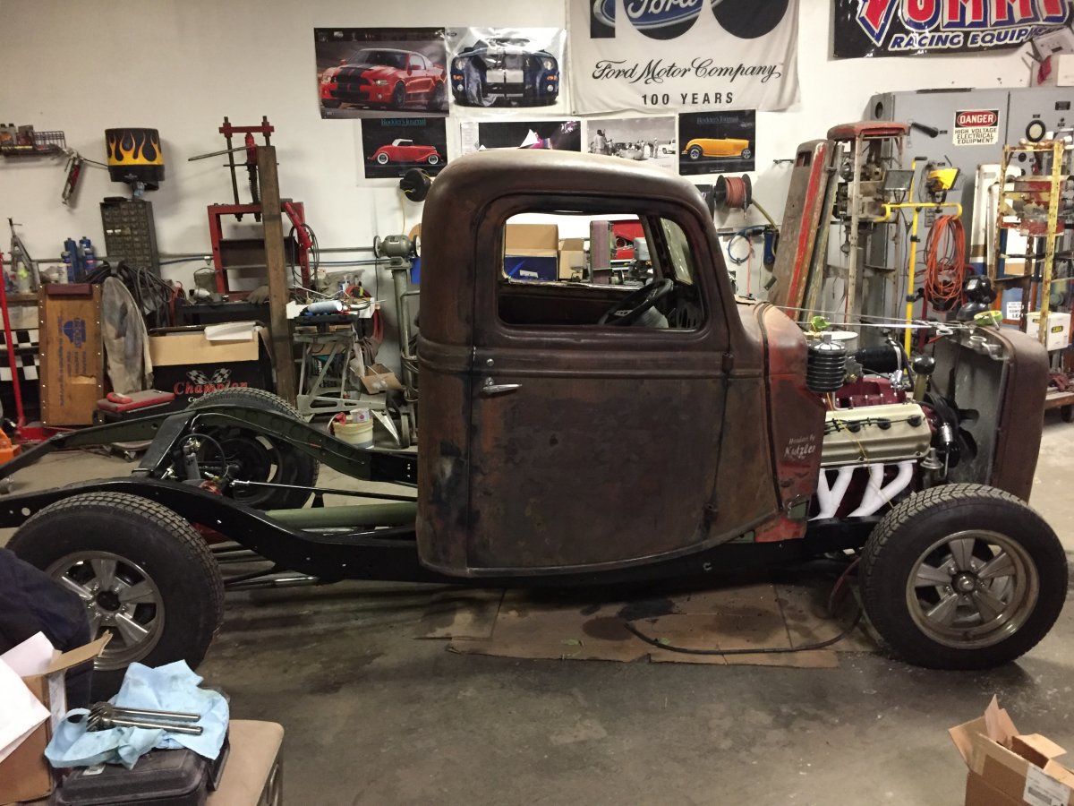

    I built this car years ago. The motors look cool, and parts are expensive. This one had stock compression. It seems to me high compression pistons were around $800.00 at the time. I always regretted not buying the pistons. .jpg

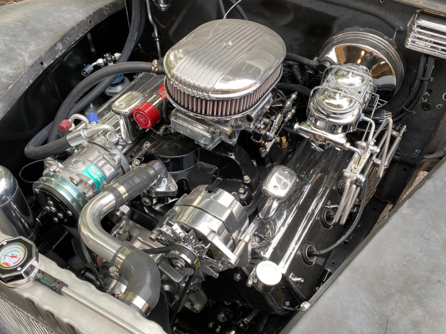

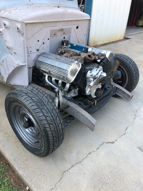

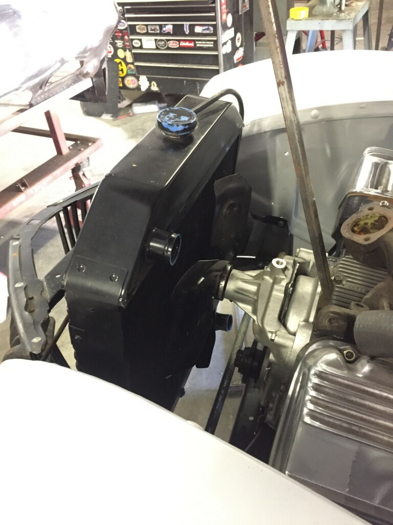

  25. Being smaller than a Chrysler, it fits nicely without firewall mods in my pickup (and Bandit Billy’s), thanks to Hot Heads front cover and SBC water pump.

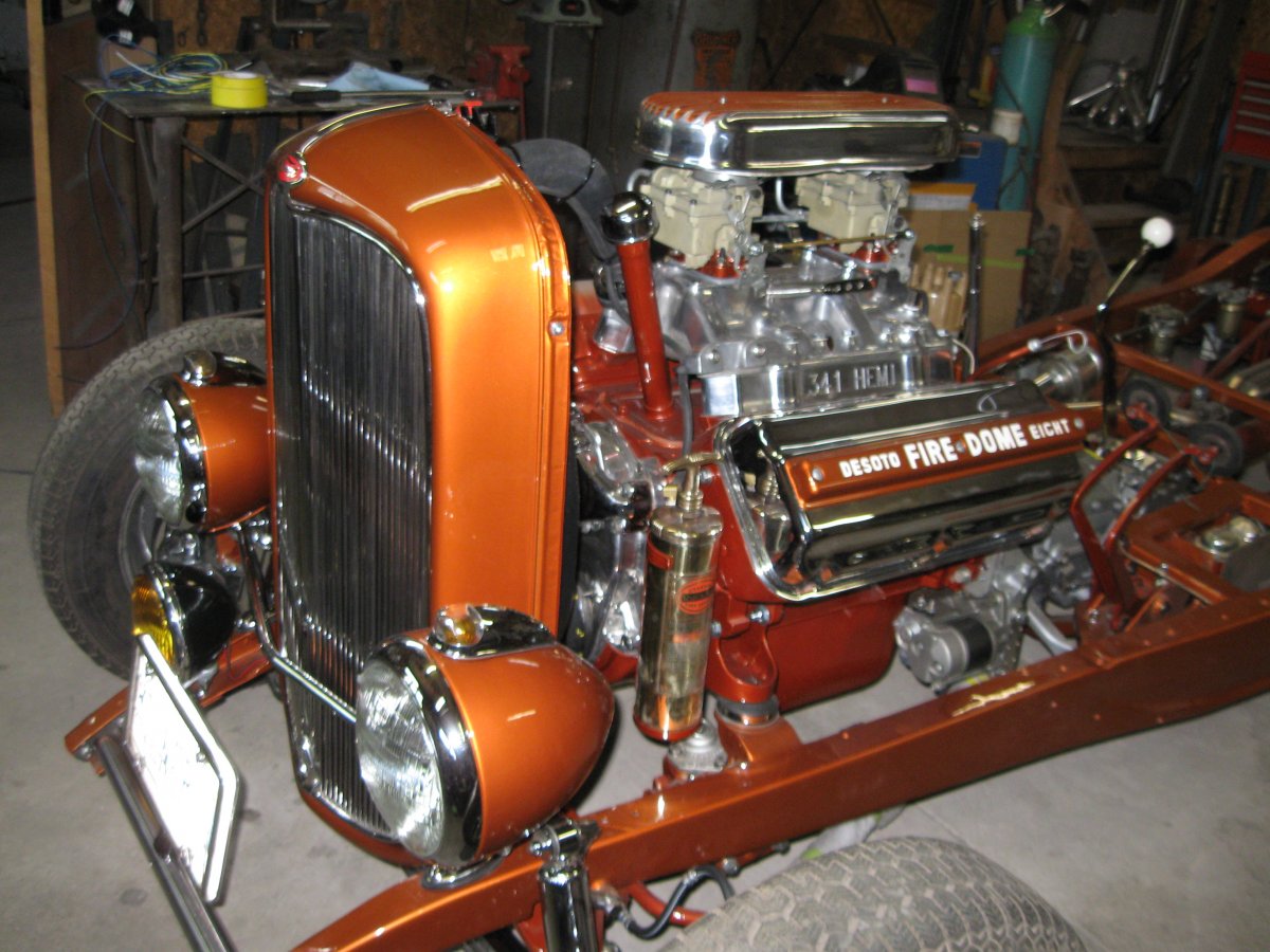

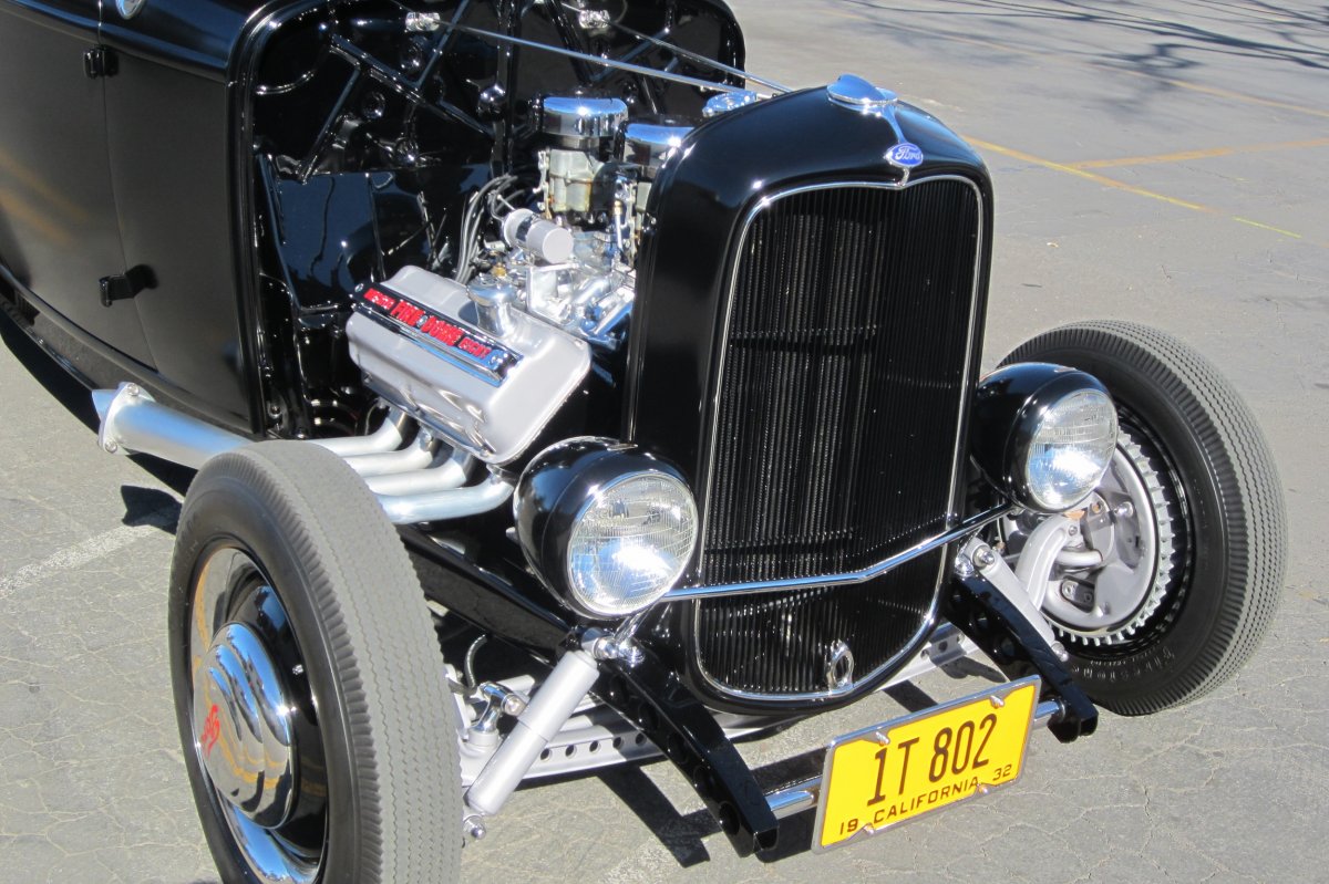

    My steel '32 with 341" Desoto and the OD version of the A833 4 speed. Works great.

    What sort of adaptor do you have to fit the 833 trans?

    Nice 32 Fargo36, what is that dual carb intake on your tall deck Desoto?

    Any adapter that mounts the Mopar A-LA bellhousing....
    There are some variations with regards to front bearing retainer diameter so not all bells and trans mate directly. Additionally, there are two different flywheel diameters that dictate which bell......
    Plenty of details on my web page: Flywheel | Quality Engineered Components
