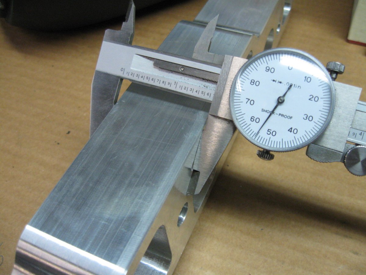

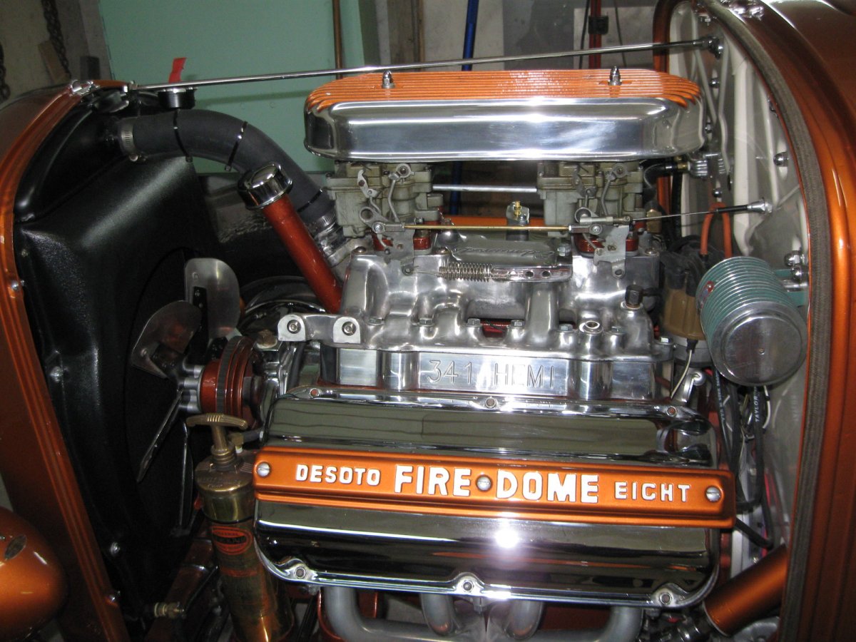

    In answer to hotrodA's question ( if you still want to know about intake spacer thickness) I had some spacers machined up to adapt a low deck Desoto Edmunds 2-2 intake to the 341" tall deck for my '32. After a careful mock-up, and using 2 sets of "Best" brand name gaskets, the spacer thickness worked out to 1.655". I drew these up on Autocad and the machine shop converted the drawing to a cad-cam program to run the milling machine. They came out VERY nice. I used a set on my car. (see photos) I have about 1500 trouble free miles on it. No port matching was required. An added advantage is that with the extra intake height; to change a bad lifter, with thin arms I was able to remove the valley cover, withdraw it, change lifter and reinstall cover without removing the intake or draining the coolant.
    Note- contrary to DE SOTO's opinion, there are NO angles to machine on the spacers, the top and bottom are parallel. Hope this helps.
    I had a dozen extra sets made up at the time ( about 10 years ago? )and still have one or two pair if anyone is interested. The last ones sold for $175. US plus shipping.
    I have attached photos of my installation .... Again, I hope this helps. Don Harrington, Ontario, Canada IMG_0081.JPG IMG_5225.JPG IMG_5224.JPG IMG_5229.JPG IMG_5226.JPG
