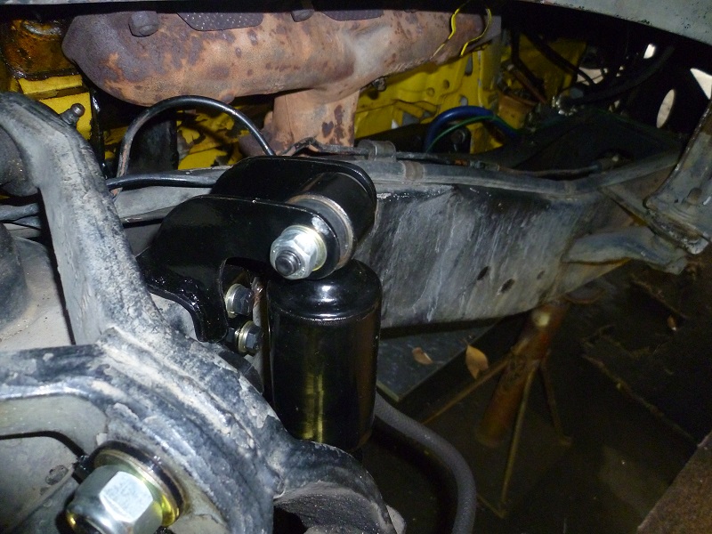

  8. After owning my car since 1971 I decided to update the front shocks, the car, an Oz 1940 Dodge uses Moog cast steel 41-56 upper A arms, stock 1940 lower A arms, 1940 spindle, 1941-56 stub axle, original 1940 shape 1" thick sway bar and heim joints and relocated upper shock mount.......the upper mounts were made of 3/16th plate and bolt to the frame, shocks used were Munro with a 8.5" compressed length and 13" extended length with these numbers stamped into them, 1009 and PK14HA........the car also uses 1955/56 Ford coil springs with 1 coil removed.........the car has a 318 poly & Cast iron Torqueflite so has a little bit extra weight but the shock relocation seems to be o/k........apart from the shock relocation the front end has been like this since the mid 70's............I had these shocks and we, a mate & me decided to try and use them..............the commercially available shock kits use Chev pickup truck front shocks from what I understand as these kits locate the upper shock mount much higher than what we did.............I have attached a couple of pics to give you an idea of the setup.........if you want any more info let me know......Andy Douglas.

    Chrysler had a different idea back then. Their Oiriflow shocks were state of the art, adjusted themselves for smooth or rough roads, and worked well to give a soft ride which is what they were after. The shocks work in and out much less than on conventional setups. Have seen TV commercials for DeSoto of about 1951 or 52 and you can see the front end slowly bouncing up and down like a baby buggy.
    If you want a more modern ride and handling relocate the upper mount to the frame and use modern gas shocks.
