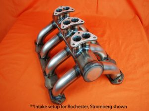

  11. RichFox
    Joined: Dec 3, 2006
    Posts: 9,724
    RichFox
    You could do this. Pretty traditional parts. and some uniqueness 28951043_10211552843287333_2268445264383574016_n.jpg to.

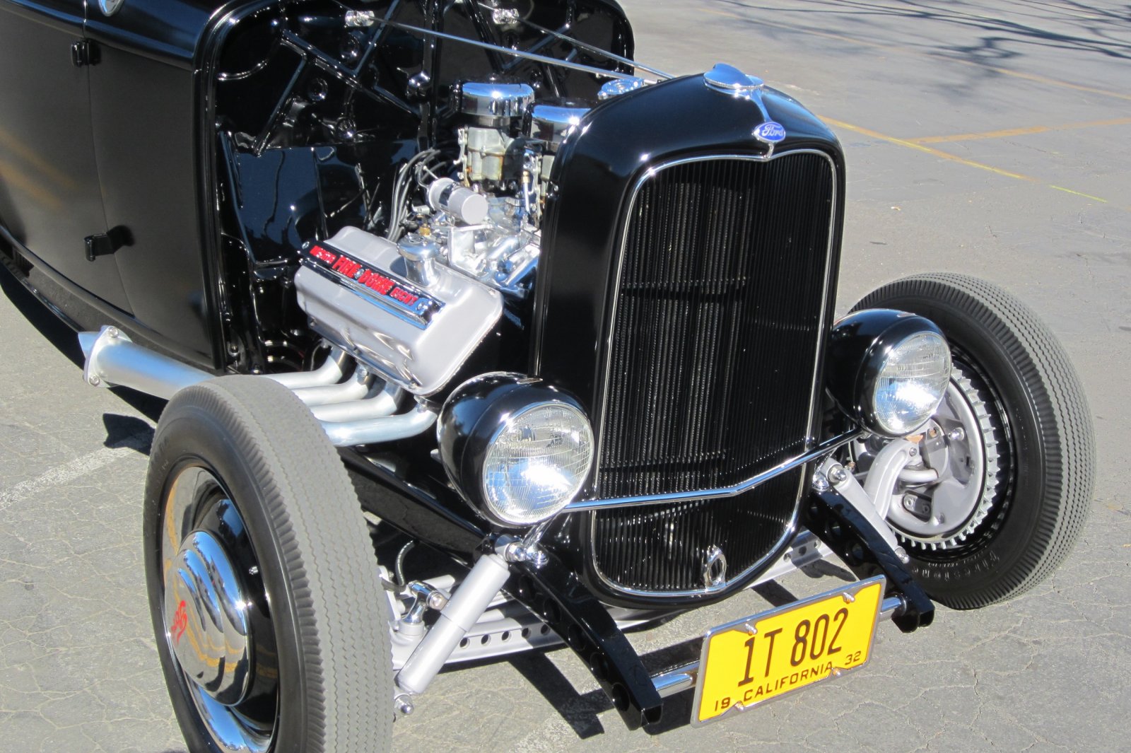

  13. Hombre
    Joined: Aug 22, 2008
    Posts: 821
    Hombre
    Not a problem to run a short deck manifold on a tall deck motor, On the motor pictured a 330 tall deck Desoto I made the spacers to run a short deck manifold in just a day with a die grinder and some aluminum plate. It will take a little time and a little work but it works just fine.
