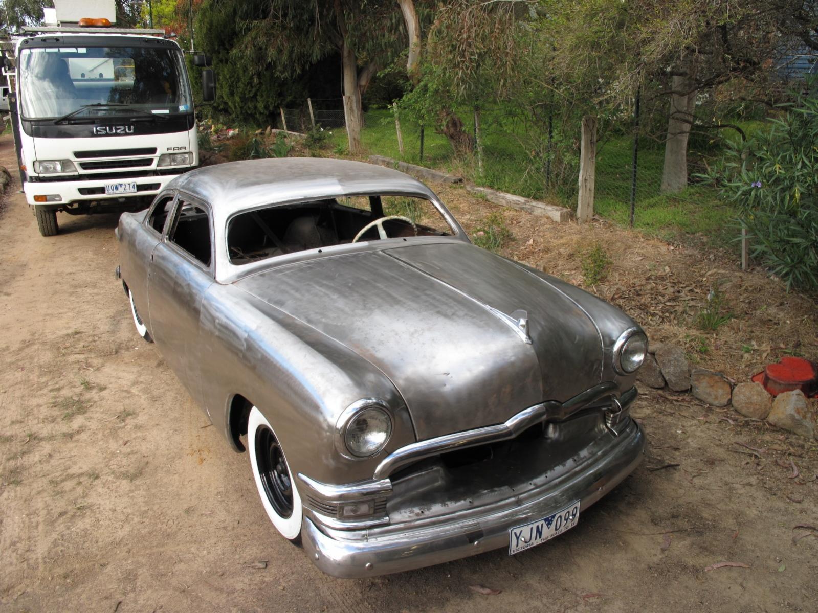

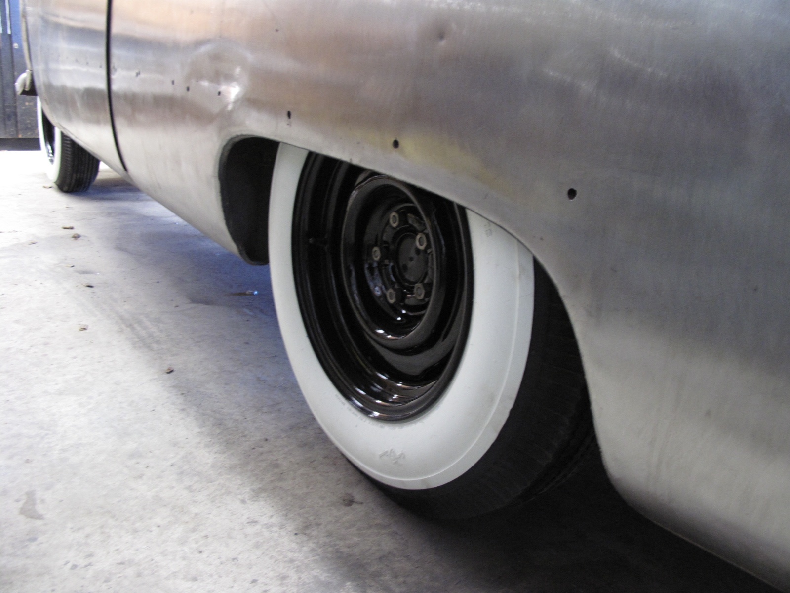

  2. been busy this week in the shed everynight with chicken, gettin a bit done,
    the pics show it, but, picked up tyres, picked up all the sandblasted stuff, wheels and what not, got all 3 carbs polished and rebuilt, have smaller jets on the way, timing case cover polished and back on, new seals, dizzy polished, door frames all tackd up and tweaked, fully welded the a pillars and grinded back welds ready for lead, re-assemlbed front clip.
    also, did some measurements, went to the wreckers and got xe falcon springs to go in it, fit nice, drop spindles turned up ill see how it sits forst back on the ground, put in other b pillar corner peice, ahron came round and tapped up my fuel filler panel and finished that with the body file, looks micky mouse, alot of shit happening lately, long nights, check out the pics, still waiting on gearbox parts in the mail to put that back together to put engine back in a make a start, bought fuel pump and reg, fuel block, red fuel hose, chrome nuts coer set for heads and intake, everything i need i pretty much have i just cant buy time, goin to organise the front screen tomorrow, get that fitted then take it out till a couple days before chopped.
    primed, sanded and gloss 2pac blacked the rims, they came up nice, tyres fitted tomorrow and back on its wheels so we'll see how we go.
    cheers
    des

  4. pics, internet was being stupid, good news though, wheels and tyres back on, gearbox out back together the other night with a bit of stuffing around and some help from the good ol chicken man we had it backtogether orking all sealed up and now in primer, ripped a sick dayt today cause i wante to stay home and get the gearbox painted this morning and sit in the sun all day and bolt it uo to my flatty to out in the car, will post more pics shortly im a bit behind on the pics.

  19. just a quick little update before i hit the cot for the night, nothig big, only the engine in ha ha ha,
    this made me happy to see it all done with a freshly sprayed gearbox.
    pics show it all, but i pulled chicken away from the olds the other night to give me hand to guide that baby in,
    engine and box in with my new clutch and re done pressure plate,
    all shifter linkages hooked up, clutch linkage hooked up. all mounted in, tail shaft back in, hand brake cable hooked up, now it gets exciting cause she aint far off running, just waiting on the right size jets for my 97's which should be monday, hook up the exhasut tomorrow, gotta weld flanges on the headers and the exhasut and paint it all up. started the drop spindles tonight, just gotta get some grease in the morning, the extremely easy and come with instructions from fatman but i took some pics to show how to do it step by step in case theres any guys out there reading this and want a bit on info on doing them, ill have em back in and back on the firestones before lunch, this weekend should be rediculously good for progress,
    glass fitted this tuesday, and my good buddy from the club paul librio is coming over tuesday night to measure up and cut the front stainless, seeing as hes a master on the tig welding he can do it and ill do all the filing and polishing so that should be done for chopped to, lucky i have some talented mates when it gets too much for me.
    cheers all, have a great weekend and check this space sunday night.
    des

  28. just a few pics,
    got the drop spindles finished, the steering arms on both side the bolt holes didnt line up to the backing plate so had to file them out a bit but all in all a great kit.
    rolled the car out sat morning once i had finished them to have a good look at it cause it hasnt been outside for a while and its hard to see it fully, but very happy with the profile of the car, it look even milder outside but still i think its nice at that height it was what we were always going for.
    got the door handles peices tacked in, both door window frames fully welded,
    inside and out, got the b pillars welded up, put the last little gutter peices in the roof and welded up some final holes, pushed the roof and qaurter windows round quite a bit with the port o power till ahron was happy with the flow and even on both sides, alot of fiddly shit like that to make both sides right, and look nice, so now the roof is all fully welded up and ahron and tex finished the shrinks in the rear panel bewtween the bootlid and the rear screen so it flows nice off the boot lid and doesnt hae a budge in it,
    i got some work done on the engine area in between when ahron was here on the roof anf not, i got the wiring all cleaned u and retapped it all, put the correct sixe jets in my carbies so they should run nice, welded a flnge on to the headers and bolted them uo so there ready to have the exhaust hooked up which ill do the week, shocks back in, brakes hooked up and fluid in them, paint stripped my radiator ready for primer tomorrow night, and alot of other little shit, got a fair bit closer, but not long till chopped so i gotta step it up a notch.
