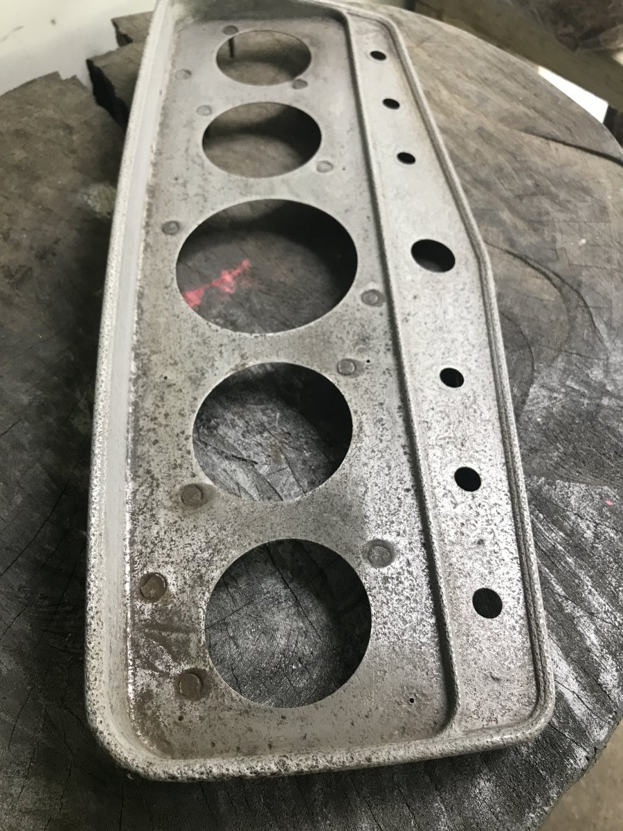

    image.jpg Any chrome shop guys on here ? What’s the best recommendations to use as a filler to fill deep pits I’m not a scared of doing the sanding and metal file work to save a buck
  2. Silver solder. But its gonna warp the hell out of that panel.

    Take it to your plater & have them clean it .
    Then take it home & file & sand it some.
    Take it back to the plater & have them just copper it ( no polishing)
    Take it home & sand it some more.
    Take it to the plater again & have them copper it again, ( still no polishing )
    Repeat with finer sand paper, until you are happy then have it polished & chromed.
    Think of the copper as the primer under a paint job.

    I would have it cleaned, copper struck, and then fill with solder. However if it too thin just have it copper struck and sand, over and over until you are satisfied. Then nickel and lastly chrome!

    As a plater of 35+ years , I would advise you to sand bog sand and paint until it looks perfect ,then get it cast again at the foundry .After polishing and plating you WILL have a perfect job .

    It’s stamped bare metal that I had soaking in vinegar type solution store bought , it is not cast,pot metal

    This may be the perfect use of the new spray on "chrome" finishes. You can use filler and primer to get it smooth, then paint it with the "chrome". Some of that stuff looks pretty darn good. It won't resist scratches like chrome but since this is an interior piece, it should hold up fine.

  20. If you want that piece to be perfect, it is going to take a LOT of copper, potentially solder and a ton of hand work to sand it back each time. Given the shape of it and the various detailed areas (like the double rolled bead at the top edge), it will take a ton of work to both fill and keep the definition details that the original had. My guess is that you'll spend a HUGE amount of time on this (and money) if you want it to come out with no pits and look like the original. Talk to some experienced chrome shops and ask about all the gory details!

    I have more time then money, that’s why I would like to accomplish the most of it my self. Not looking for award winning finish, I have laser cut inserts to hid some of it.
    Just more focused on the outer lips
    I have sold off all my other better panels, to fund other parts. And left me with worst one

    If you are going to put the inserts in the flat surfaces and just worry about the edges that takes a lot of work out of it for you and the plater. Still I'd take it to the plating shop to have the old plating removed first. plus gather their advice.
    The biggest gripe the plater I used to go to in Texas had was people that did stuff on a piece attempting to save money that he ended up having to rework to get right.
