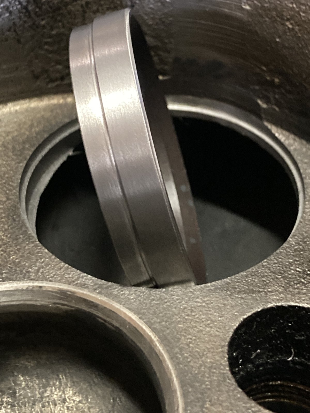

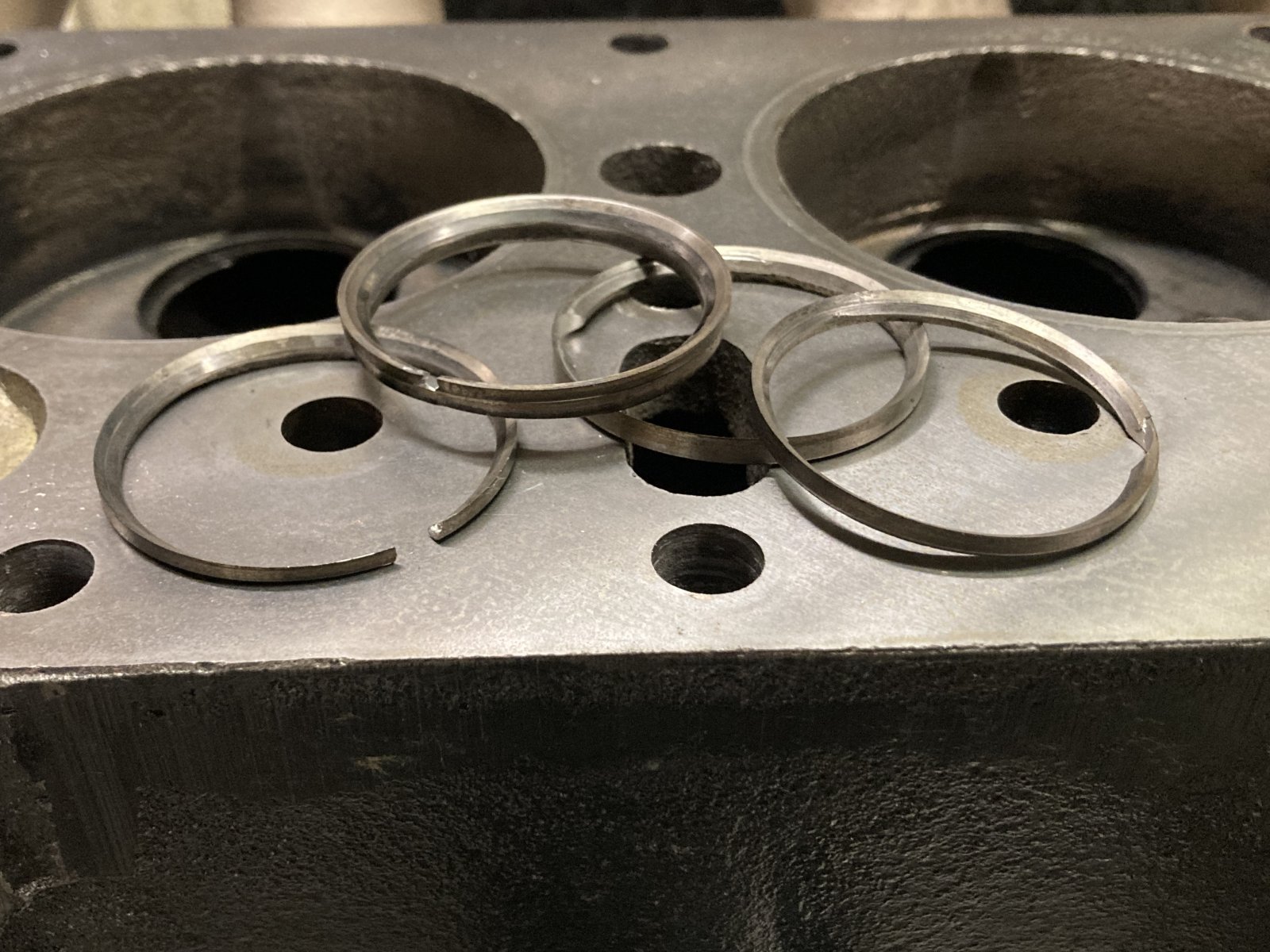

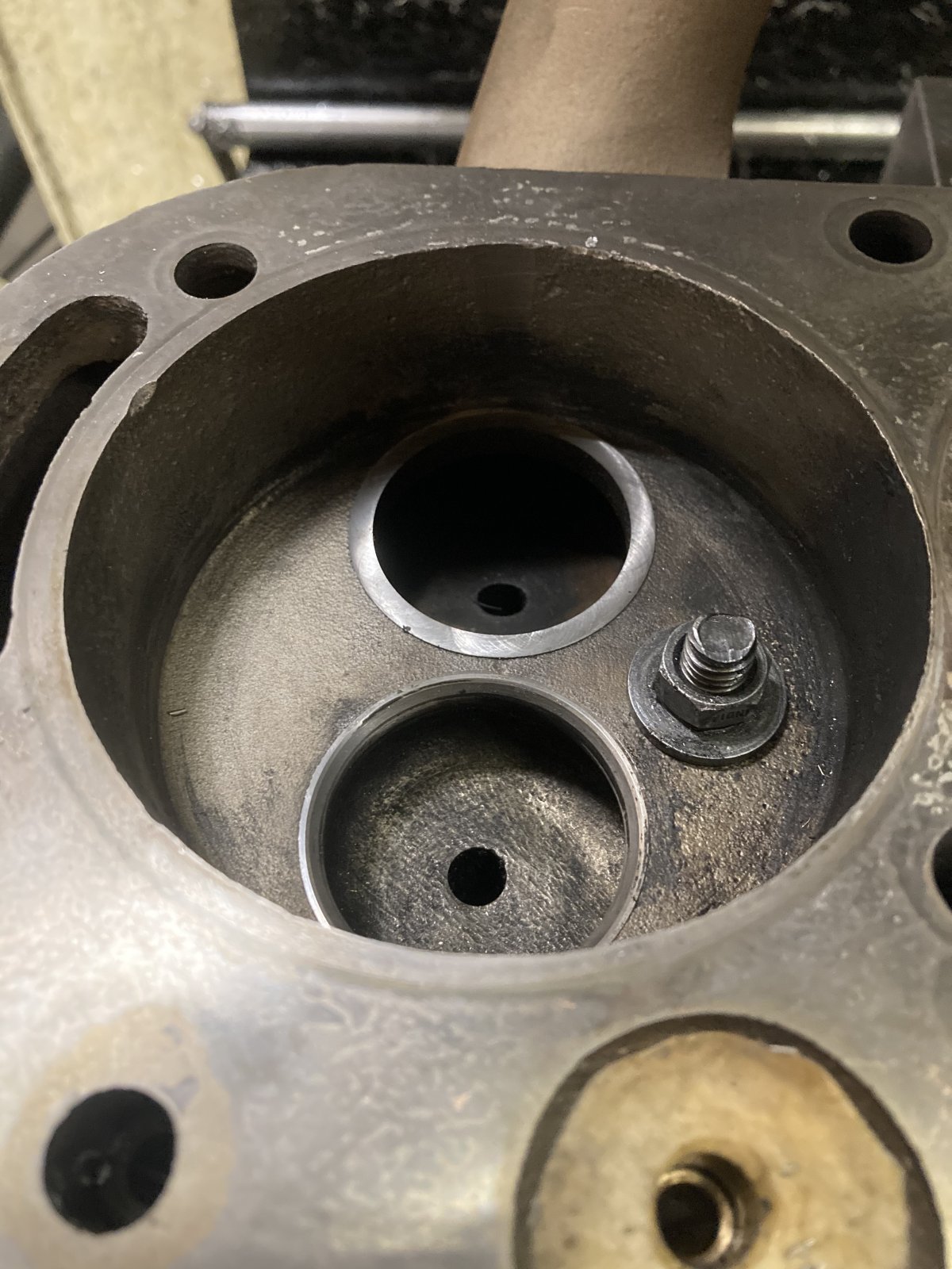

    I’m here, and with the Akron-Hed off the speedster…!:( After a steady decline in performance over the summer I found that the exhaust valve seats in cylinders 2 and 3 had settled, causing a backfire thru the carb under low rpm load. Not happy with what the machine shop did in there, so gonna pull the exhaust seats out and do em myself! Hope to have it back together this weekend:cool:

    The exhaust seats that came out of 2 and 3 were installed crooked. About 1/2 of the seat pocket has no floor surface to support the seats, and the inserts were not even touching what was there. The seat pockets are only about .15” deep, but the inserts are only about .090” thick at their thinnest point… no wonder they had settled!!! 838605B7-346B-4ADC-A83E-F379F77C131B.jpeg 757F702C-DD17-4E3D-8E47-4B9528DACC9C.jpeg

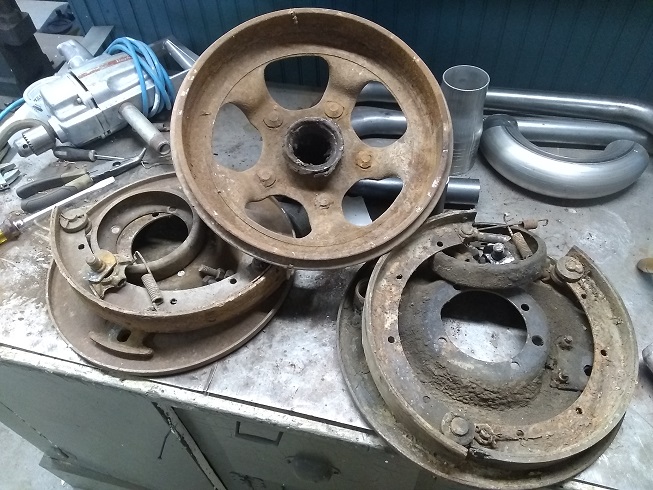

    Spent 2 hours taking these guys down this afternoon... One was easy, the other was a nightmare!
    Gotta get the new axle under the banger by X-Mas!

    You will love the upgraded braking..

  8. UGH, that is a shame
    it looks like the port is too close to the roof of the chamber, not out of the norm for early castings.
    How deep is the pocket from roof of chamber to top of the bowl/port?

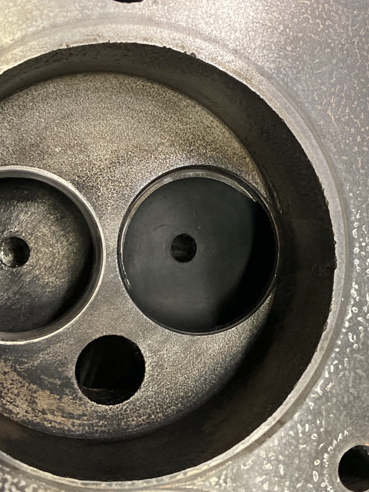

    The ports are larger diameter than the valve heads. Machining the seat pocket breaks into the port after about .150” deep. The shop that did the work originally only put 7 seats in. They chickened out on number 4 exhaust when it completely broke out into the port. At that time I machined a .100” deep counterbore above the seat pocket, and machined a stepped diameter seat to match. This seat looked great, but I cut it out due to the shop cutting the seats really low.
    New seats are made and installed!! Just a little bit of grinding and she’ll be ready to go back together
    9BAA5FC2-AE92-4DE2-AD70-3003F7EE6DEC.jpeg C29EA619-50B2-4766-8044-60349DB14CA0.jpeg

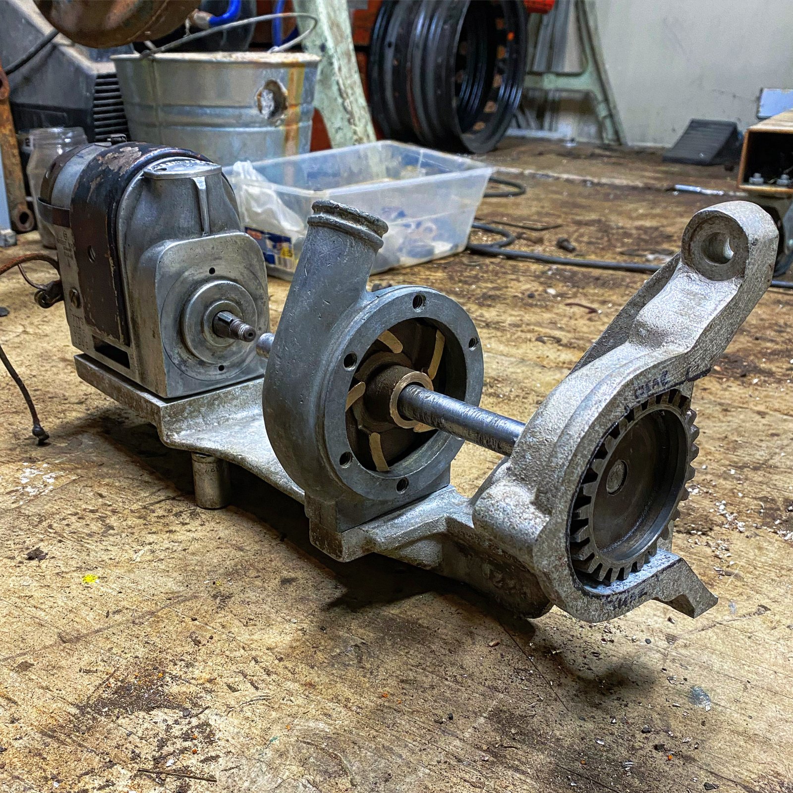

  19. I’ve made progress! Now I just need washers, packing nuts, and to figure out the impulse coupler for the magneto!

    sorry for my ignorance, but other than (i think) a Scintilla magneto, what is this driving?
    thanks
  24. drtrcrV-8
    Joined: Jan 6, 2013
    Posts: 1,749
    drtrcrV-8
    The middle thing is a water pump

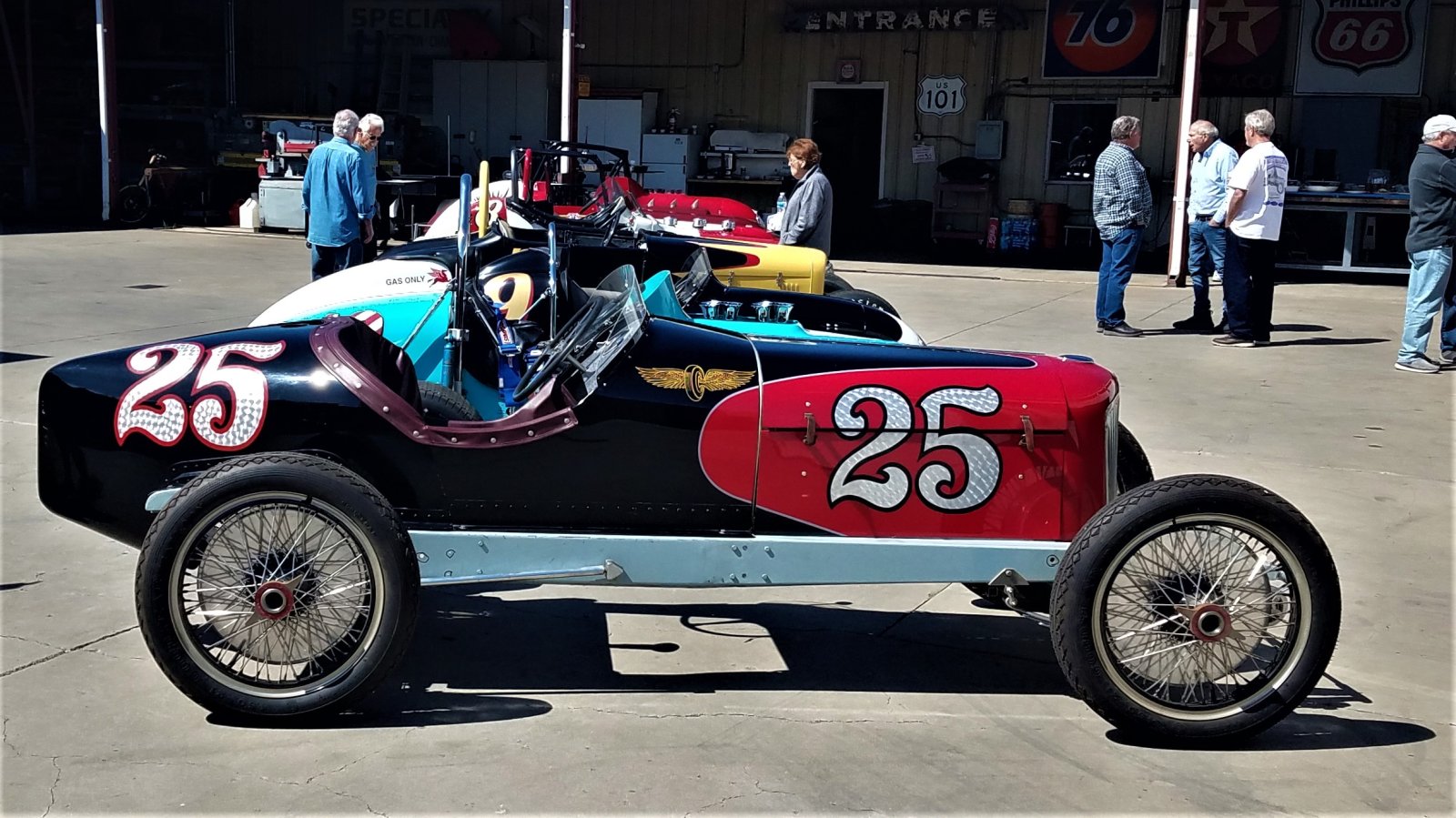

    This nifty two-man car belongs to a friend in Santa Barbara. He had Carl "Smoky" Alleman buid a "Pop" Dreyer Four- Banger to go in it!

    Looks like it was built to stop! Sure would love to find the two man car I sold to Jim Etter. Bob

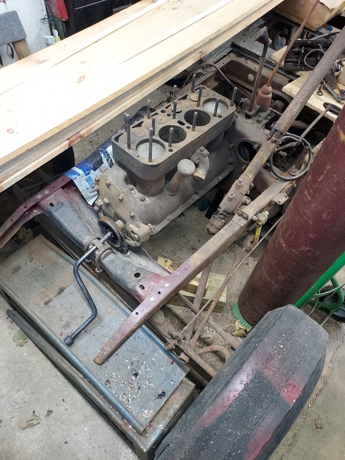

  28. wheeldog57
    Joined: Dec 6, 2013
    Posts: 3,507
    wheeldog57
    Currently in the classifieds but I am thinking nobody wants it.
    I'd like to get it running over the winter

  29. This is a Frontenac water pump, it's driven via a second crank gear hanging off the cam gear. The shaft spins the water pump, as well as a Bosche magneto!
