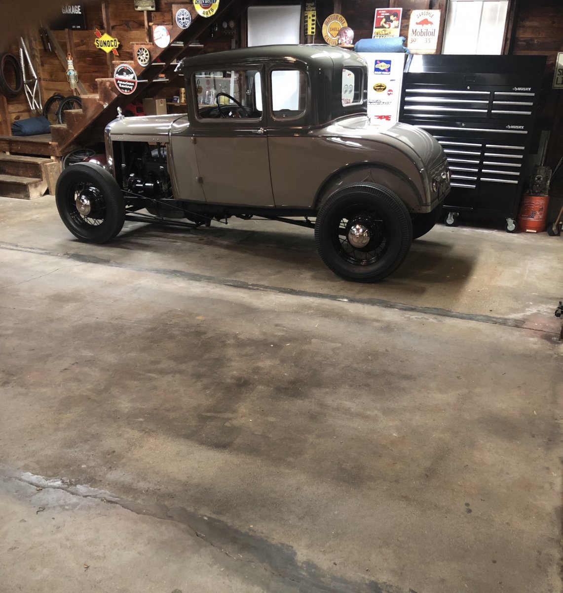

    Checking in. 3 months of having the car I’ve done 1200 miles with my heavy foot behind this thing. Pulling the banger soon.
    - Whats the going rate on a banger that has been rebuilt with insert bearings for the mains? Selling radiator to transmission. Thanks.

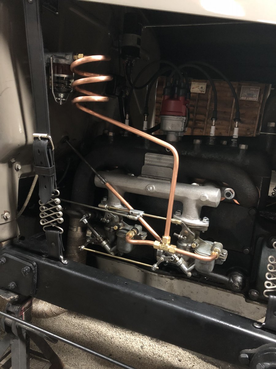

    Does anyone here run dual updraft Zenith carbs? Will they work with headers, or are the carbs in the way of the downtubes, primarily the center two?

    0E96F5EC-BC81-409D-81BC-9209632302C6.jpeg I do. You have to run stock manifold. Or make a custom header but it would be pretty tight bends to get the inner cylinders to exhaust. I run tilly X carbs though.

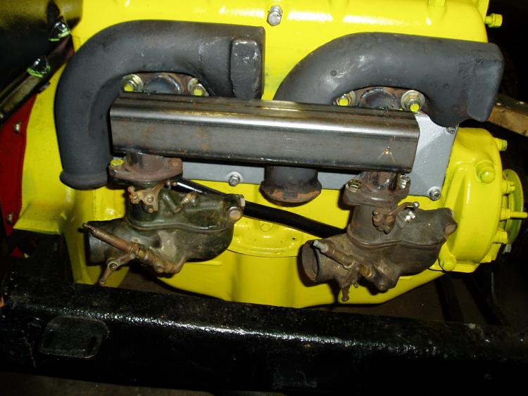

    I don’t think there’s room.
    Reds makes headers for single down draft, but probably won’t work for duals.
    Otherwise, I’d guess you could split stock headers.
    I can’t remember where I got this pic, but it was probably from the hamb.

    Thanks for the photo JT1930. I figured the center two cylinder header tubes would have to be really tight, probably so tight it would have quite a negative effect, being more visual than beneficial. Two updrafts is a good look for sure...and I think Jim Brierely spoke well of that setup in his book. I'm unfamiliar with "tilly X" carbs....I'm curious what are they off of and/or what the throttle plate diameter is compared to a stock A Zenith? Looks like the carb throat of the rear carb is really close to the exhaust. Air cleaners or maybe just some screens?
    That's a pretty simple intake you posted, walls. I think I could knock one of those out in a couple hours.

    I have screens on my carbs. Either tillotson carbs or zeniths it will be close. Unless you find a Trojan intake I saw for sale a little while ago with two zeniths on it. I believe that updraft intake is a little further out from the motor.
