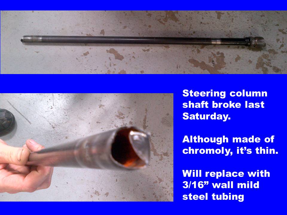

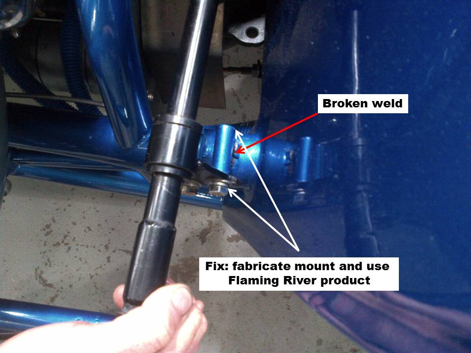

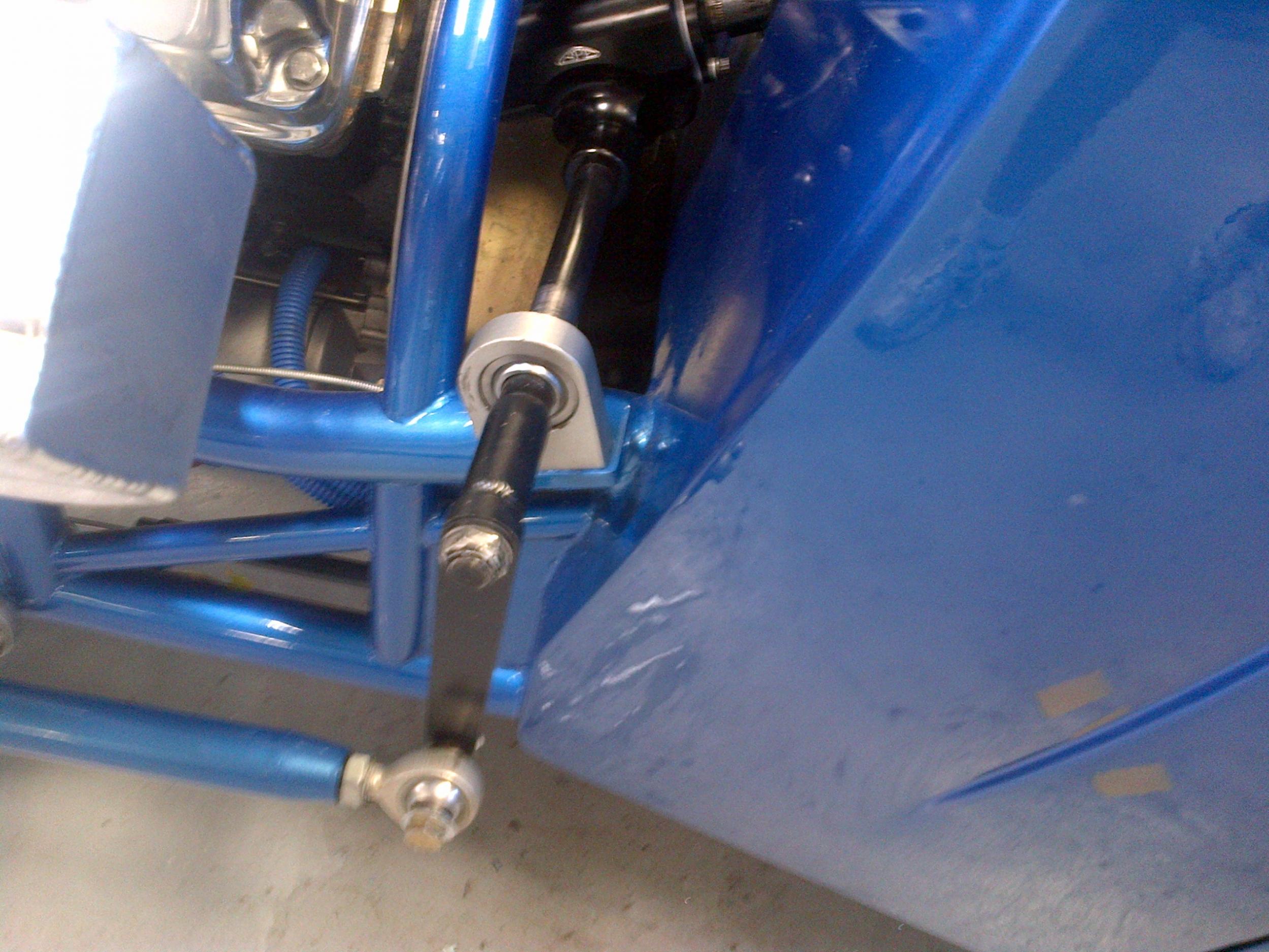

    You broke the mount and also the steering shaft.
    Looking at the distance from the tierod end of the pitman arm to the outer support bearing I see lots of potential for flex between the pitman arm and the bearing which would likely result in equal flex between the bearing and box.
    Result...a broken mount and a broken steering shaft.
    MY cure would be to redesign the steering box extension shaft to have a solid bearing directly inboard of the pitman arm and also make an additional mount that solidly secures that round output bearing housing on the steering box itself to the chassis.
    Better yet, an extension tube that press fits the output bearing part of the box, going from the box to the frame (enclosing the extension shaft itself) and beyond with an inner support bearing at the pitman arm and additional mounting to the frame to support the box itself would be perfect.
    Whatever you come up with, overbuild...don't go for pretty and light.
    ...or you could get a sprint car style box that spans the distance and takes care of everything itself.

    Not sure where to begin. One thing that jumps out at me is the engineering of the steering box itself. It looks rather spindly and more suitable to a lightweight dragster than a heavy street driven hot rod. Not dissing your work, but the gussets are very thin and that steering shaft is the longest I have ever seen, especially the portion that sticks out past the support. There is just so much room for flex in that whole shaft assembly that I can only imagine how much it can move under road conditions.
    I don't know, the whole steering setup just seems a little unorthodox to me for a street driven car. With this setup as it is I am not sure if you will ever completely solve your steering/handling issues.

    I'z an injuneer, Hacker and Don raise some real concerns!
    The loads on the outboard end of the shaft look scary! Not likely to hold up.

    I agree with Don on this one,the way the bearing is mounted you are lucky you haven't wrecked yet. That is where all the stress is and a dampener will just put more stress on it. All it would take is one pothole and it will break again. Better bearing and much stiffer mounting bracket would definitely help.

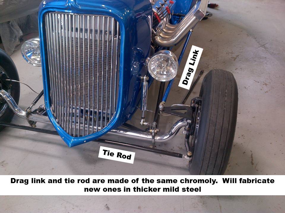

    I notice you have to have a serious case of bump steer, your four bar mounts being way ahead of the drag link, surprised nobody else saw this. Your death wobble and breakage come after hitting something with the left front tire, (pothole, manhole cover, crack in the road, etc.) causing the steering to try to turn when it can't.
    Nothing will change this, you need to lengthen the four bars, all the hinge points HAVE to be the same to avoid bump steer, reengineer your steering setup before you kill yourself or someone else. This stuff ain't about bolting parts together and hoping for the best.

    Hope you don't take this as busting your chops, but that entire front end needs reevaluated and redone. The steering is never going to be right as it is designed, and the shocks also are not contributing much to the dampening effort. I know it is always tough to redo a car once things are all painted and pretty, but I think you will be chasing problems of one sort or another forever if you don't redesign it.

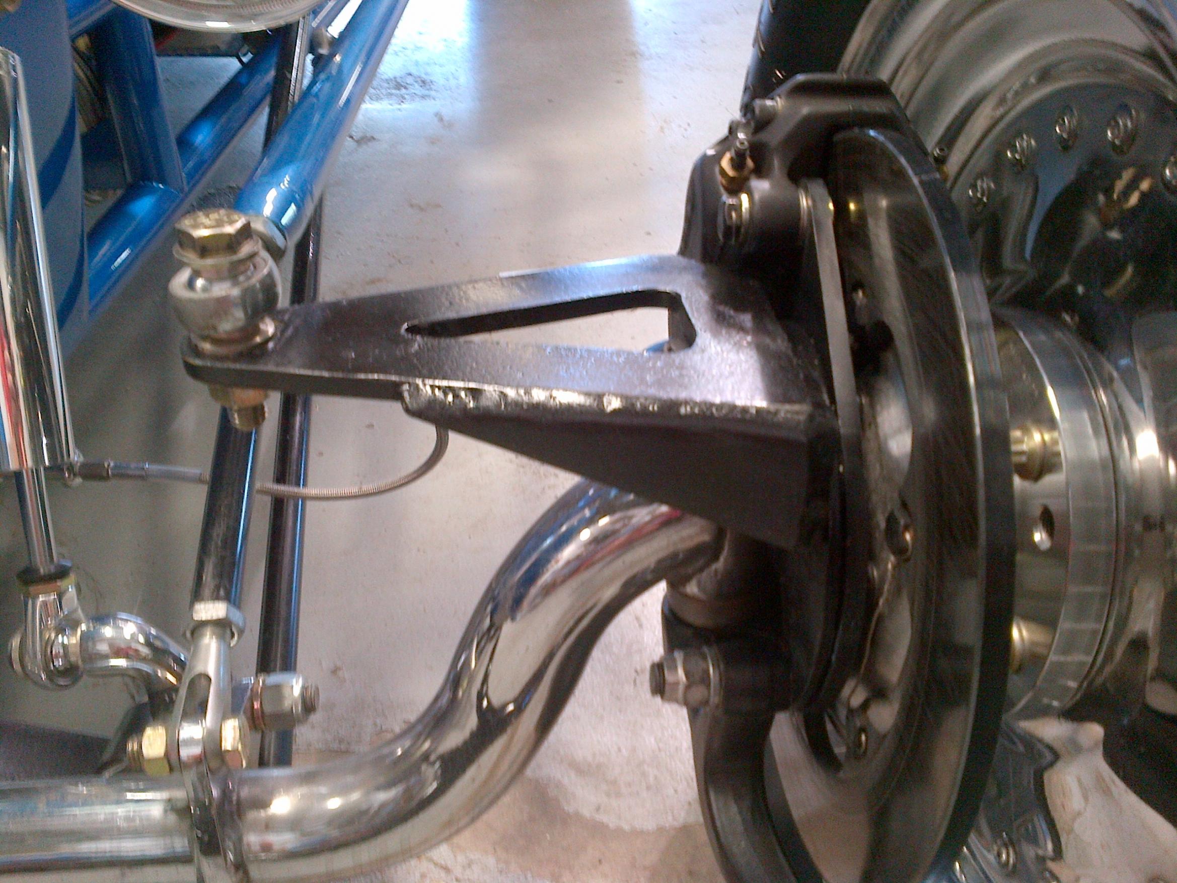

    If I am seeing things correctly in these 2 pictures, it appears that the King-pin inclination is wider at the top than at the bottom.
    [ It almost looks like the spindles and axle ends are upside-down ]
    Could you take more photos to confirm this.
    If my observations are correct you have excessive scrub radius.
    Excessive scrub radius causes a chain reaction when it hits a bump [ the poor old pitman arm hanging out on that cantilever mount is the weakest link ]
    Instead of patch-up remedies [ steering dampers etc ] try and get all the basics correct.
    You might need a new axle
    The King pin inclination should intersect at the centre of the tyre footprint ,so there is equal drag on each side of this point.
    If you have correct king pin inclination and zero caster the tyre will “fall over” when you turn the steering either direction [ positive camber ]
    Positive caster is used to counteract the positive camber on the outside tyre [ less steering angle requires less + caster ]
    Note I am referring to steering angle at road speeds , the excessive steering lock in supermarket car parks is not detrimental to handling [ unless you autocross ]

    F&J
    Good eye to catch that view of the KPI. I suppose it could be camera effects, but it sure does look really bad.
    And yes, scrub can trigger low speed D.W. I experienced that over 40 years ago when I put wrong offset mags on a 50s built rod. I have been reading about wobble ever since. Note I said "trigger", not "cause". I still think there are many different combinations that "cause" it, and it seems adding just one more iffy thing, can trigger it.

    Usually I can spot something on a front end that is the main cause of a problem but that particular front end setup has so many questionable things on it that I am having a hard time sorting it out.
    The obvious steering box setup, the 4 bar being a bit short in comparison to the drag link, the angle of the shocks and mounting of the shocks, and the wheel offset to clear the splayed out steering arms are things where each could cause a bit of an issue on their own. What appear to be a long steering arm off the spindle as compared to the pitman arm might be an issue along with causing a very large turning radius.
    Are the wheels balanced correctly? Has the car been on an alignment rack to actually check the alignment or was it just done with stick and string? Have you checked each and every rod end to make sure that there is no slack in either the rod end or the bolt holding it?
