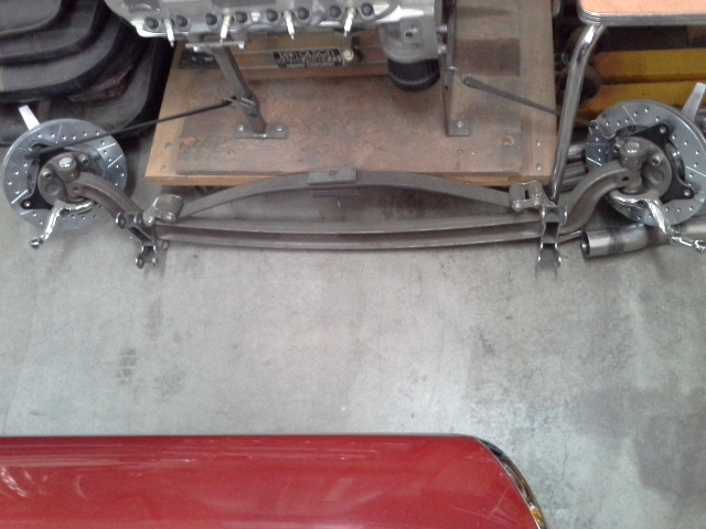

  2. 2OLD2FAST
    Joined: Feb 3, 2010
    Posts: 5,692
    2OLD2FAST
    from illinois
    Don't believe that's necessarily the cause of the man's
    DW , wandering , yes !
  3. flynbrian48
    Joined: Mar 10, 2008
    Posts: 8,476
    flynbrian48
    He took the dead perch out, so without that it has to have a Panhard bar. Or, put the dead perch back in, one or the other.

  20. Kerrynzl
    Joined: Jun 20, 2010
    Posts: 3,264
    Kerrynzl
    Early Fords had Triangle Shaped ["A" shaped] bones., not split bones
    And also the correct shackle angle
    As soon as the wheel gets "re-invented" by splitting the bones, and reverse eye the crossleaf [so the eyes are on the outer side of the arch] the problems start.
    Scrub radius is a factor of king pin inclination not camber. Smaller rolling radius increases scrub radius unless positive offset wheels are used to counteract this
    A dead-perch is a classic example of "Silver wiener syndrome" [If a winning racer glues a silver wiener to his car, all the Hot Rodders and Street Racers would do the same.]
    The dead perch was an early Sprintcar and Midget technique where they're are constantly fighting a losing battle with weight.
    The Cross leaf doubled as a panhard bar, and used in conjunction with cowl steer so it didn't cause bump steer..
    On left turning cars the dead perch was always mounted on the L/H side to keep the leaf under lateral tension. This also cause the L/F wheel to "grab air" which didn't matter.
    R/H dead perches would result in an undesirable jacking effect on L/H corners.
    A dead perch is not overly desirable with cross steer, because it is almost impossible to engineer out mechanical. bump steer. The axle will arc basically 1/2 the spring width. whereas the drag link is much longer.
    If somebody insists on a dead perch, the perch must be on the opposite side of the steering box [passenger side]
    A L/H dead perch with a L/H steering box causes the axle and steering to arc in opposite directions.
    A panhard bar is far superior with a cross steer because it can mimic the arc of the drag link..
    Any driver who is capable of driving at the limit of tyre adhesion would certainly notice the flaws in a dead perch / cross steer combination.
    Tim kerns, flynbrian48, rod1 and 6 others like this.

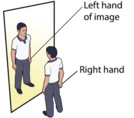

  21. DDDenny
    Posts: 20,199
    Which always begs the question "is that sitting in the driver seat or facing the front of the engine"?
    Now that I think about it....is it LHD (normal):eek: or RHD (across the big water).

  23. Johnny Gee
    Joined: Dec 3, 2009
    Posts: 13,498
    Johnny Gee
    from Downey, Ca
    The real answer is from the drivers seat facing forward naturally.
    RodStRace, rod1 and clem like this.
  24. Kerrynzl
    Posts: 3,264
    Kerrynzl
    Across the big water, steering on the Right side .... is the right side But in the USA steering on the Left side .... is the right side :D:D:D
    But to add to the confusion
    Driving on the left side .... is the right side But in the USA driving on the right side .... is the right side
    It is a simple concept to overcome, Just get a single seat open wheeler and apex the corners [road rules don't matter]
  25. X-cpe
    Joined: Mar 9, 2018
    Posts: 2,096
    X-cpe
    Was always taught that L/H vs R/H was determined with your butt parked in the driver's seat. Told my students that when dealing with customers, use drivers side or passenger side because most customers were smart enough to not screw that up.

  30. Left or right doesn't matter where the driver sits. It's left or right as the car faces forward, same as a person.
