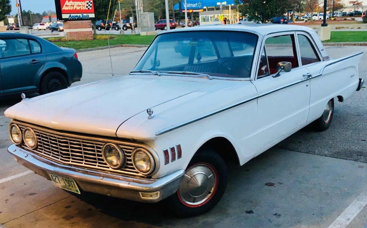

    curious about how to hop this up a bit. had a stall the other day but turns out it was vapor lock (I think).

    Nice looking car! Are you sure it's a 170? I ask because the 144 came with blue air cleaner and valve cover while the 170 came with red/orange. All the upgraded distributors I've seen were for the tall deck blocks(66? or so and later)
    Does it have the heater hoses going to the plate under the carb?
    Start simple like tune up and set timing, then flush the radiator and heater core and put a warmer thermostat back in.
