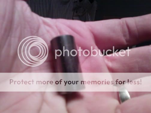

    I was cleaning up after getting everything back together and found this part laying in a towel that I had my old transmission filter and pan sitting in. My 5 year old daughter was "helping" me and was messing with stuff from time to time. I thought I kept a good eye on her but found this part. The only thing I removed from my tranny was the governor, filter and pan. I inspected the governor right before I put it in so I don't think it came from that.
    Any ideas? It's a TH400 transmission. I was working on some other front suspension parts too but I don't recognize this piece.

    Looks like a sleeve for a rubber bushing.

  4. Alignment dowell from bell housing

    Does look like a bushing sleeve for a shock or something. She's just trying to collect some parts for her future build.:D

    If your running a deep pan, there is a spacer that goes over the bolt that holds the filter off the bottom of the pan. Kinda looks like that could be one.

    looks like an alignment dowel to me as well, but i couldnt tell ya where it goes

    The center bolt that holds the filter, some have a sleeve like that between the filter and valve body. I think the deeper pans do, I can't remember.

    Cool, that makes sense (goes with the filter bolt).
    The filter seemed to go on snug... Do I need to put this sleeve back in? Will it mess anything up without it?

    that would be solid and not that long

    and tapered on the ends

    Well, I'm guessing the logical thing would be the sleeve for the filter bolt. I hadn't put fluid in it yet so I'm gonna drop the pan back down and put it in for peace of mind.

    It's for the filter. Deep pan (truck) transmissions use it. Goes between filter and valve body.
    If he was working on some late model little engine, it might be a bellhousing alignment dowel, but the dowels on all the TH400 equipped engines were solid. Because the bolts are above and below the dowels, not in them.

    Thanks guys, I got the spacer back on. It went to the filter bolt. I'm glad I noticed it when I was cleaning up though. My first thought was... Oh God did she crawl under there and pull something out!
    I got it fixed now... Thanks all for the info. Now I know what an alignment dowel looks like too.
