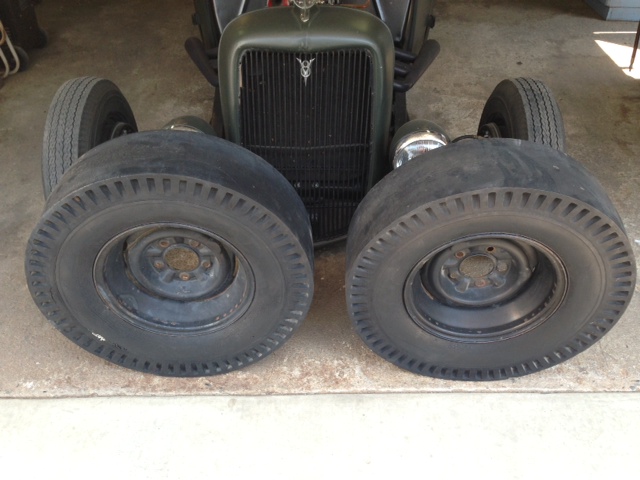

    I have a set of old Michelin X tires on my car. I know they are not original, but I'm trying to find out how old they are. (I wont drive on them, just curious to the age)
    Anyone know if anything on the tire can give me clues?

    A couple of those tires look pretty weather checked.

    Yes, they are beat and will be replaced. I'm just trying to find out their vintage... (since it's a race car, I don't want to toss them if they figure into when the car was used for racing).

    I wouldn't even drive them around the block. I just want to place the age.

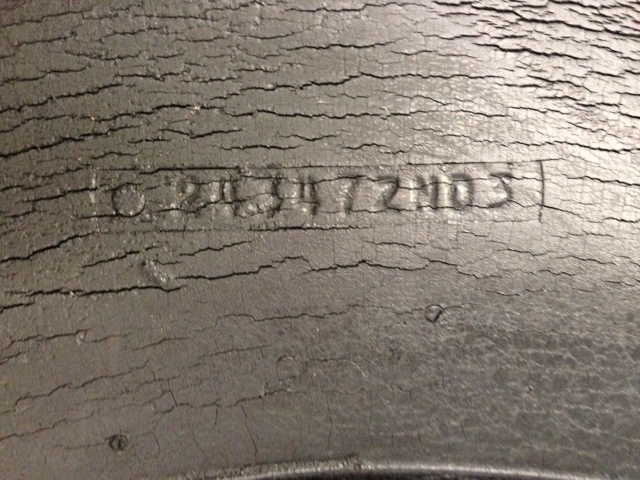

    and the last one....
    Anyone have a guess ???

    I understand where you are going with this. I originally thought that you were trying to decide if they were any good.
    Let me go back and see what the fella was saying about date codes and see what I can figure out.
    I can't make heads or tails out of them if I go by the information that we have been given. If I were to go by the sizing I would have to say that they are a tire from the early '70s. the reason i say that is that they don't have a metric size and by the later '70s they had gone to metric sizing on them.

    I know for sure they are between 1959-1972. I know that's a huge window and doesn't help much.
    I tried the tirerack, but the code doesn't work out right.

    mid to late 60's based on the size and the look of the sidewall.
    Friends dad bought a set in that era and the look the same.

    The current tire date code started life in the 90's. If you call the manufacturer they will not likely be very helpful due to the huge liability litigation industry that they want to stay very clear of.

    This photo is from 1962. So that's gotta close the window a little more. The car has roughly 30K original miles. In 1962 the wheels were widened for bigger tires... so the set shown are brand new in the photo. The set on the car now has to be the "NEXT" set of tires after this photo.
    That means the set on the car now are probably right where you guys are guessing... 1965-1970'ish.
    That's good enough for me. THANKS GUYS!
