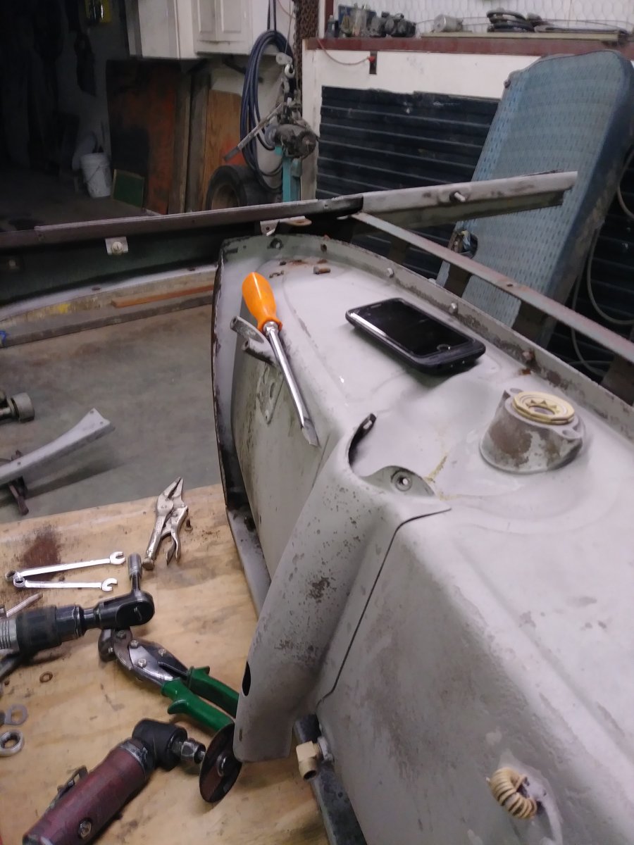

  1. So I don't screw it up the brass collard pc in the gas tank does it screw in. If so right hand or left Han treads??? 20180405_111711.jpg
  2. badshifter
    Joined: Apr 28, 2006
    Posts: 3,537
    badshifter
    Yes it screws in, right hand threads. There is a wrench that fits it but CAREFUL channel locks will remove it as well.
    The inner 8 pointed piece unscrews from the outer. It holds the glass and a seal you'll need to replace.

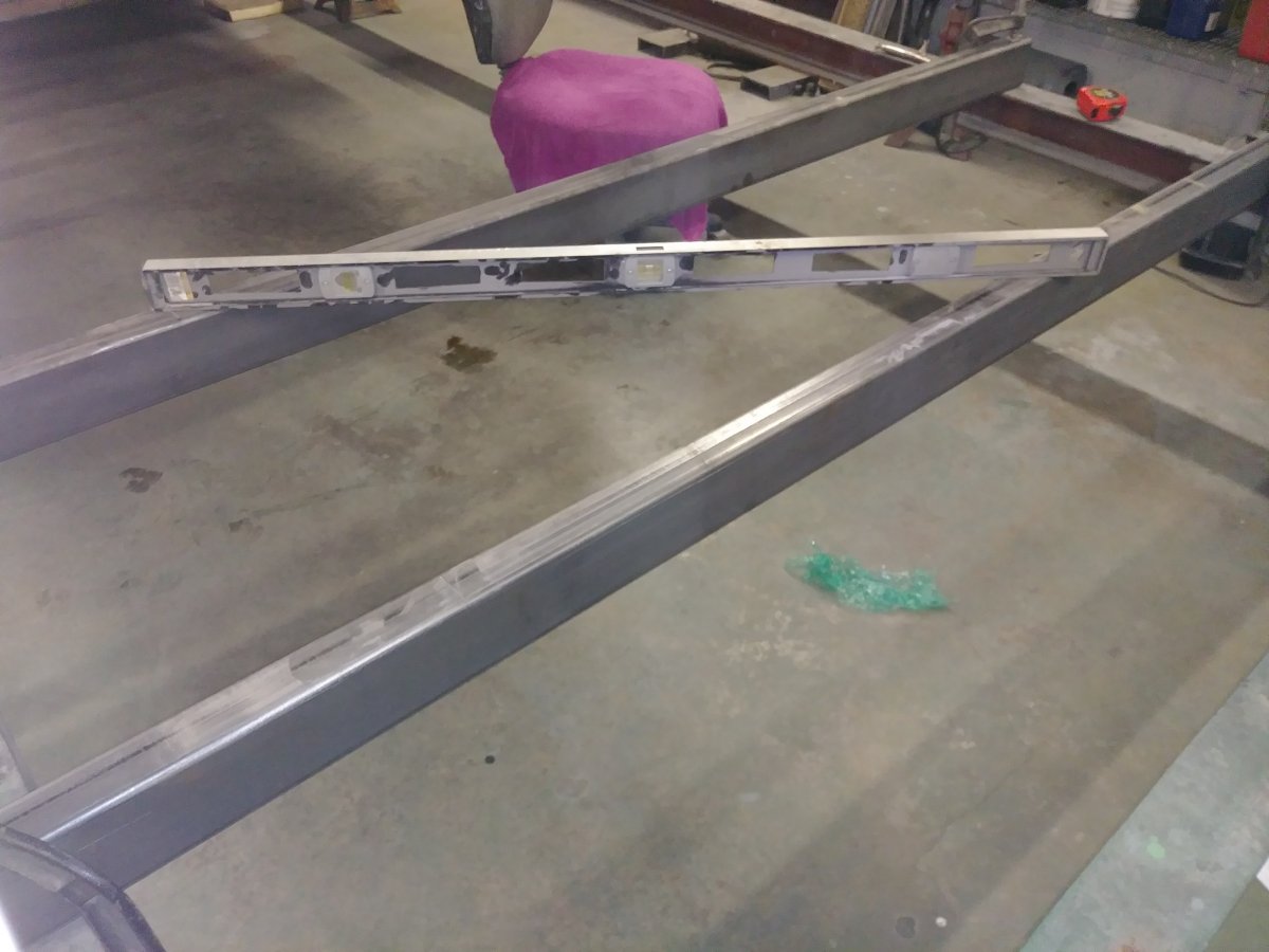

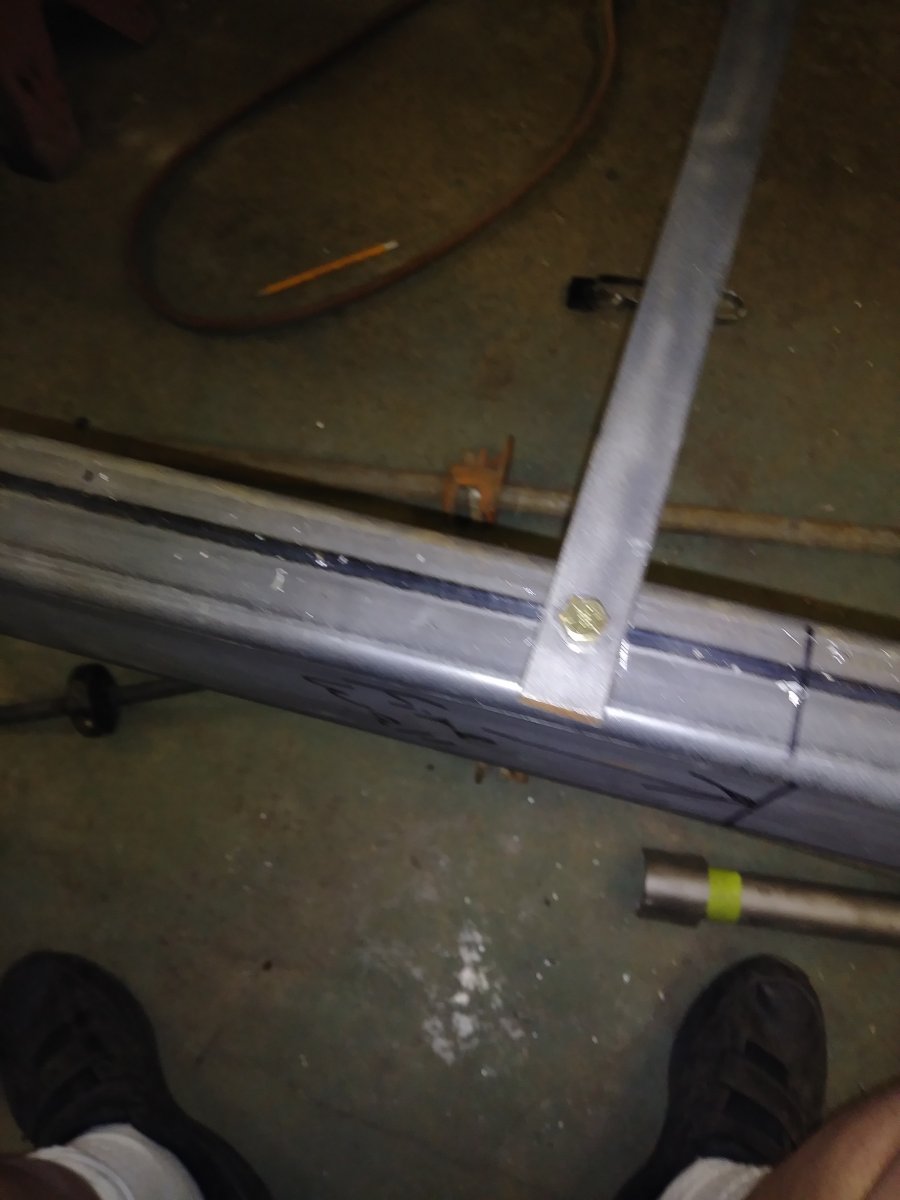

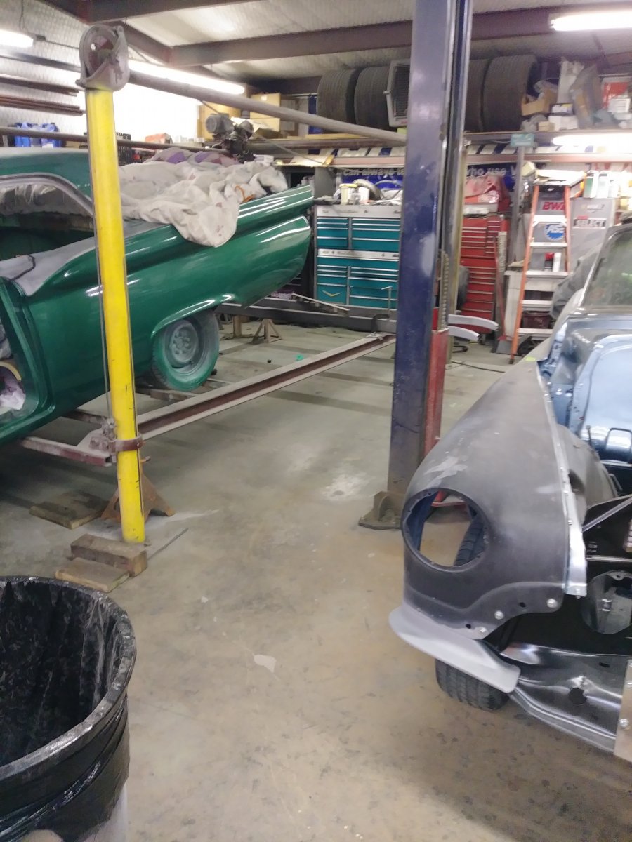

  10. I have a 22 foot long frame table I could use but it is stored above the paint room.
    And a model a frame is not rocket science. It just needs to be square and level. If you wanted it could be done anywhere you could clamp it down so it does not twist and warp. Me being the lazy person I am decided to do it clamped the my walker muffler lift made in the 1930 seams only fit
    The trick is Everthing must be level I put stands under the lift and shined till level
    I scribe lines in 3 spots frount edge of cross member .
    I use a thin cut off blade to do this no deaper then1/6" just enough that you don't mistake it for scratches.
    On this frame it was 10.5" to frount edge of spring cross member.
    next line is edge of fire wall 47.5"
    and last one rear of cab 95.5" all from frount fram horn.
    This also gives me fixed points to square the frame.
    Chech for level in every possible direction
    Repeat check level and square. Over and over the closer you are the better it will be. It took 5he to get it square and level.

    the gas gauge wrench pictured above is the outer, there is a wrench with a star shape on the outside...
    that is the wrench that fits inside the star shaped fitting... memory says you need both... be very careful as everything strips easy, brass fitting and the aluminum wrenches...
    also, some A gas gauges have a magnifying glass lens... very handy.
    I do have one out back...

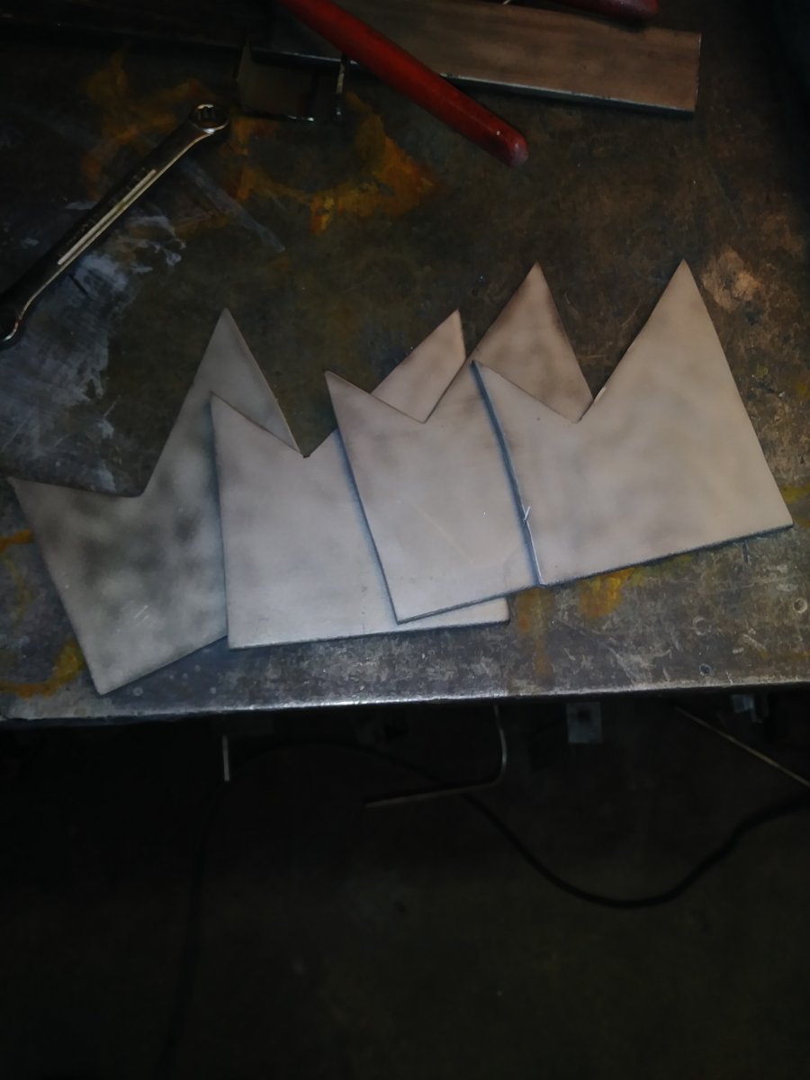

    I used some 2X3X3/16 tubing to make the corner gust and angelded them 5 deg just like the cross member.

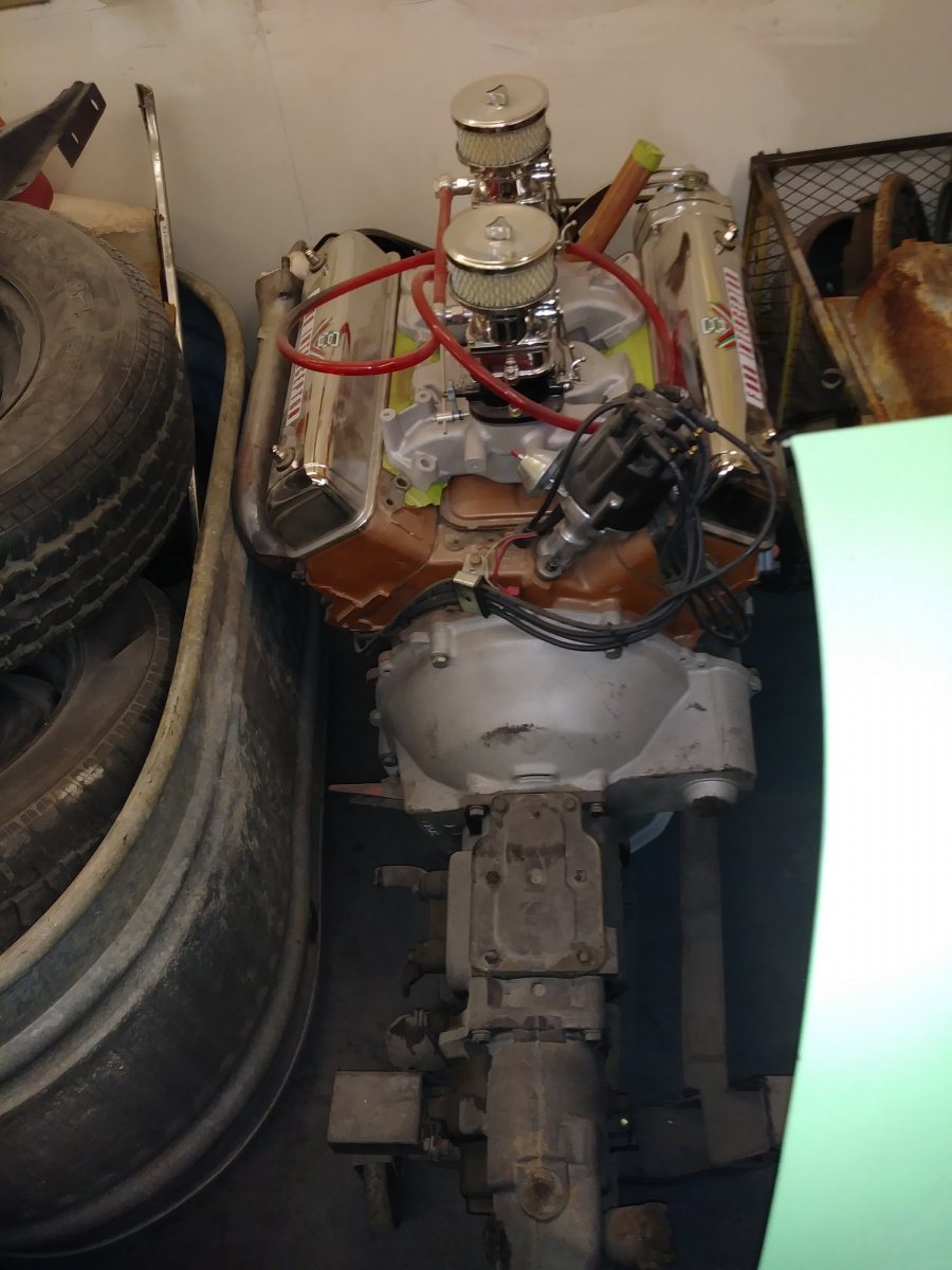

    My $100 radiator from eBay 2 years ago
    The completely rebuilt engine and trans. I tried up around$3800 in parts and machine work .
    Hopping the .40 over 272 won't need the 3rd Stromberg carburetor I had to mortgage the house just to buy 2 of them LOL.
    brEad and sloppy jalopies like this.

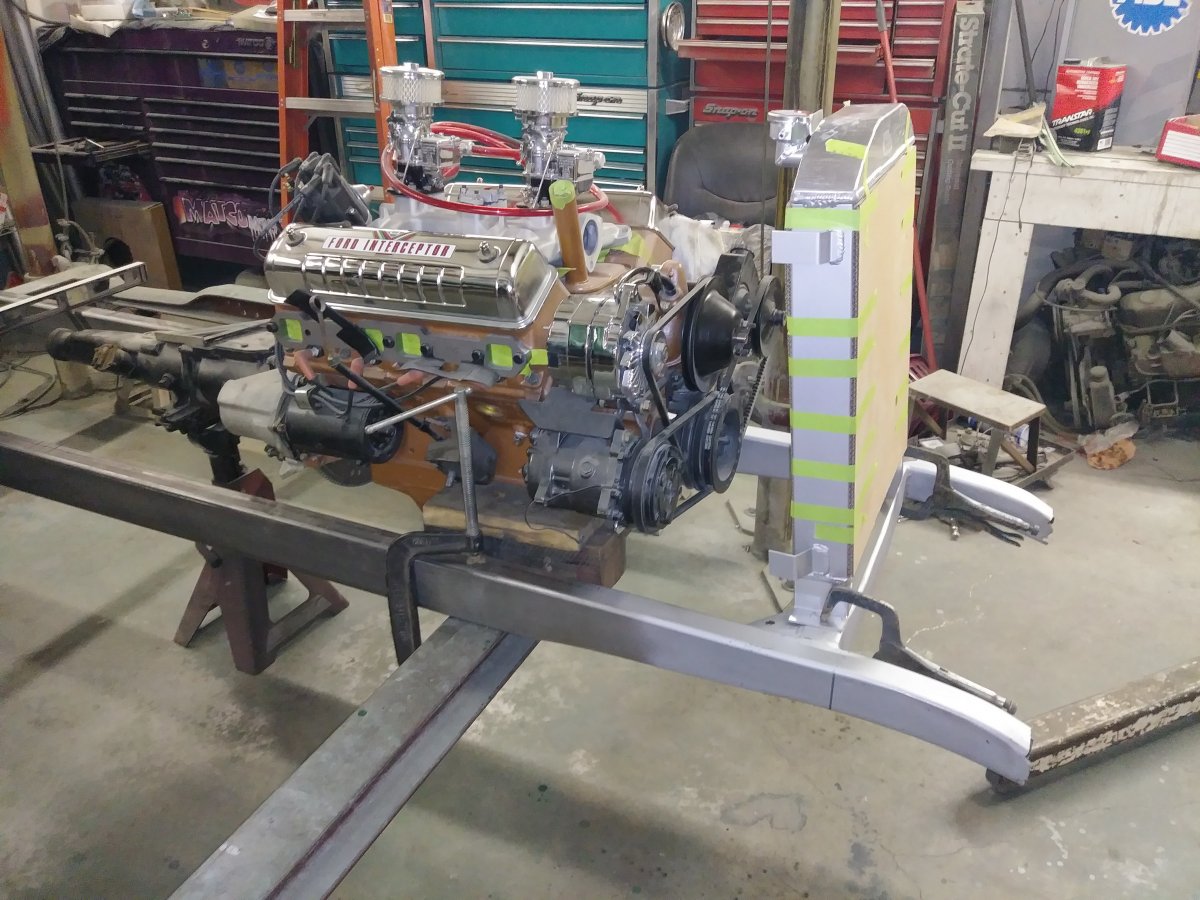

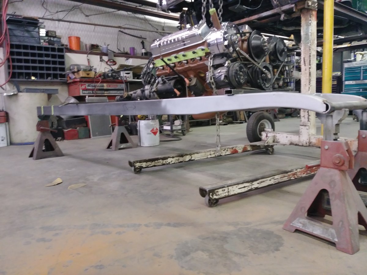

  18. Trial fit of the Y-Block gave me the location of the center K-member. It also let me know I needed 3 more inches between the fire wall and radiator.
    Now pull it back apart
    mkebaird, Okie Pete and kidcampbell71 like this.

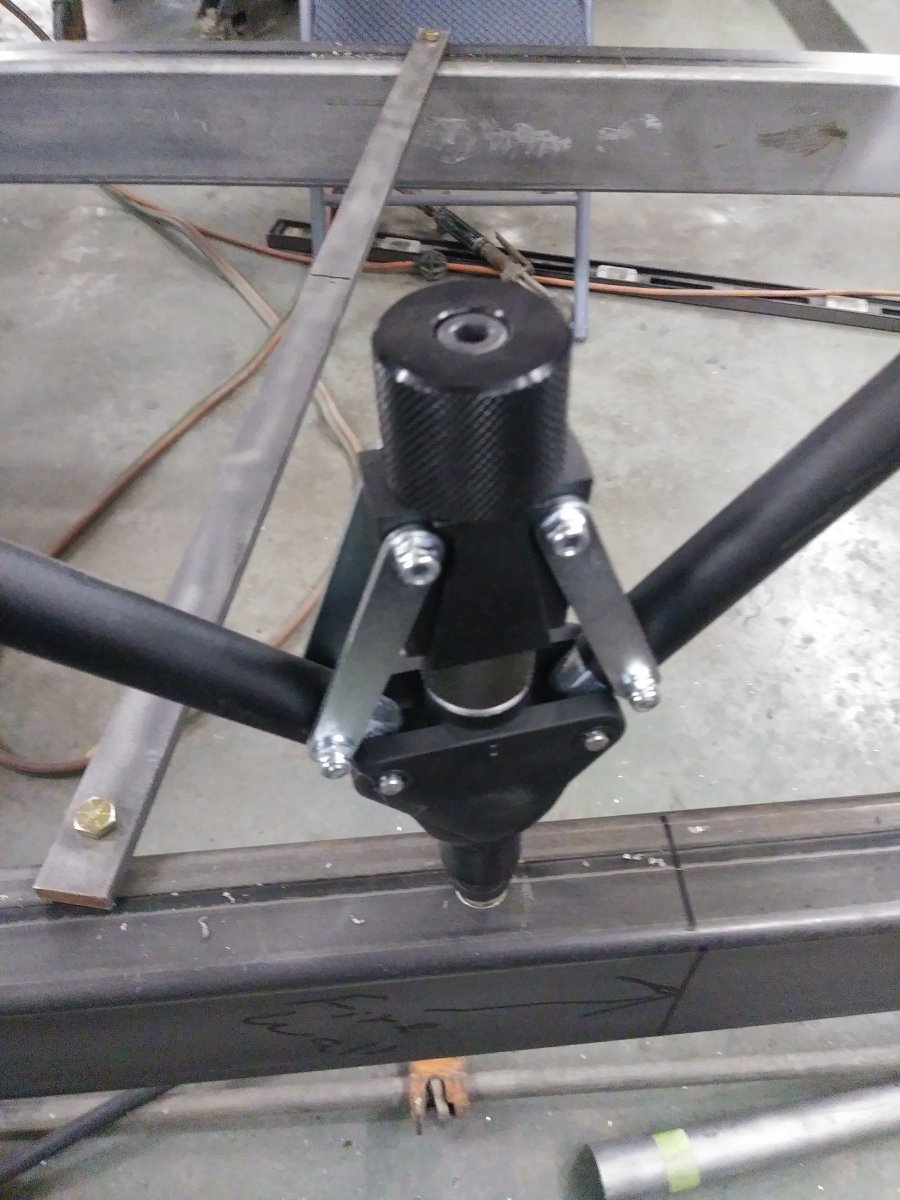

  21. Before we had nutserts we drilled large holes and welded in nuts. 20180414_120359.jpg
    Now we install these.
    You use this tool.
    Drill the hole stick the nutsert in and squeeze
    And now I have my cowl mounted located.

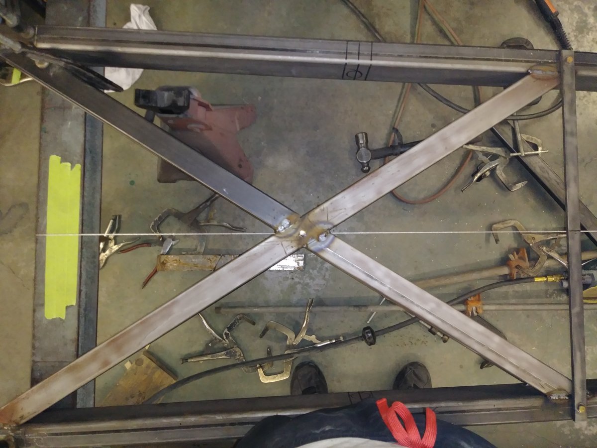

    I believe I have room at the in side edge at the bottom to build an X-Member. At the side edge top of frame I will do the same then cut the center of the X out and join the sides with parall pc. And a drive shaft loop front and rear. This will also help support the floor.
    I have run a center line check for square and level.
    Only decision is to make it out of 1×3×11ga or 1×2×11ga?

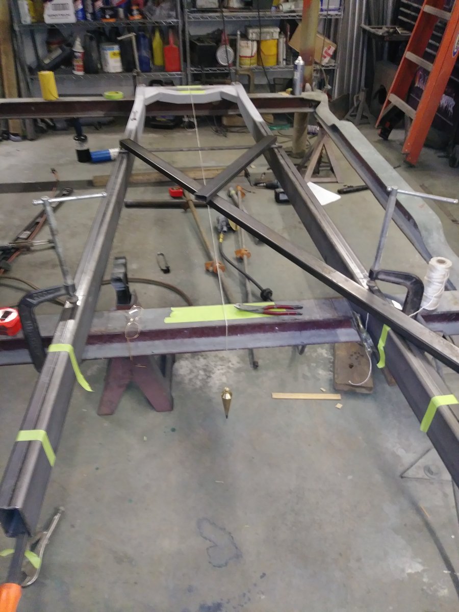

  24. You are ready to weld when you have at least 70% of your clamps out.
    Checked everything 1 last time now install X-Member.
    brEad likes this.
  25. The bottom X is in and welded on 3 sides
    Now doing the top X. The top one will get the center cut our and 2 loop installed for the drive shaft tunnel
    It is easier to make and weld in 2 X's and make them match and then cut the top center out. Then to do the bottom one put in the loops and try to make the reast of the X match
    Okie Pete and OFT like this.
  26. That's the 2 X-Member in and welded on 3 sides. Let everything cool down and unclamp the fame in the morning and see if it's still square. If so flip it over clamp it down weld the bottom side. 20180415_142500.jpg
    20180415_142527.jpg Frame should be solid. No flex or twist.
    brEad and OFT like this.

  28. Got the engine mounts figure out
    Cut some 3/16 plate nothing fancy just strong.
    There not much to look at now but I will cap them later.

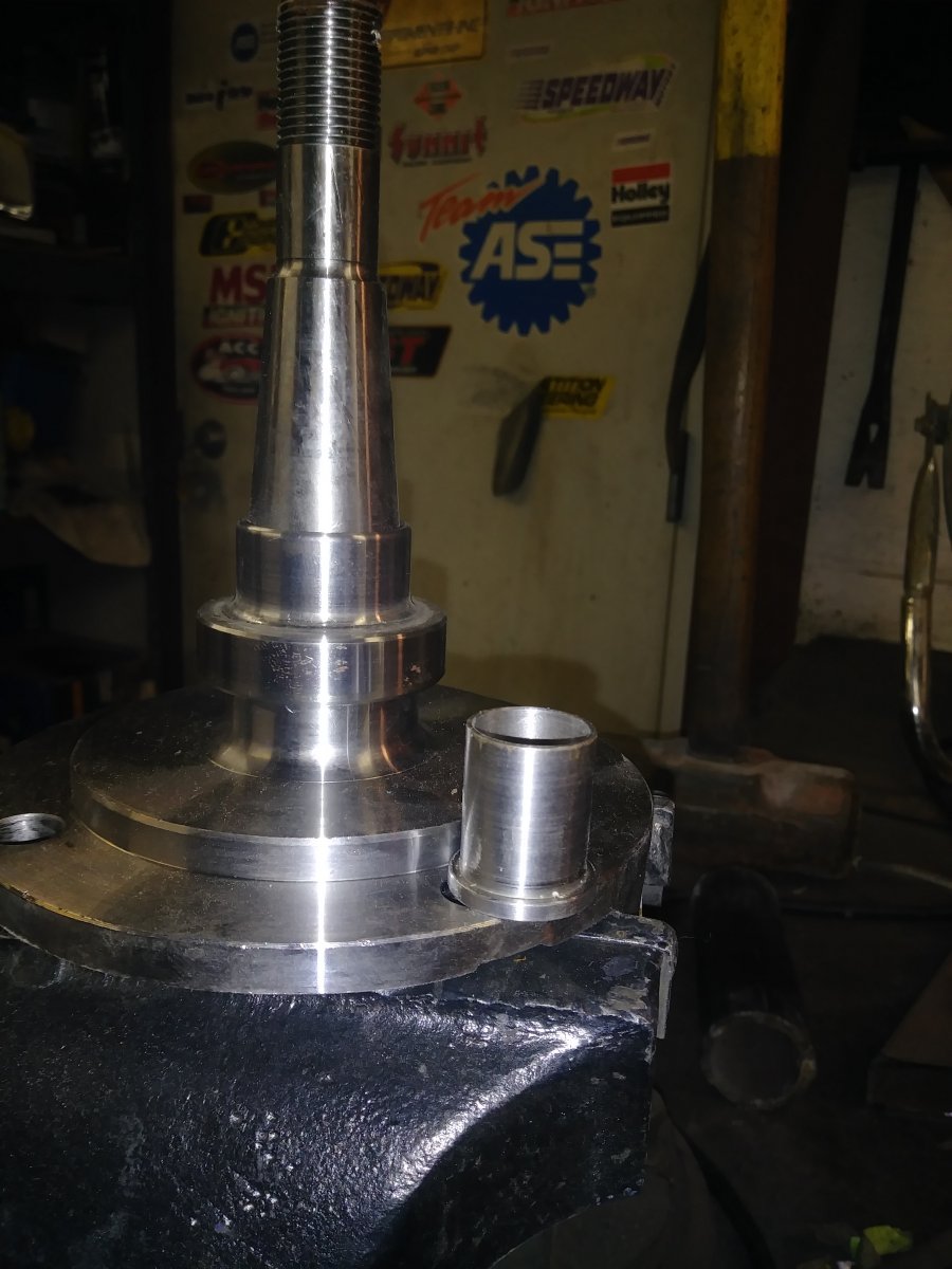

  29. 20180419_105701.jpg Most of you modify the ford hubs to work with the 45 fin aluminum Buick drums.
    There was a kit to use the Buick drum and hub assembly with cheep easy to get berrings.
    I bought 2 of the kits years ago and here is one.
    The kit has 2 bushing that are a tight machine fit. I heat them with a heat gun and tap them on
    A set of Wilison backing plates.
    They come loaded and are self adjusting
    And the 45 fin Buick drums.
