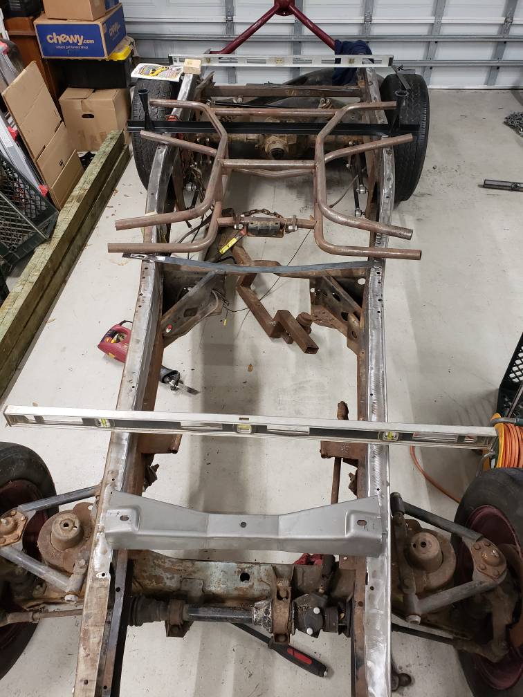

    Finished boxing the JW frame rails today, checked to make sure that the frame rails are square and level, (they are) next will be the model A crossmember. Yeah, I know I should be using a frame jig, but I don't have one. But I do have a perfectly level garage floor (which is really annoying when I wash the floor) and I know how to read a rule and work a level. Between the frame measurements, the original frame, and the original body I'm pretty sure we'll get it right. Best part is, dad and I are having a blast together! 20190120_180005.jpeg

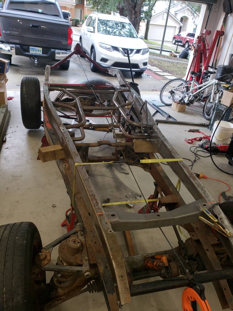

    I found the perfect frame jig! The factory frame along with a level and a tape measure. Works great! Thanks for JW garage for making quality parts. Just a few tweaks and it's right on the money! 20190122_180856.jpeg

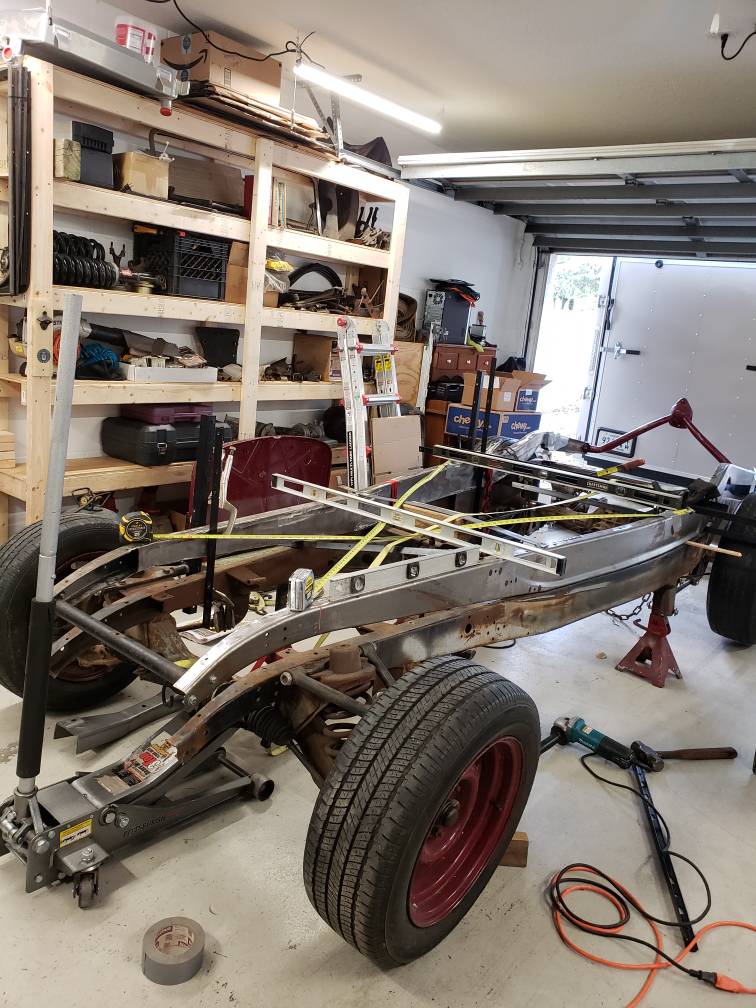

    Sure do wish someone I knew had a frame table... sure would be easier! Alas, the factory frame will have to suffice. After two days of measuring, checking, adjusting one thing (that affects seven other things,) I think I'm getting close! I'll check everything 10 more times before I set the front crossmember though! I'm sure a $10000 frame would have been easier (or maybe not) but at least I'll have the satisfaction of knowing it's square (and safe) when I'm done. 20190124_114952.jpeg

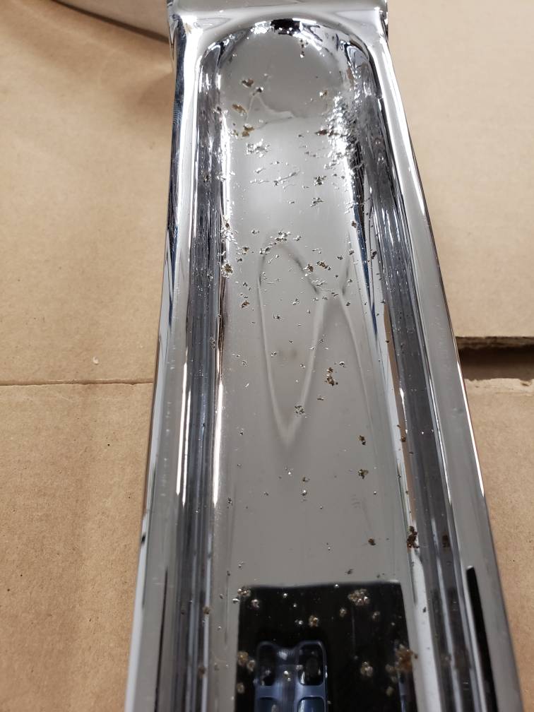

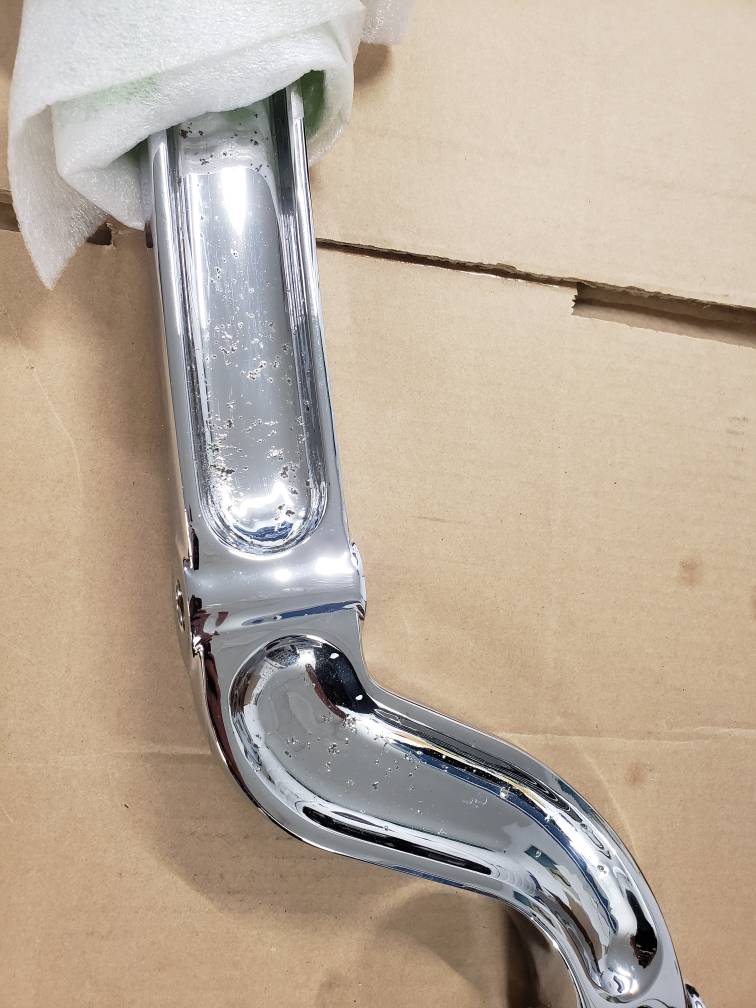

    Sad, sad day. I was going to start assembling our new 4" drop front end and when I began to unwrap my shiny chrome parts, I found these very sad freckles. Unfortunately there's a 2 week wait on a new one. Weekend goals busted! With a full fendered car, should I run a 46" or 47" front end? 20190125_155124.jpeg 20190125_155003.jpeg

    I am curious about the axle, was it an original that you had chromed, or a new one ?
    I had similar outcome with a windscreen/windshield frame that was new.
    I had it chromed and the acid wash wasn’t cleaned off correctly, and 6 months later, same look as your axle. 2 years later it had completely rusted out, and I threw it out. At least you can save that axle if you take the chrome off it now and clean it up.

    This was a new axle I purchased at the Turkey Run in Daytona this past Thanksgiving. The company I purchased it from is sending me a new one. A 46" Superbell this time.

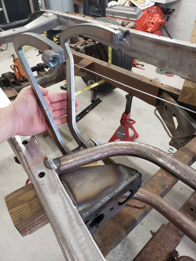

    Dad and I got the main crossmember and slick pedal assembly installed today. Everything is coming together nicely. It's all very square and true, very happy with our progress!
