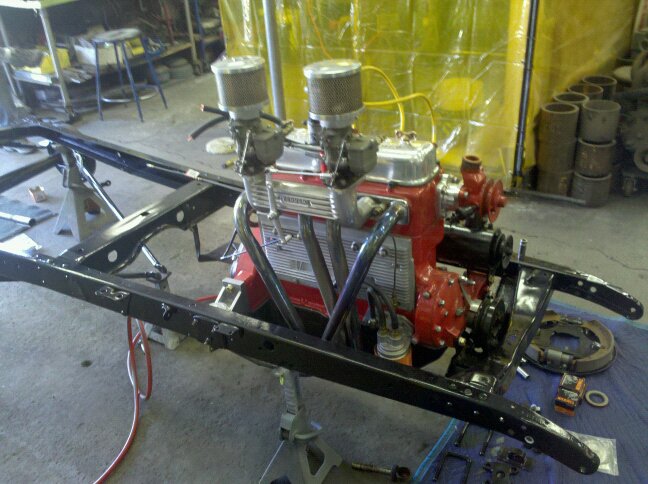

    So here is the update. Miller B has been gone through and run up at Taylor. Shane was kind enough to sell me a '32 trans which has been completely rebuilt and modified by Al Zannino, he also parted with a Borg Warner TT overdrive which he had rebuilt. Tom Endy rebuilt the rear end, which was in great shape and mostly original. Chassis is stripped, primed & painted. Time to start piecing it together, let the fun begin.
  17. strohmdl
    Joined: Jan 4, 2008
    Posts: 40
    strohmdl
    Engine in.

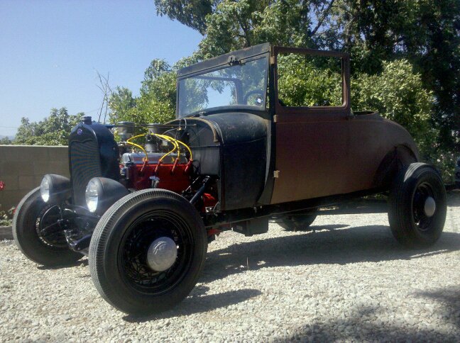

    Definitely not a roadster, but I do still have the original doors and frames that my dad's buddy chopped back in the 60's...hence the ability to easily swap to a roadster-ish type of topless body.
    Trans, overdrive/torque tube and rear end are in.
  25. strohmdl
    Joined: Jan 4, 2008
    Posts: 40
    strohmdl
    First road test yesterday. Ran out nicely, but it loads up unless you stab the thing. Two 97s might be a little much. I'll try to rejet them first, but may end up going to 81s. Only thing left is to hook up the overdrive. Concluded the night at Santa Paula Cruise Night with a pint at the pub. A good Friday night.

    Roy: I kept the gravity feed, so pressure isn't the issue. I found a guy who knows Strombergs, so I'm going to rejet per his specsand swap power valves. Hopefully that will take care of it.
  29. First time I've seen this thread. Great project. Looks like a blast.
    A "3 generation hot rod". That's even cooler. My dad was not even remotely a car guy.
    Like that you are running the souped up banger.
    Best of wishes.
  30. strohmdl
    Joined: Jan 4, 2008
    Posts: 40
    strohmdl
    Strombergs still coughed and wheezed with the new jets, so I added an inline 6v low pressure pump...viola! Pulls hard through the entire RPM range. Tested the overdrive last Sunday too, worked great for a few engage/disengagements, then the solenoid got stuck with OD engaged. Pulled the solenoid out in the Vons parking lot, and have a new (old) one on the way. Small kinks getting worked out now, good times.
