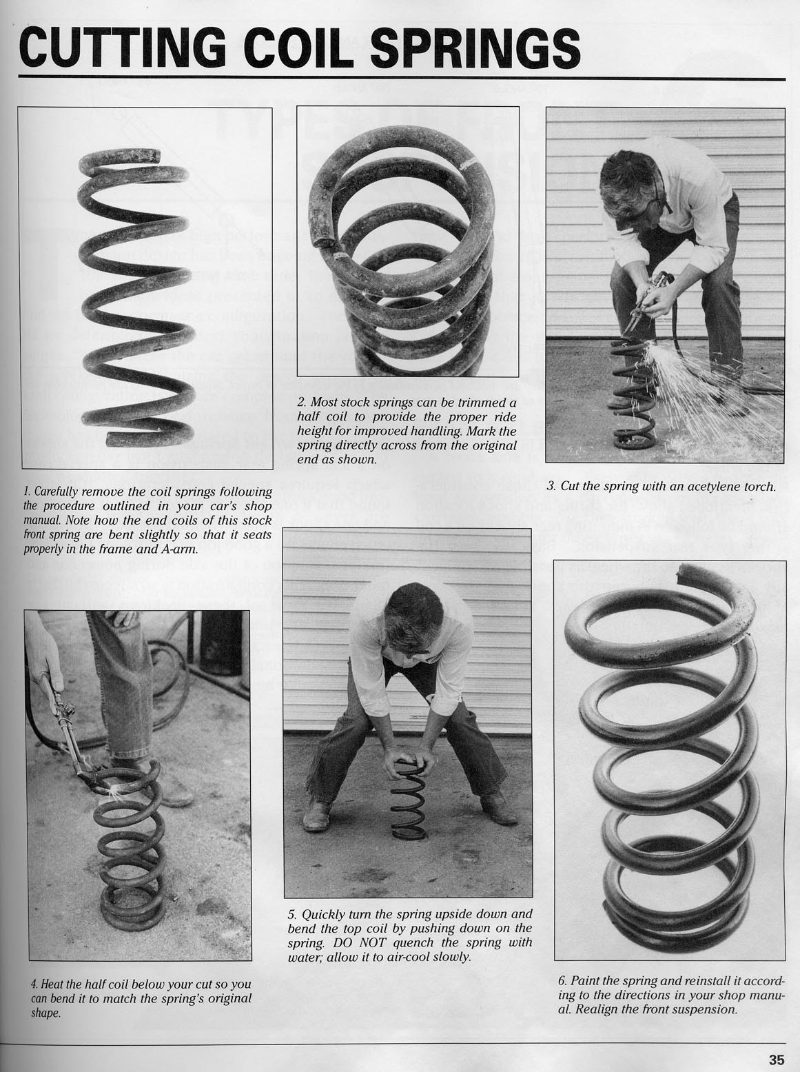

    From book by Herb Adams. Have used this method, works fine.

    Hmmm, may have to try that, only thing I would do is grind down the egde of the spring to make it nice and flat like the stock one...
    And cram it in a bucket of sand for cooling.

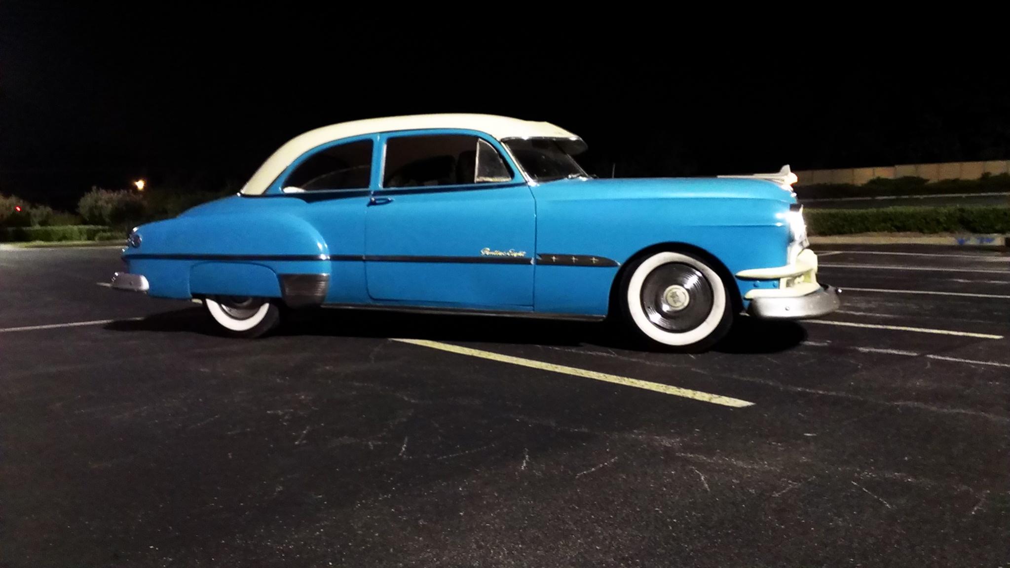

    I Just cut my 51 Poncho springs. The car sat higher than stock due to SBC rather than stock straight 8 anchor. I took 3 coils off... here is the result.
    I started with 2 coils and it looked good but not right. For a simular vehicle with stock stance, I would recommend 2 coils, if not enough redo.
