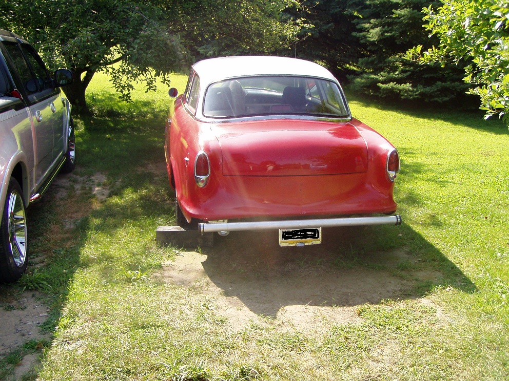

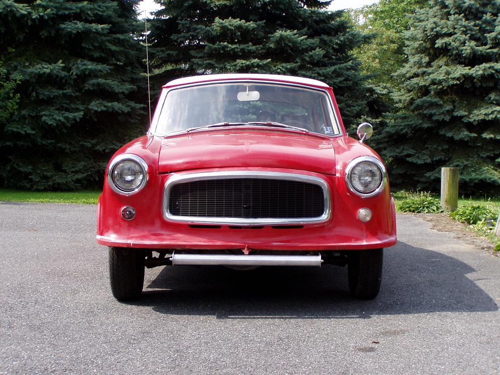

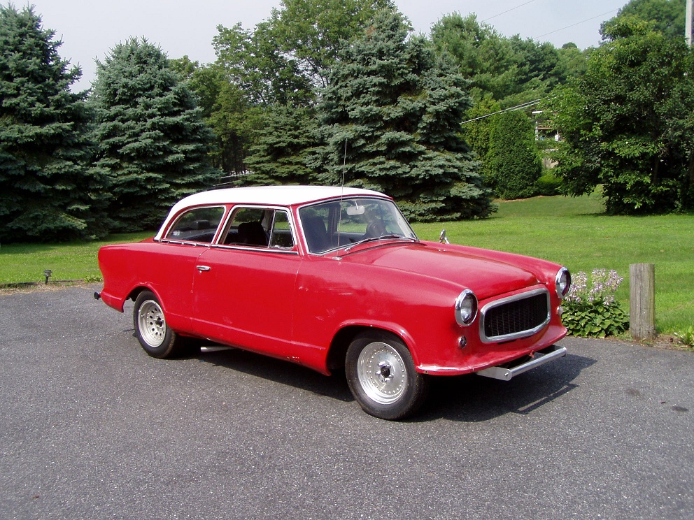

    Here my 58. Wish it was a wagon
    I went with front running and wide tires in the rear and gave it a drag car look.

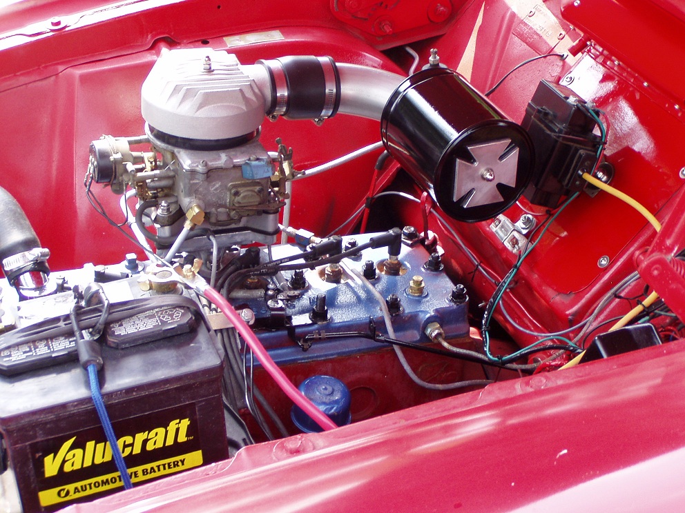

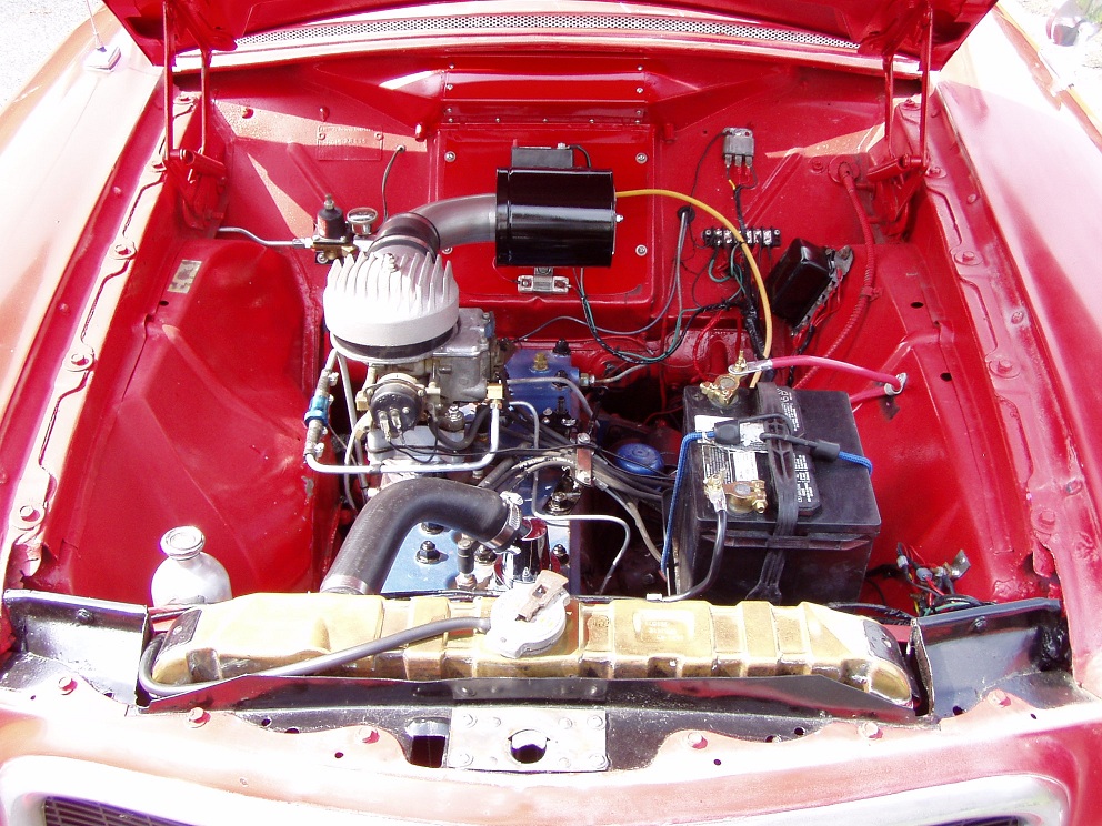

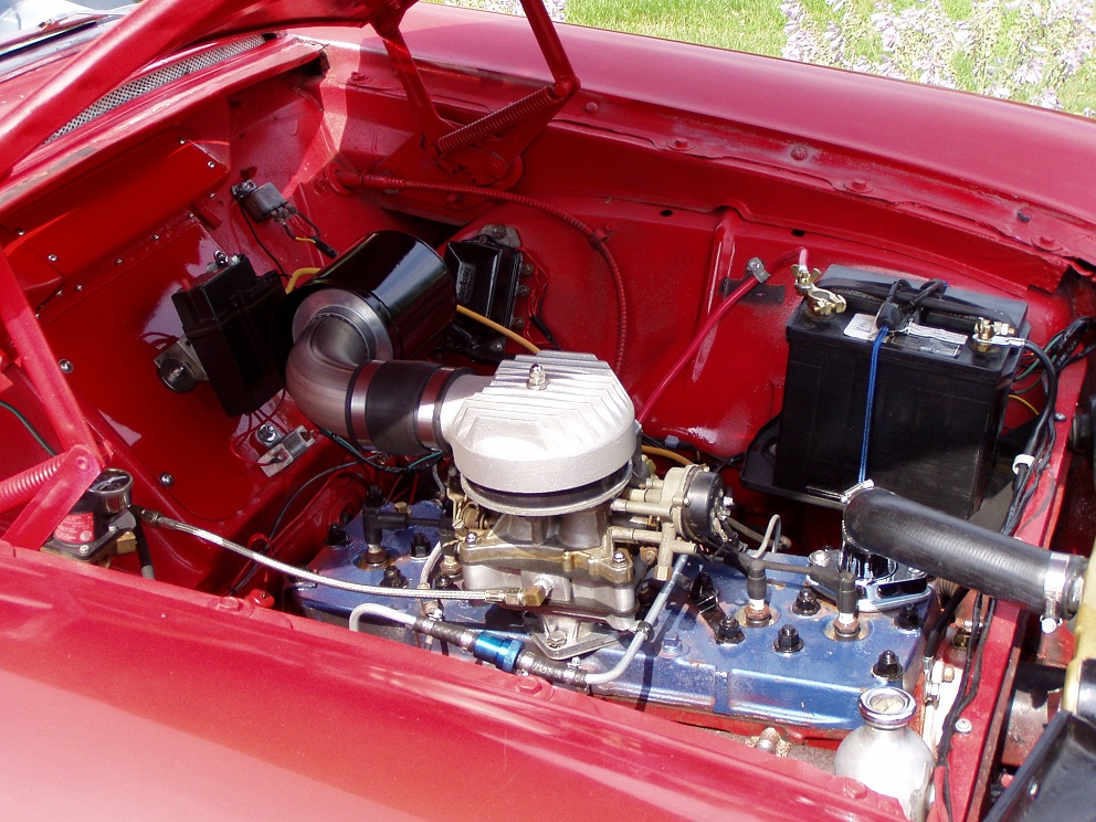

    Hot40Rod, what's under the hood? I'd really like to see some underhood shots. What did you do for the front suspension?

    Still has the flathead with a ford 2100 series Carb. Which woke it up a little. It make people look. I plan on a upgrade for the suspension and a V8 over the winter
