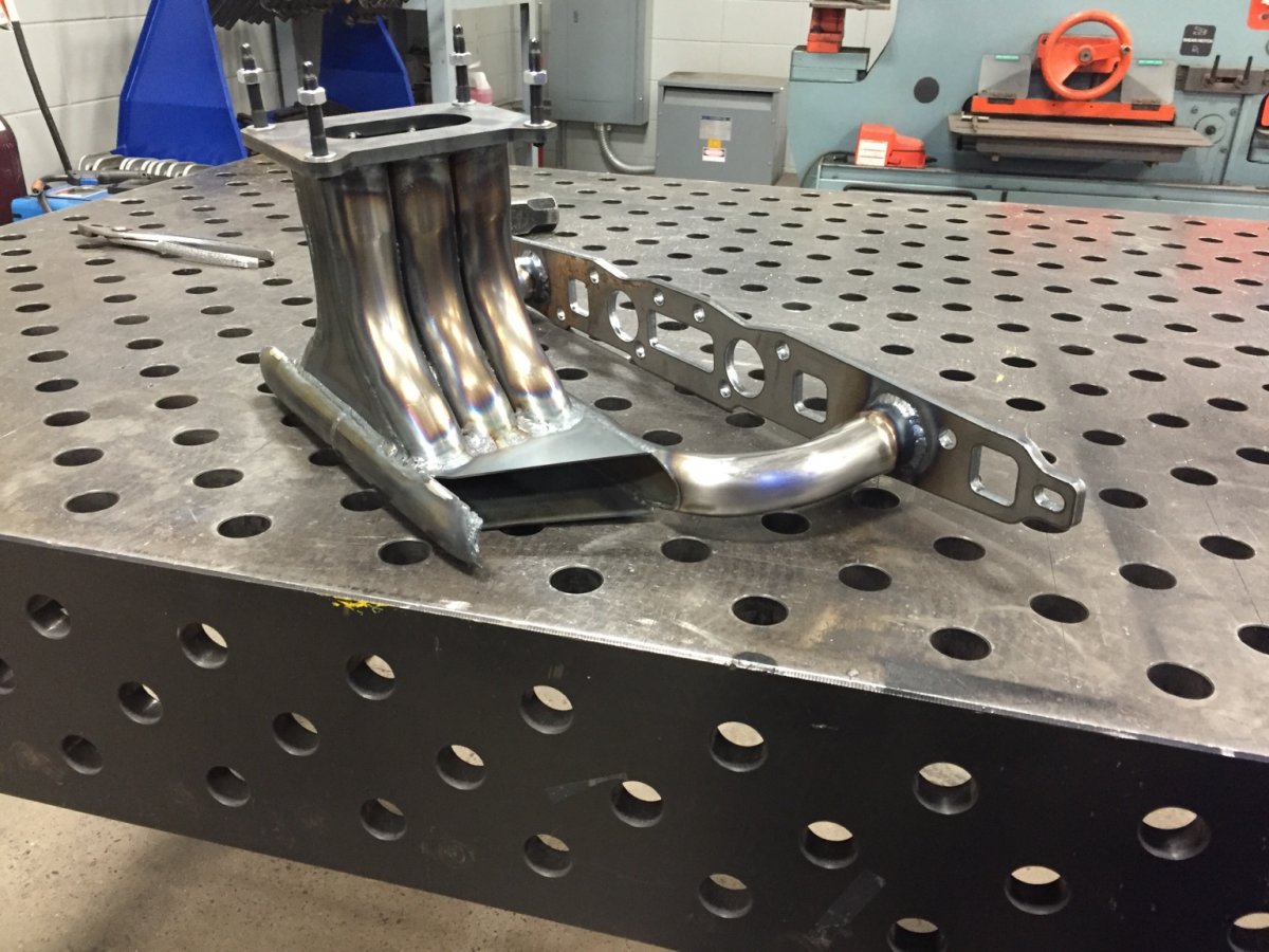

    I recently started to fabricate a new intake/exhaust header for my 223 I6 and thought I would share a few pictures as I progress in the build. I think it's going to be a one of a kind in its uniqueness and would like to hear from experiences builders what they think of it.
    This is what I have for the carburetor riser.
    My tig skills need some refining.
    There will definitely be more to come, I'm currently working on the intake ports and chamber that the carburetor riser will sit on.

    Intake is coming along nicely, a few more pipes and end caps and I'll be on to the exhaust portion of the build. In my opinion it's not bad for the first header I've ever attempted.
  5. You've got my attention. What carb will it be topped with? How about the heat exchange from the exhaust? Are you gonna fab your own exhaust manifold or headers? Keep us posted. Subscribed. Thanks

    This is for a Holley 4412, the square holes left in the flange are for the exhaust. It's going to be an intake and exhaust all in one assembly. I've been thinking of the heat exchange. Not 100% on that just yet.

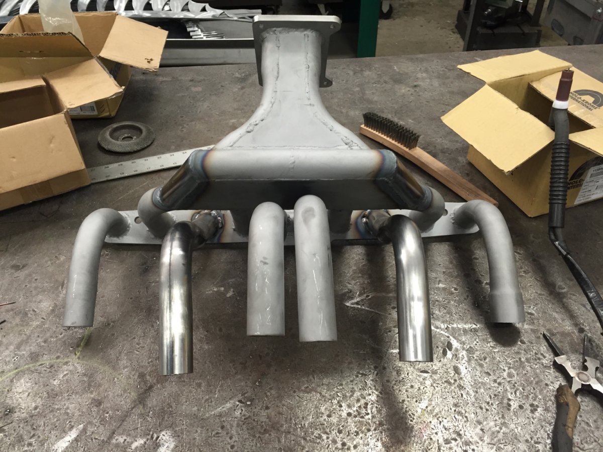

  10. Clint86
    Joined: Mar 15, 2014
    Posts: 93
    Clint86
    Got some work done to it recently. Added the final intake tubes. Going to sand blast the interior chamber before capping the ends though, get the slag and weld BB's out so I don't suck one in to my engine.
    I got started on the first exhaust tube as well.

    Looks like a lot of plenum area.....may have trouble with stumbling-dead spot issues...if you do maybe a pyramid shaped divider under the carb would speed up your velocity and make a stronger "signal"

    Ok, here's what I've got for the heat exchange. I'm hoping that radiant heat from the number 2 to number 5 exhaust tubes will be enough. It's the best idea that I've had.
    Here are the number 3 & 4 exhaust tubes to give an idea of how close they are to the intake portion.
    This was a difficult bit of TIG welding, it shows in the weld too.
    Cylinders 1 & 6 will be identical, cylinders 2 & 5 will be identical and fall in between 1 & 6 and 3 & 4 and also dip under as 3 & 4 do. Confused yet?

  14. I buy a lot of product from S.P.D. Exhaust. Google up there web sight and look at there line of products. You'll be impressed. Here is something I've learned after building many a set of custom headers. I build all the tubes complete flange to collector before I ever weld them to the Flange plate. I also pressure test all tubes. It's way easier to stop a leak before everything is welded together.
    You mentioned the less than perfect welds on your flanges. I'll make a guess here and ask if you cleaned the bend lube out of the pipe before you started welding? That stuff can cause you all kinds of Grief.

    I will definitely keep this in mind the next time I build a header, learn as you go right? I pray to God that I don't run into a leak as some of these joints have stupidly small clearances for any weld process. I wish I could say that the bad TIG welds were from improperly cleaned parts, sadly though, I'm just a crappy TIG welder. I'm working on it though. Thank you for pointing me to S.P.D. Exhaust, it looks like they'll be able to help me with what I need.
