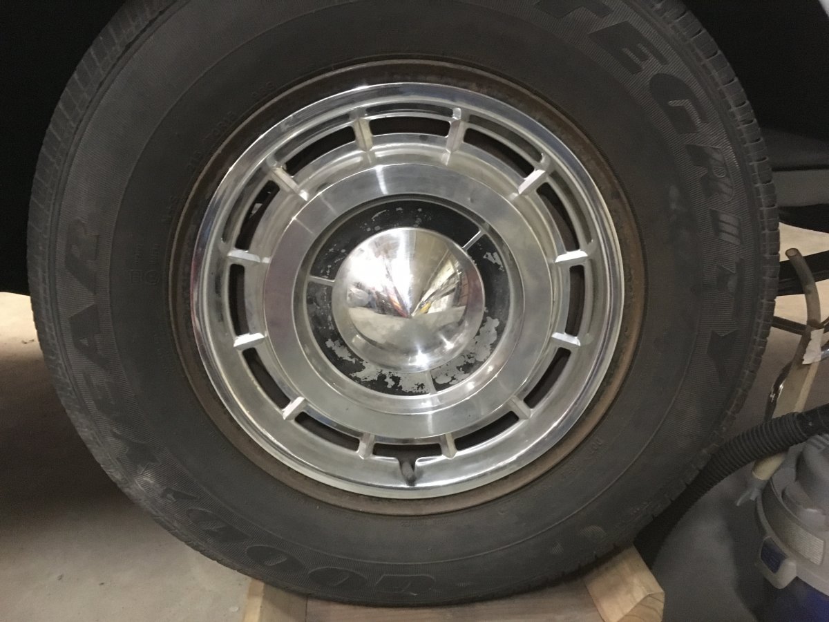

    I have one of these caps, sorry to say only one. I am sure its some kind of JC Witney or other aftermarket hubcap. Looks good on the way anyway.

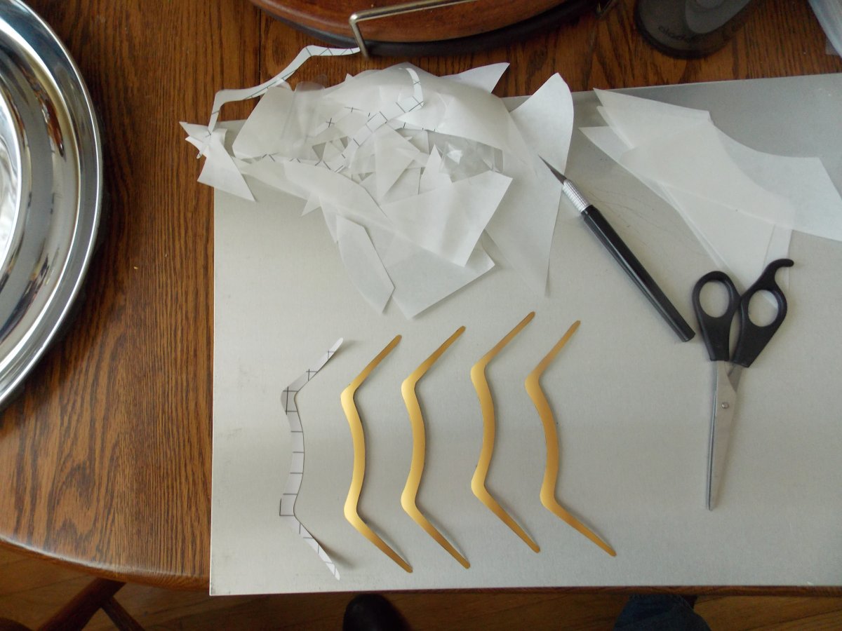

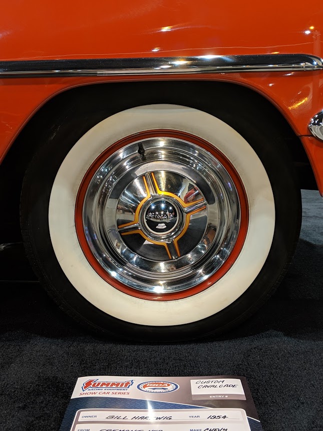

    54 Imperial with a bullet ... and 4 homemade stencils outlined with a fine tip red paint pen from hobby lobby DSCN2308.JPG

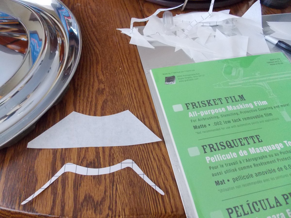

    These are really nice. It probably took you quite a while to make four of them, but IMO the results are worth the time it took you.

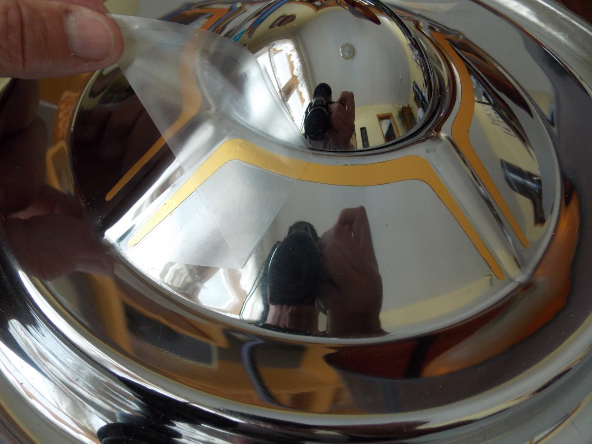

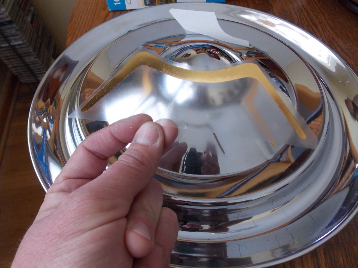

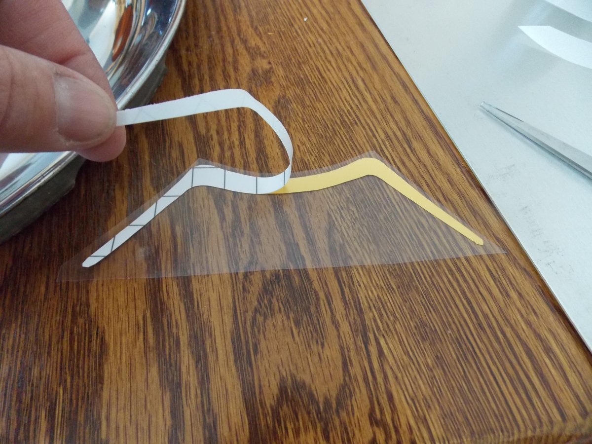

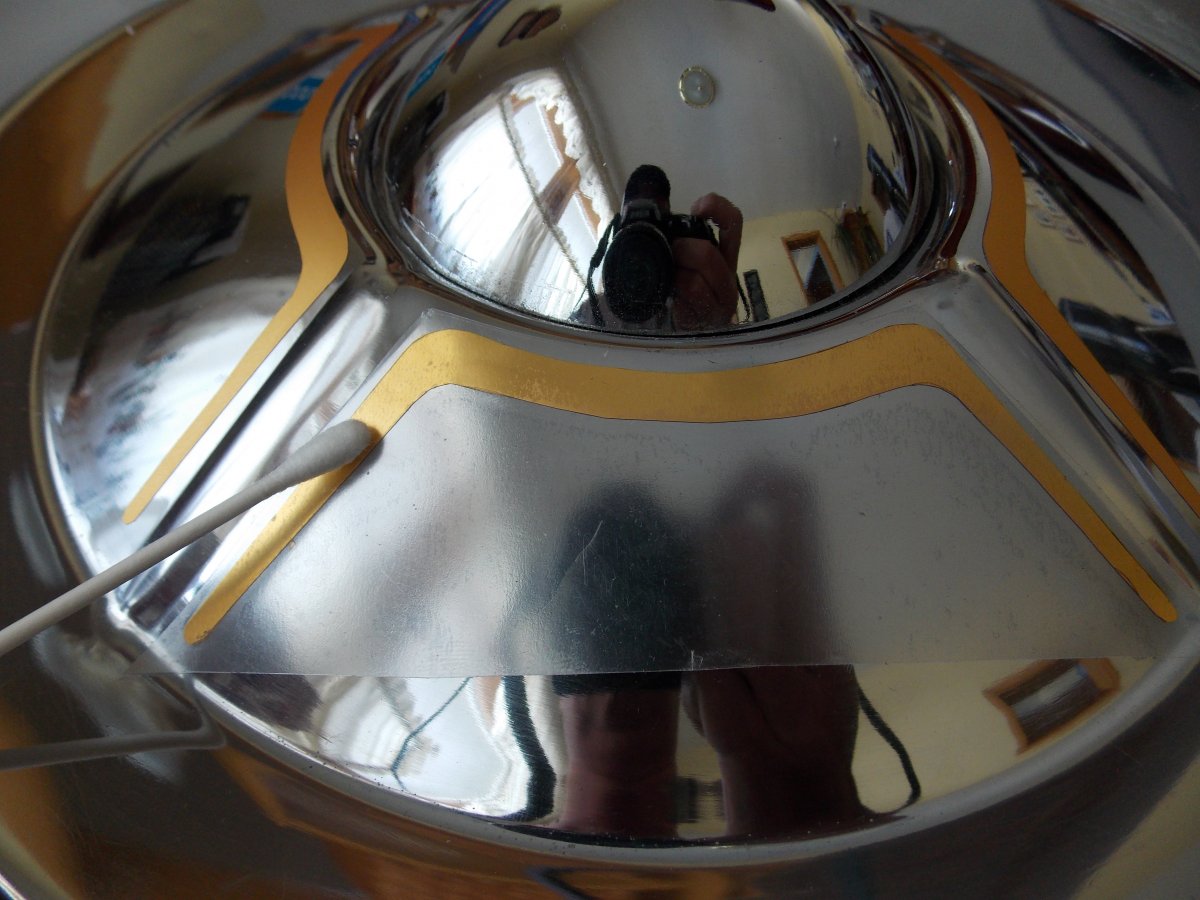

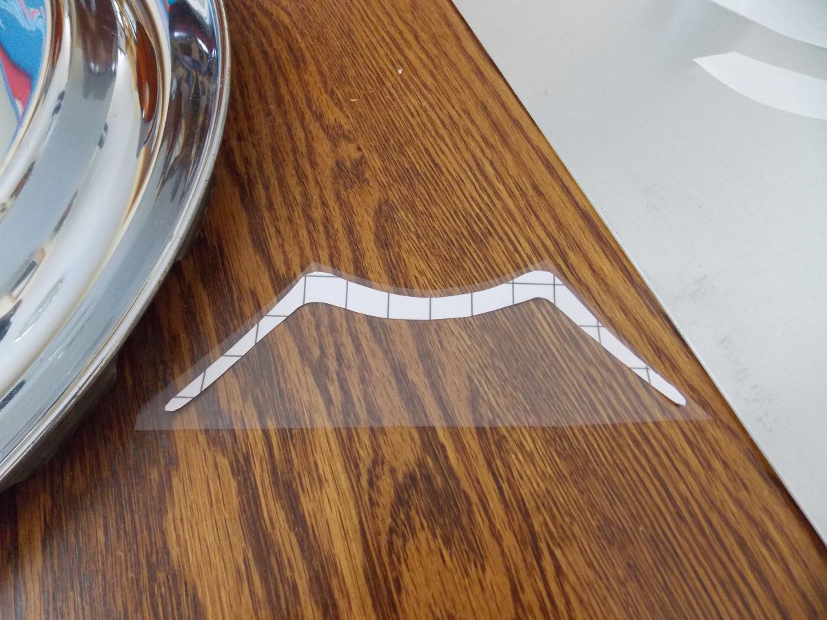

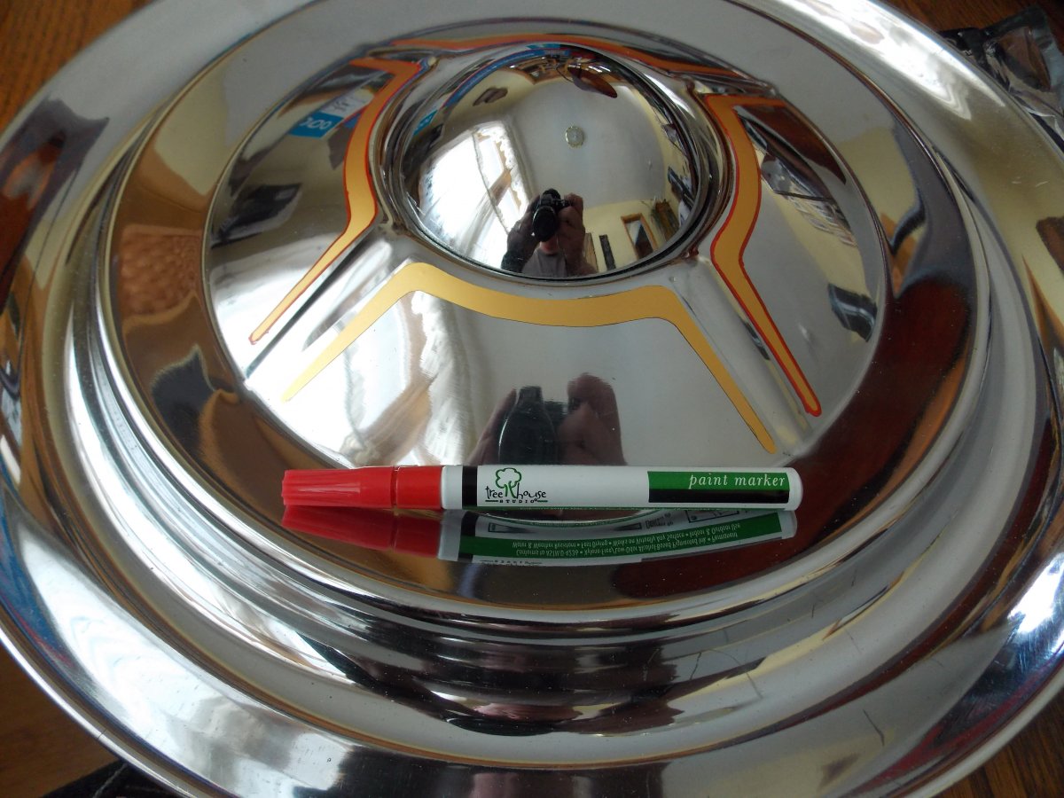

    Thanks 50Fraud, It was a process, but I had fun. Make the first pattern, transfer that to the matte bronze adhesive vinyl 8 times. (I only did two, back ones are under the skirts). Then apply frisquit paper to the color side, peel the backing and "eyeball" the piece into place. Burnish and then paint pen. (normal car guys would get out the One Shot and their best brush:)) DSCN2294.JPG DSCN2297.JPG DSCN2300.JPG DSCN2301.JPG DSCN2302.JPG DSCN2304.JPG DSCN2305.JPG DSCN2307.JPG

    The closest bullet size for the 54 Imperial wheel cover doesn't quite fit down into the recessed center area so had to take the back of the bullets to the belt sander. Probably the biggest reason I only made the two for the front.

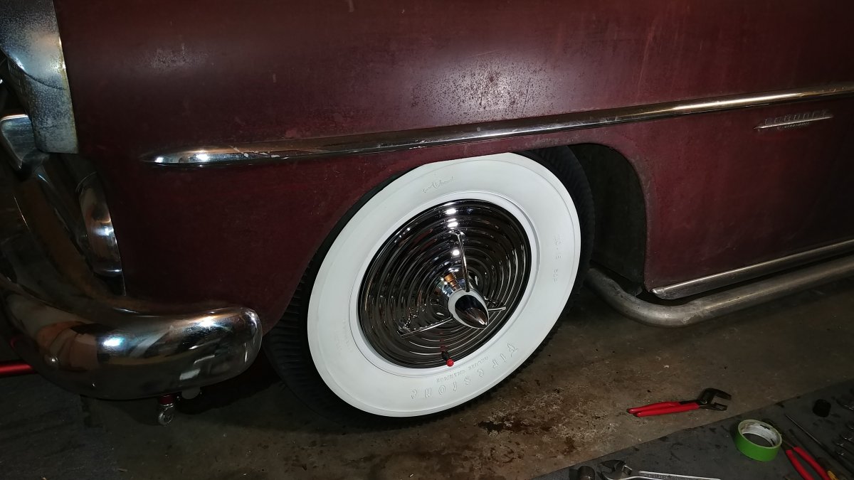

  21. I think Mick's (@straykatkustoms) latest front hubcap creation on the driver's side of his Merc belongs in this thread. Saw it in person a few days ago in Salina. Very cool!
    Pic courtesy of @54delray. Thanks for posting it Bill! E

    Thanks Ed for posting the picture and kool that ya liked it. I had an extra Jack Hughes cap and I thought about seeing what I could make out of it. This one is a 55 Oldsmobile wheel cover with the claws from a '64 Buick Electra with 57 Lincoln center and a bullet. Going to end up painting inside the claws a Kandy gold to make the claws pop. Wheel covers are a lot of fun.
