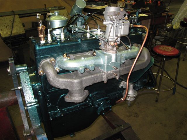

    I found two colors in Ford Taurus paint charts that were close to the original colors Arthur used on the Raven and had single stage mixed to gun spray and also had some stuffed into rattle cans. There was a dark green and a lighter, silvery green.
    I just cleaned the motor real well and used a high temp engine primer (in a rattle can) to lay down a base. Then the color with a gun. I think I put on about three light coats; not too heavy but enough for good coverage. I used rattle cans for the little pieces, touch ups, etc.
    I've been using regular single stage acrylic enamels for years with excellent results.
