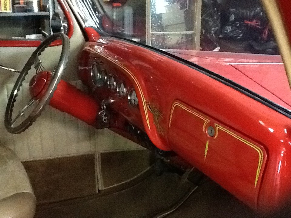

    image.jpeg I used 1/4 inch vacuum tubing split with a razor blade to fill the gap, stretches nicely and has been in place for 10 plus years.
