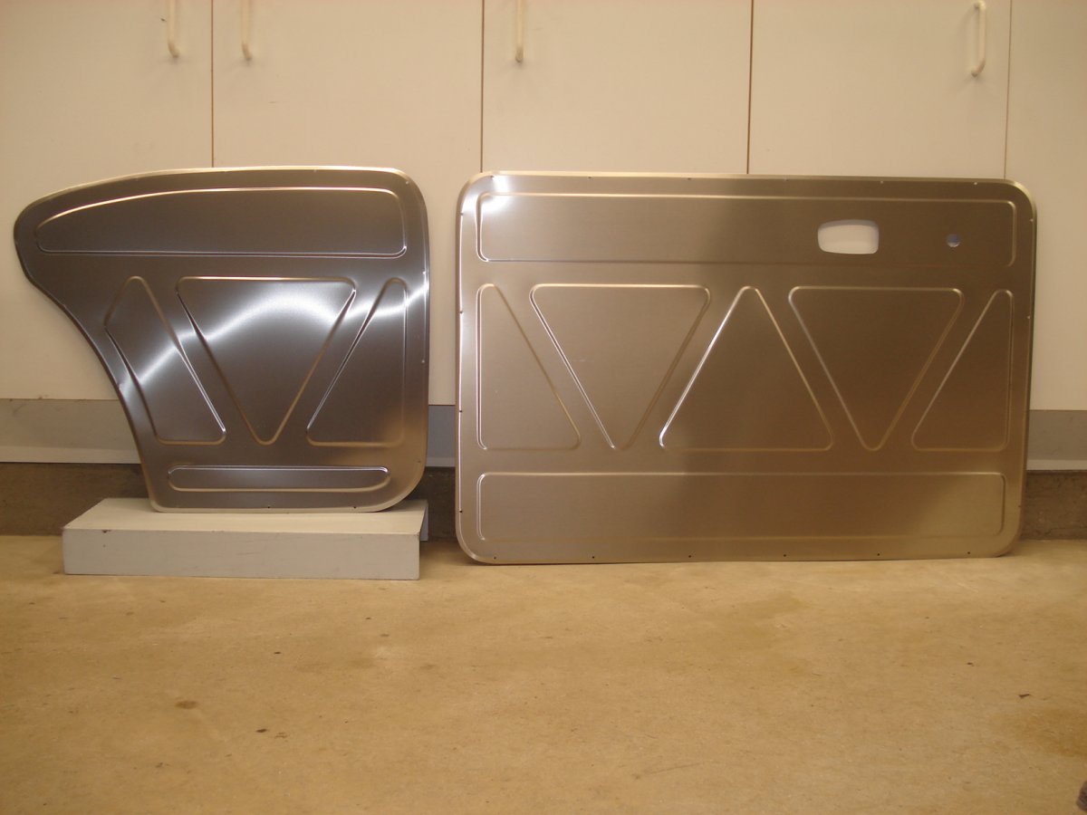

  10. BAILEIGH INC
    Joined: Aug 8, 2008
    Posts: 3,629
    BAILEIGH INC
    Alliance Vendor
    This is from a customer of ours in Germany

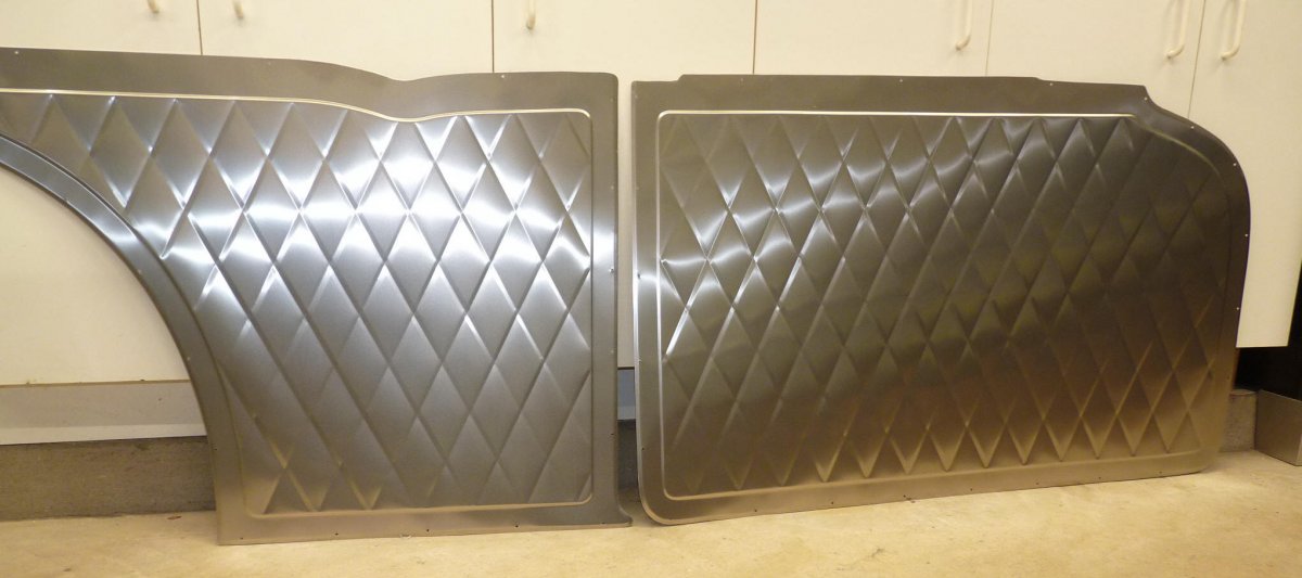

  11. heyitsnate
    Joined: Apr 8, 2004
    Posts: 1,750
    heyitsnate
    Floorpans! 1936 ford

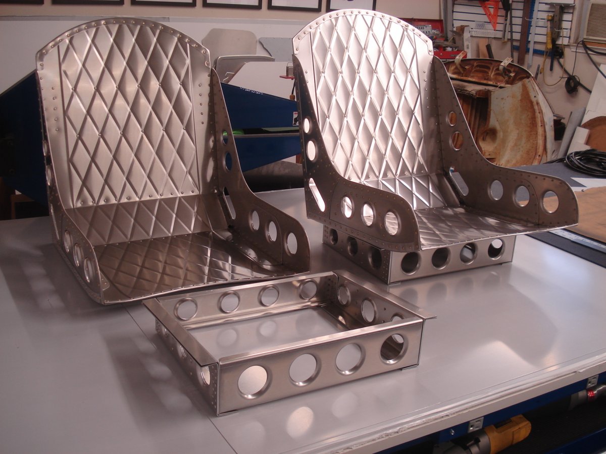

  14. BigWigRaceCars
    Joined: Aug 7, 2006
    Posts: 171
    BigWigRaceCars
    from Austin, TX

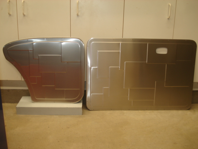

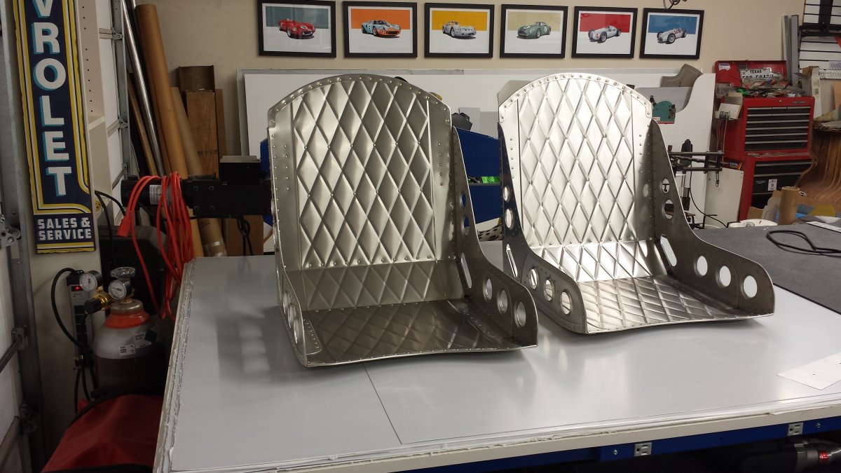

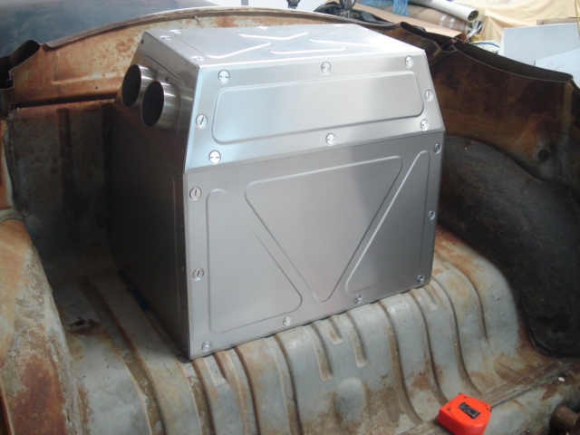

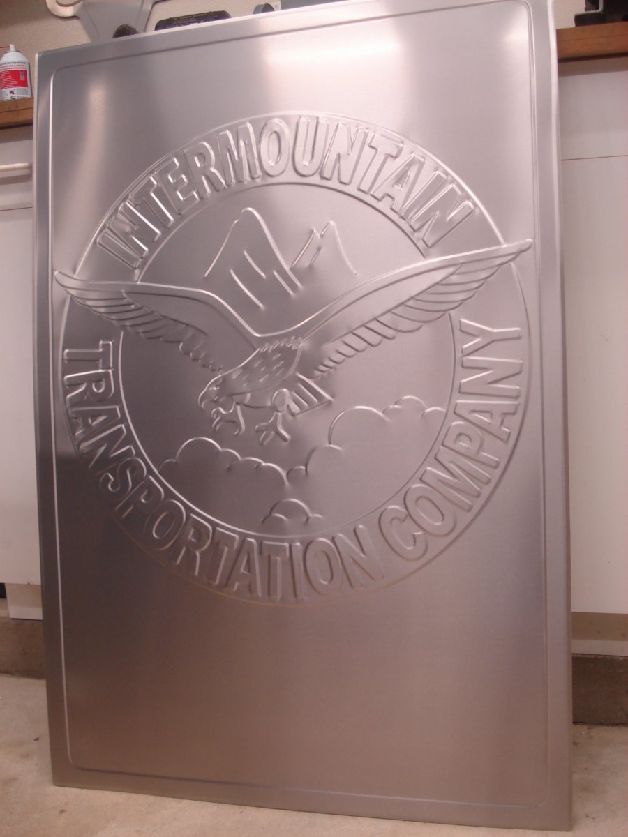

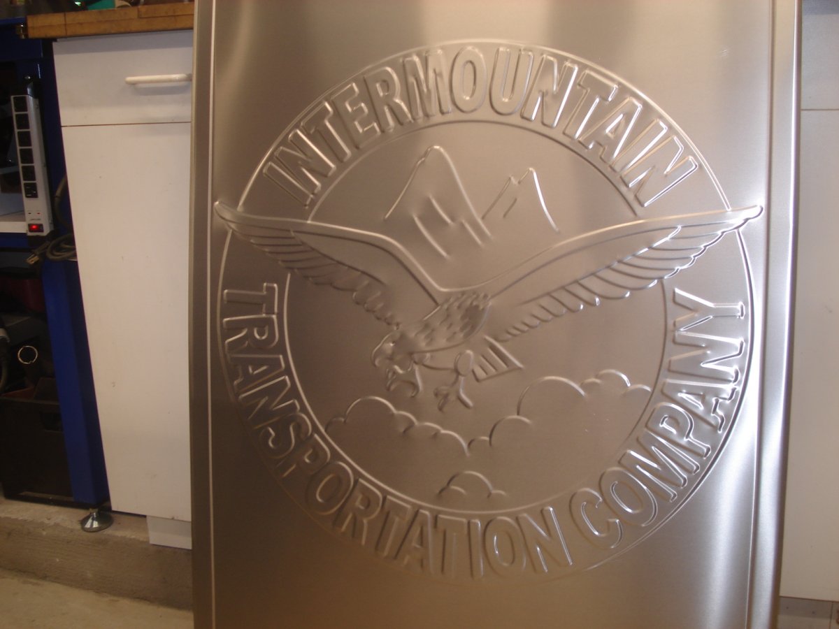

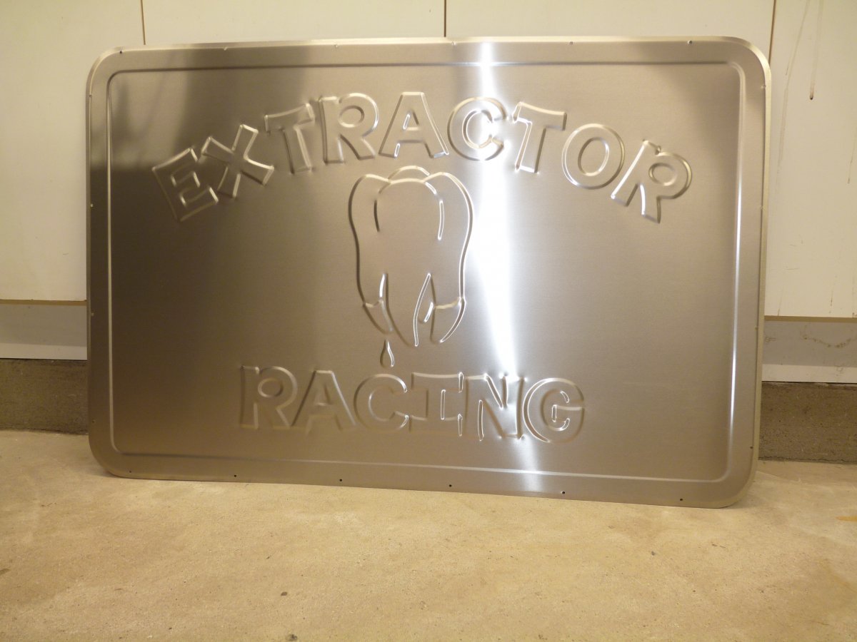

    Some recent work:
    diamonds_door_quarter_2.JPG Brad-Ocock_dragster.JPG pleats_with_VW_logo_door.JPG extractor_racing_door.JPG 405_door.JPG intermountain_transco_3.JPG .
    iagsxr, LTM75110, 54reno and 3 others like this.
  15. brady1929
    Joined: Sep 30, 2006
    Posts: 9,375
    brady1929
    ^^^^Damn you are good^^^^

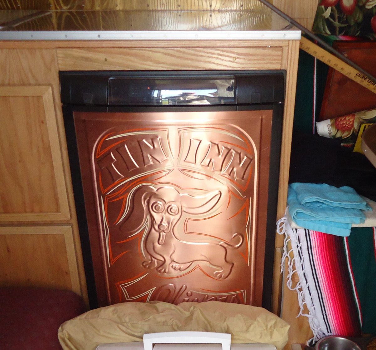

  19. 1lucky1
    Joined: Apr 19, 2009
    Posts: 1,259
    1lucky1
    from Morgan NJ
    Excellent work everyone, Allways amazed when I see the work,Love the Diamond type door panels, Would love to see them done in copper, then aged! Merry Christmas to everyone, Lucky

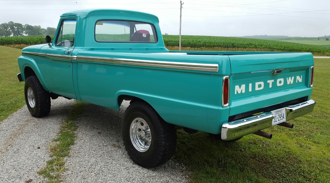

  27. Friend [Tony Humphries] did my door trims on my pickup. He is doing some pretty nice work from home in Perth West Australia. 20170121_162229.jpg
    Fern 54, JOYFLEA, brady1929 and 2 others like this.
