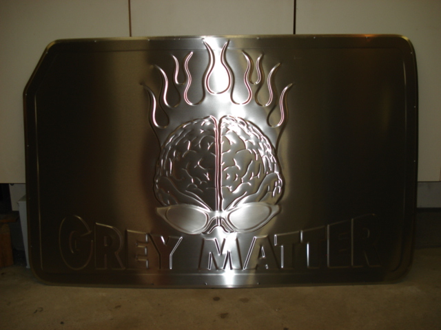

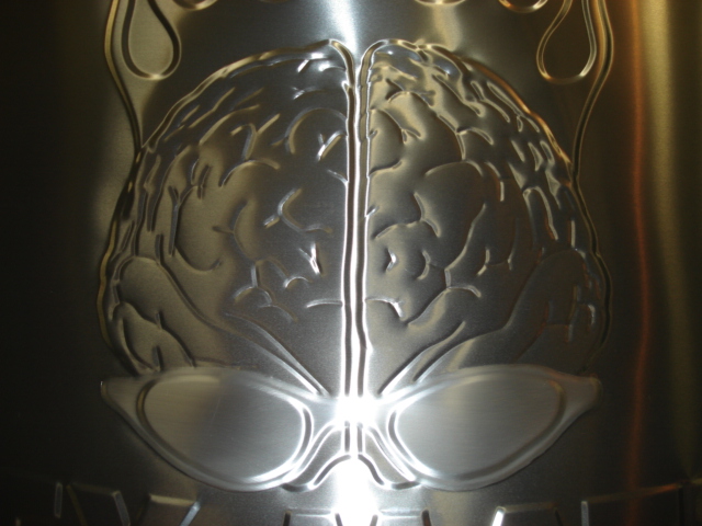

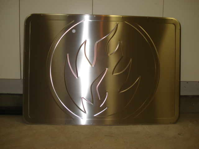

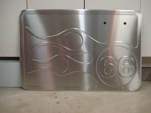

    Here's some new stuff and some not-so-new stuff to keep this thread going.
    Grey Matter door panels
    '66 door panel

    Just a dumb question fellas,when doing the quilt or pleats with a border or design what order do you do them in. Pleats first then border ,lettering ? I will post some of my stuff when the HAMB has a Comedy week, but I am improving.
  30. BigWigRaceCars
    Joined: Aug 7, 2006
    Posts: 171
    BigWigRaceCars
    from Austin, TX
    I do pleats first, then border. Since the pleats are so shallow compared to the border stip, by doing pleats first, you can get the pleat all the way to the border without running into the step like you would if you did the step first.
    I use that same pricipal for all the inner work too, like on the brain. I did all the inner lines (wrinkles?) first, then ran the step around the brain perimeter to define the edge.
