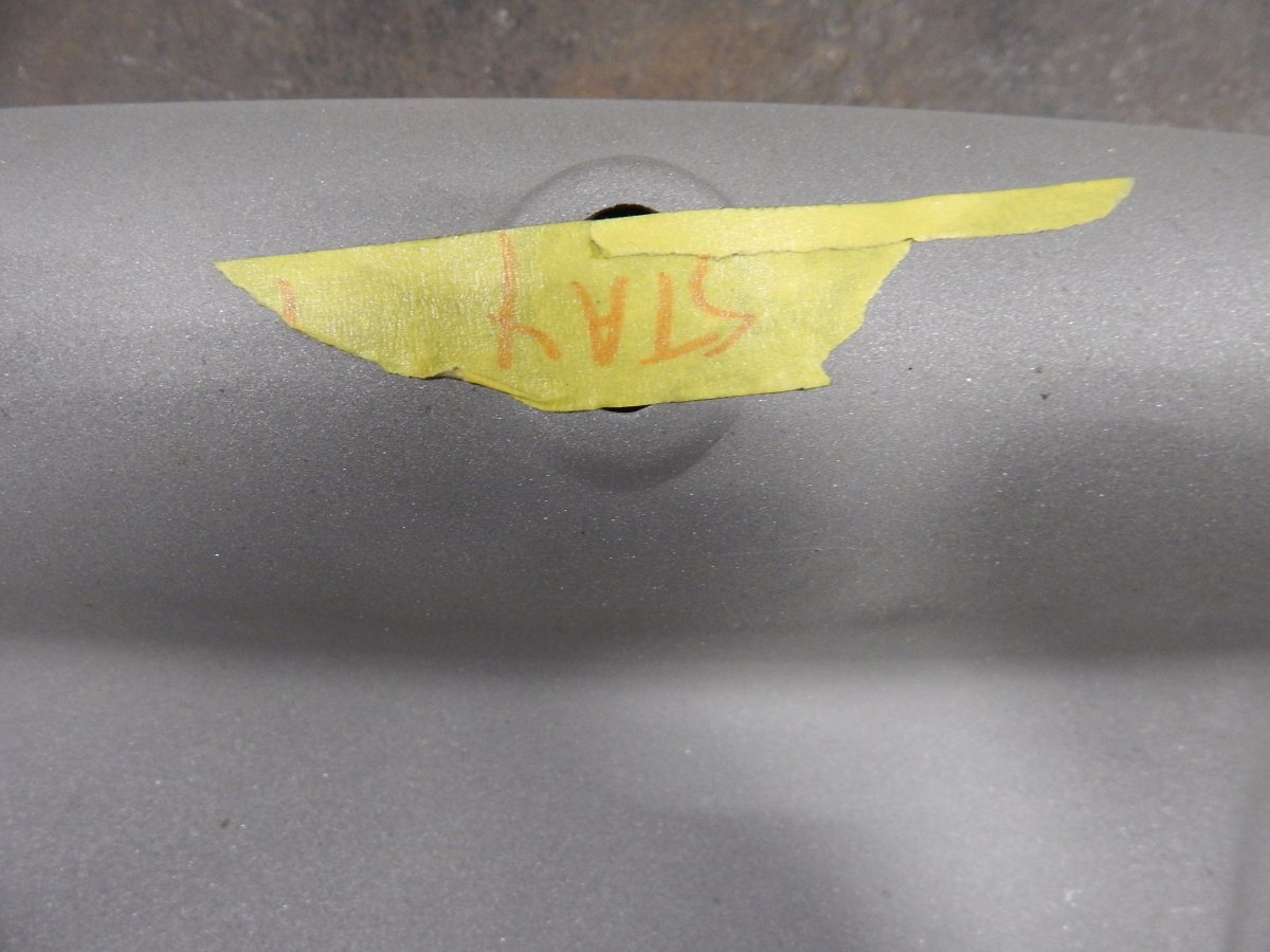

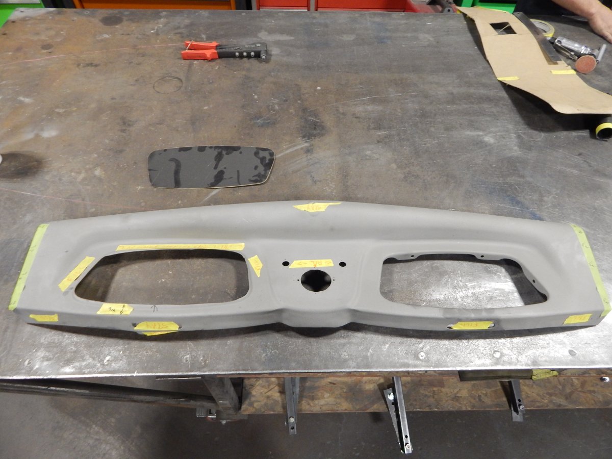

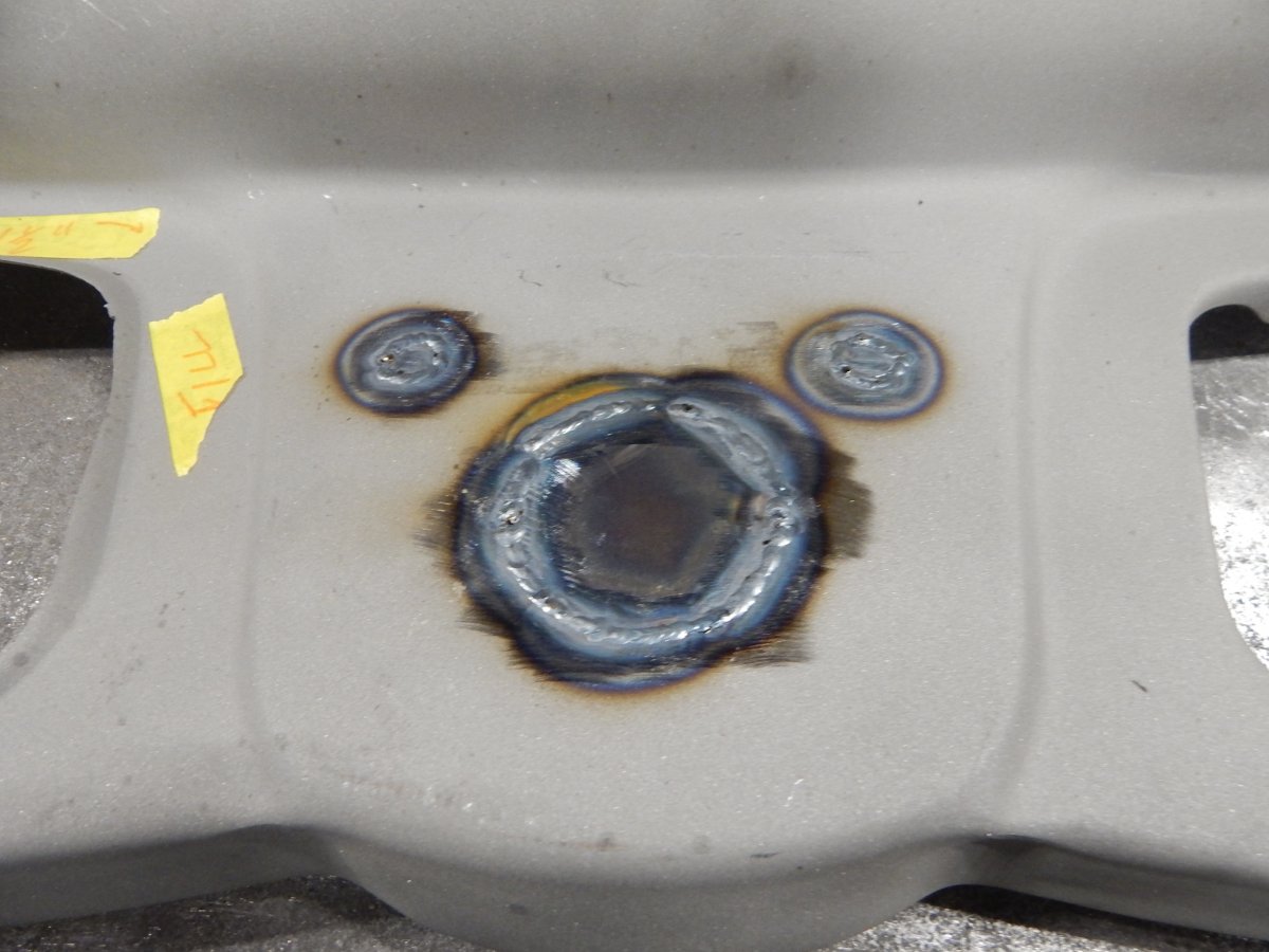

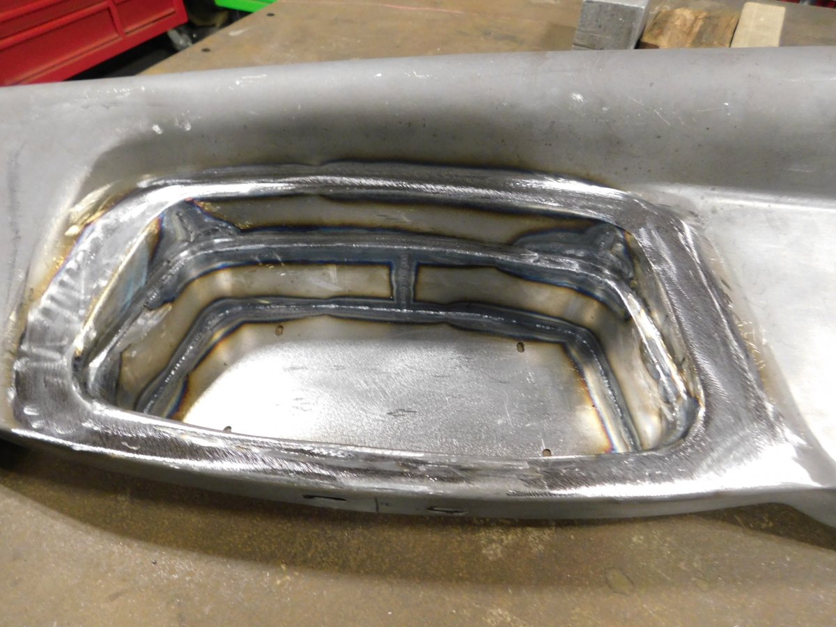

    Starting with the basics,filling unwanted holes. DSCN8181.JPG DSCN8182.JPG DSCN8183.JPG DSCN8190.JPG DSCN8193.JPG DSCN8195.JPG

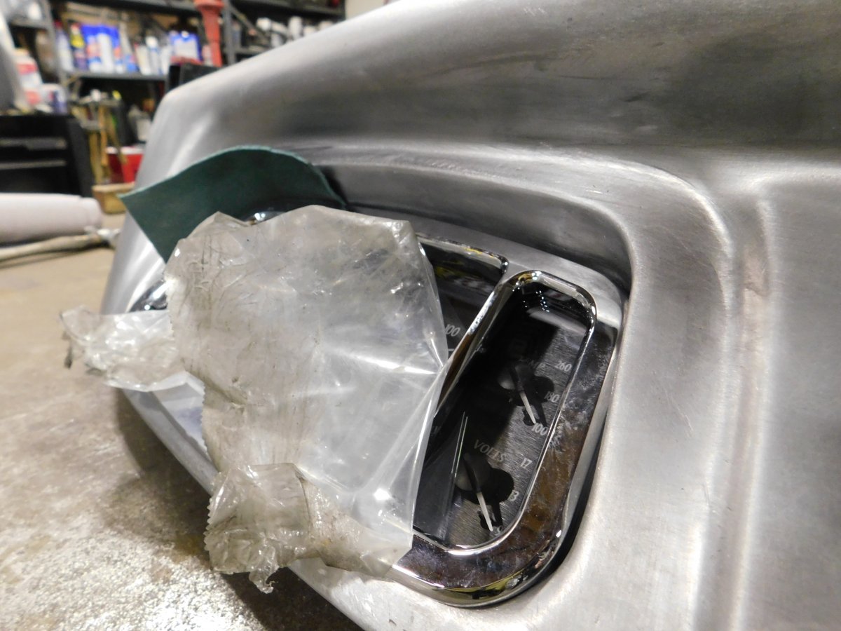

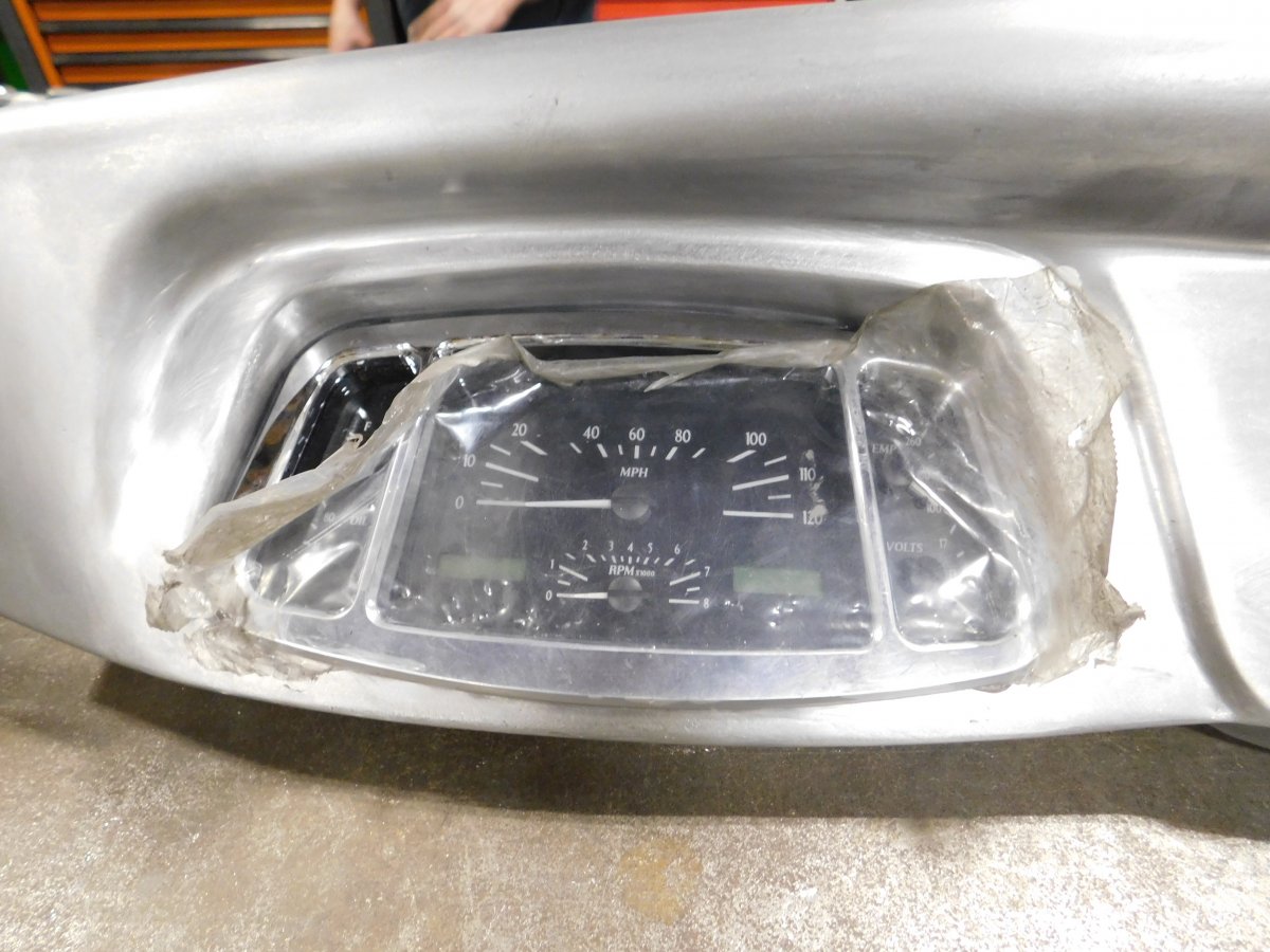

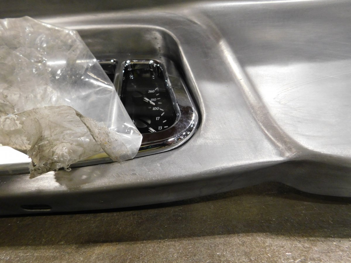

    Mock up of instrument gauge ,30mm angled drop.

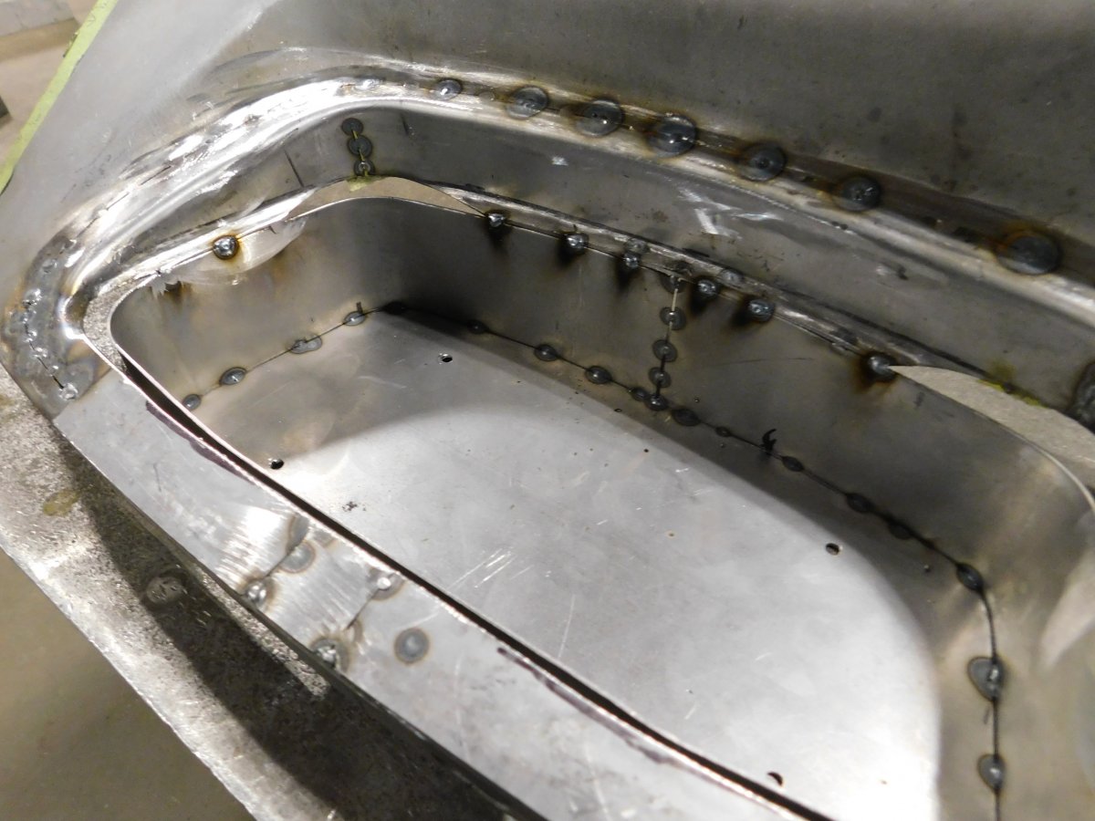

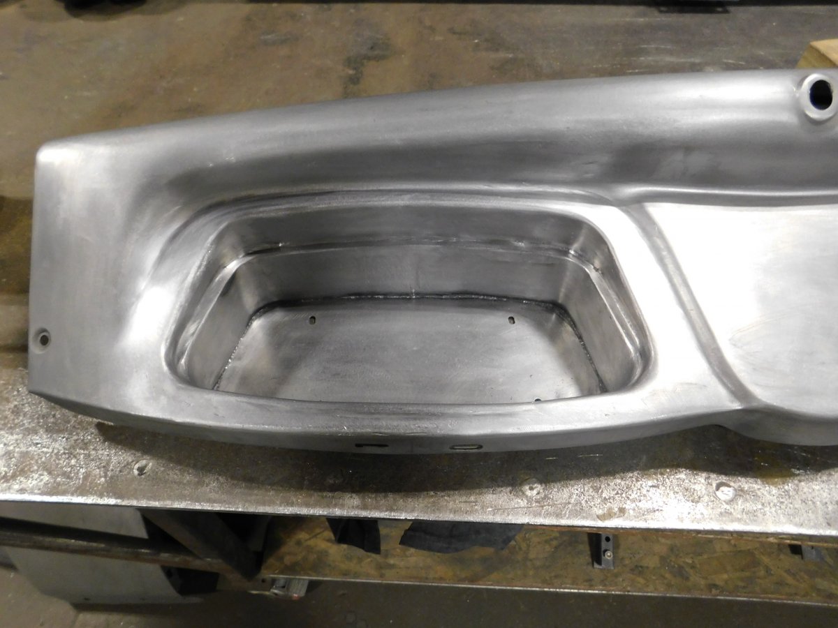

    as the dash is going to be wrapped in vinyl ,a gap is left between the bezel and wall of the dash. DSCN1905.JPG
