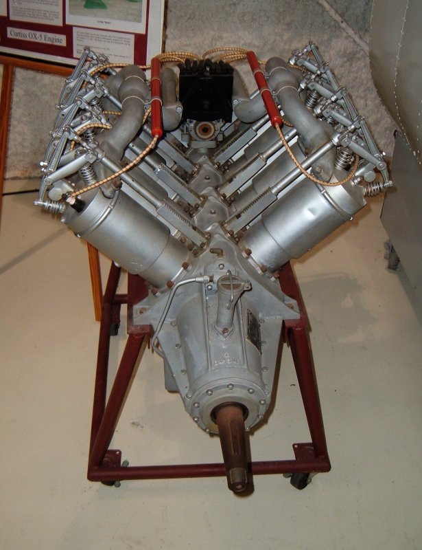

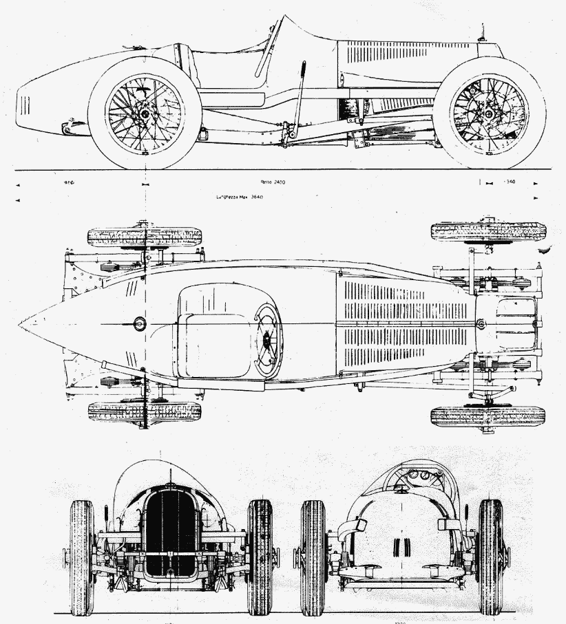

    Key to this project is the 503ci World War 1 era Curtiss V8 aero engine.

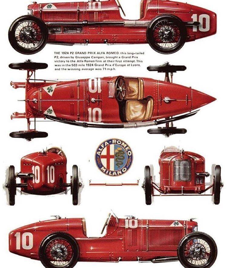

    The goal is to build an early 20s race car. We've identified the 1924 Alfa Romeo P2 race car as the "look" we're going for.

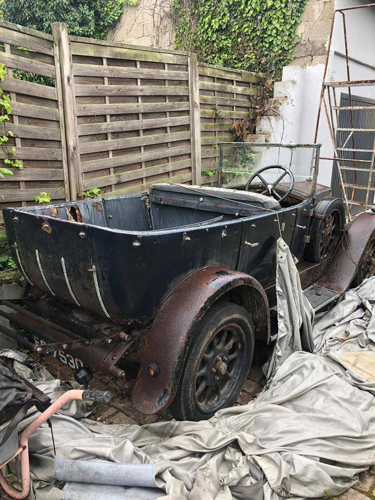

    Last but not least I found an interesting base to build the car on. It's a 1927 Fiat 503 Torpedo which has come up for sale locally. Sadly we won't be using the lovely touring bodywork or the original engine, but hope to find a good home for it.
    But it's got all the right ingredients. Longitudinal leaf springs, friction dampers, RHD steering and of course a title. Fiat built a lot of race cars back then, some real monsters too, so the mechanicals are appropriate.

    Apparently the Curtiss V8 is a popular transplant so there must be solutions to the drive train problem. OX-5_top_WL.jpeg 5eef29bb8a7a2cea98269ceb2cfc926b.jpeg IMG-20190509-WA0009.jpeg IMG-20190509-WA0017.jpeg

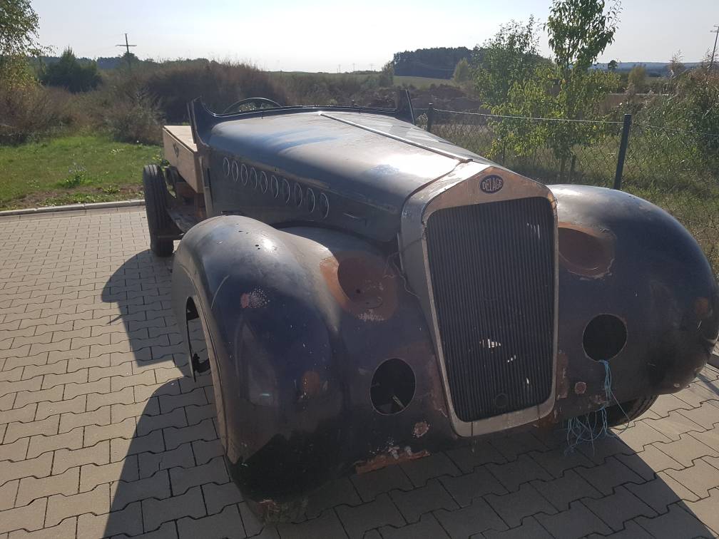

    Loads of cool stuff in Europe if you look. My buddy just found this Delage.

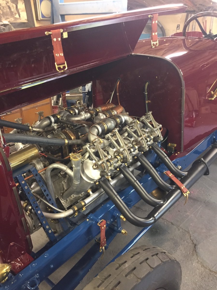

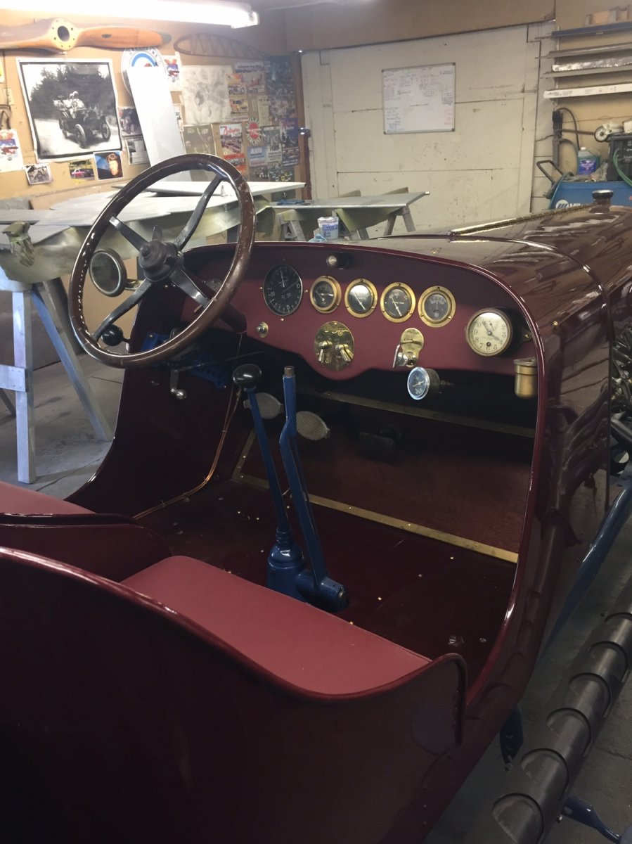

    It uses a divorced transmission and a one off flywheel / clutch setup mounted to the tapered crankshaft output

    The chassis is from a 1914 Velie touring car 120” wheel base including front and rear axles The transmission is from a 1913-1914 Cadillac .

    1924 Alfa Romeo
    1927 Fiat 806 Corsa
