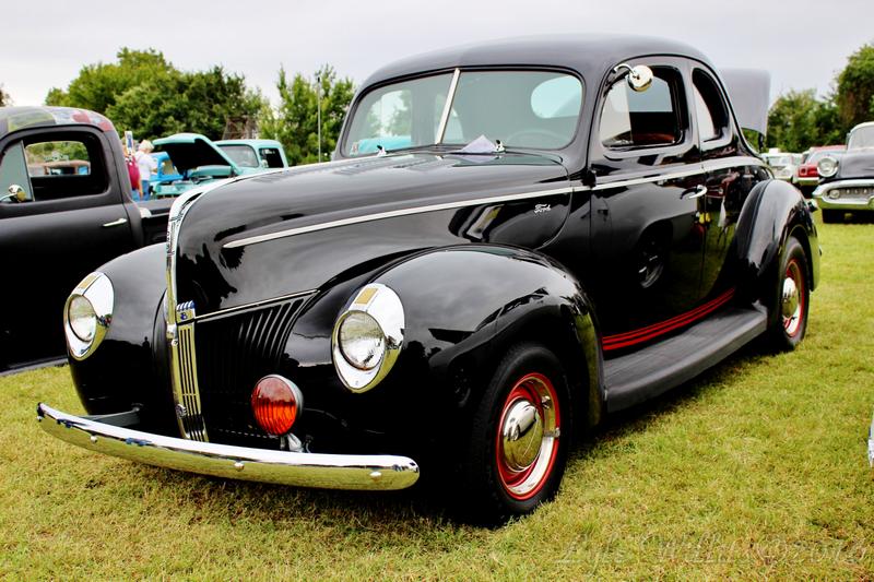

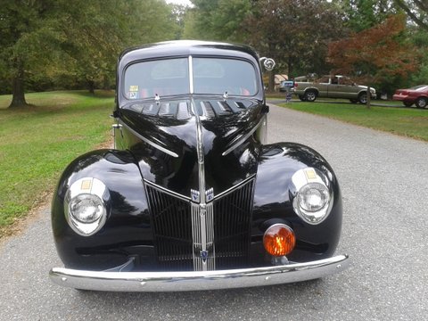

  15. 78 louvers, I've been caught in torrential downpours before and my fuse block is on the firewall! The faster you drive, the less rain gets under the hood.:D 2013-10-22 13.06.45.jpg 2013-10-22 13.06.14 (1).jpg IMG_0287-vi.jpg
    edcodesign, pitman, XXL__ and 10 others like this.

  17. .............................Thanks, man. It's just an old hot-rod, been one since at least the late 60's. The pictures make it look better than it is.:(
