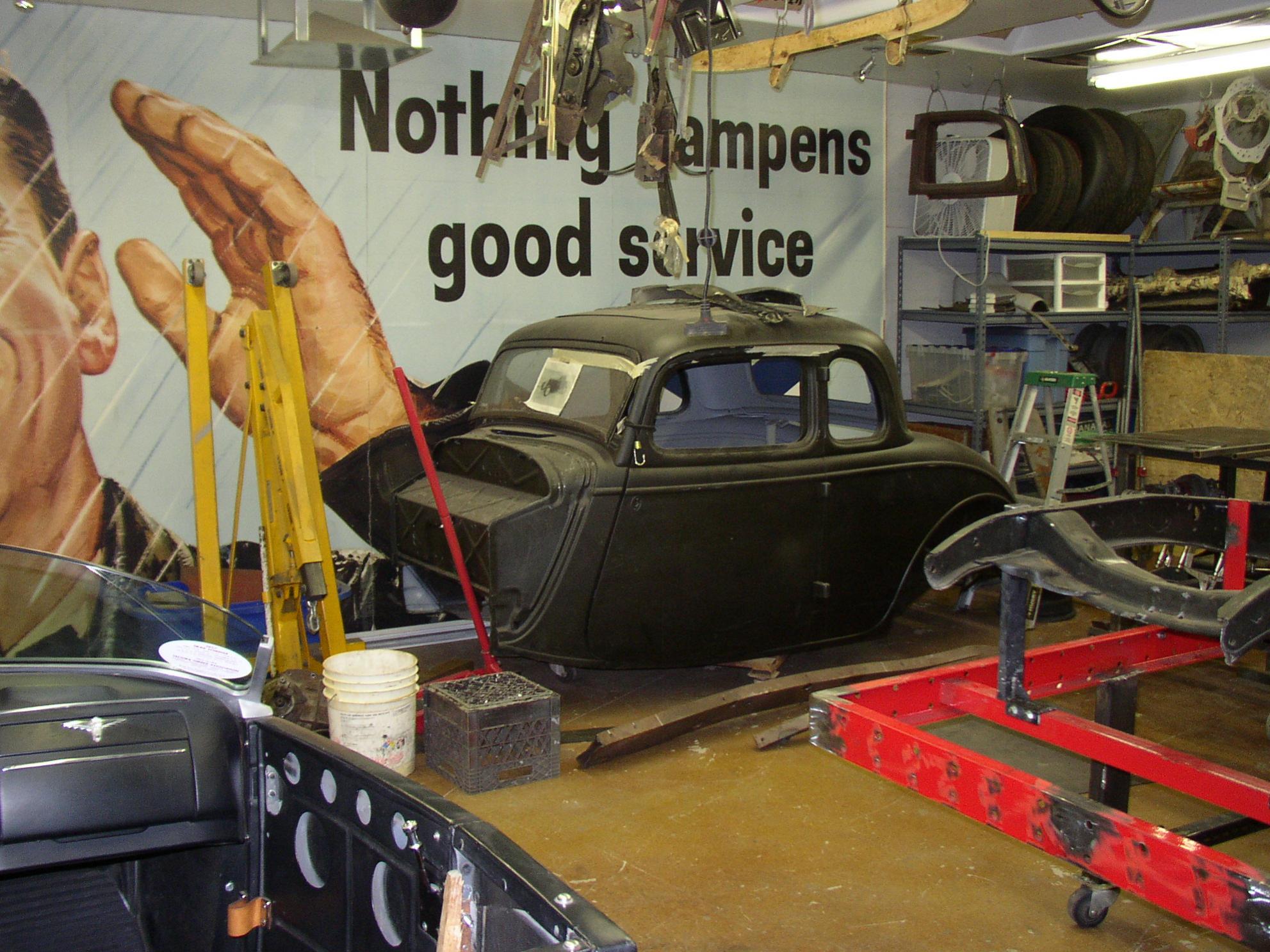

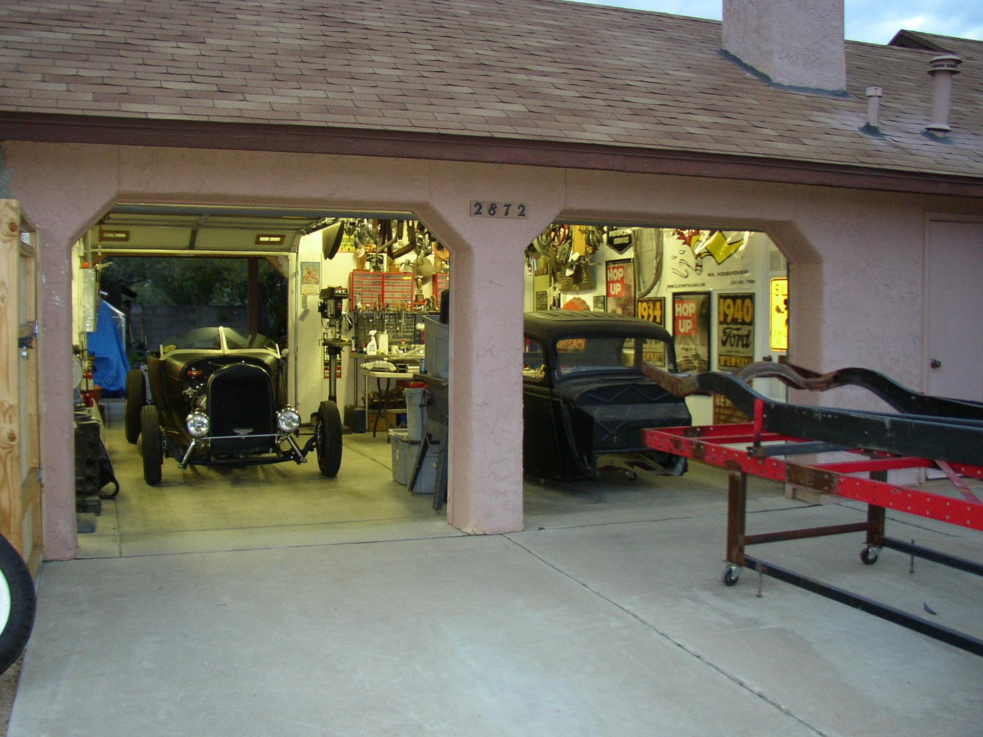

  1. Well, This thread is a long time in the making. I have had this coupe project for about 5 or 6 years now. Been gathering parts for what I want to build. It is going to be a late 50's -early 60's Bonneville inspired build. I have been taking so many pictures of the stuff I have been gathering and working on that I figured if I don't start posting pictures soon I will never catch up. This project has taken a long time. Life. It seems to get in the way of our fun most of the time. I moved from Washington state to Tucson, Arizona after a divorce. I took awhile to get my shop setup for work. I lived at that house for about 3 years. During that time I met my current wife and and ended up moving to her house. That meant getting a new shop set up again. Time consuming to say the least. Now I have things set up the way I want for the most part and have been working on the frame.

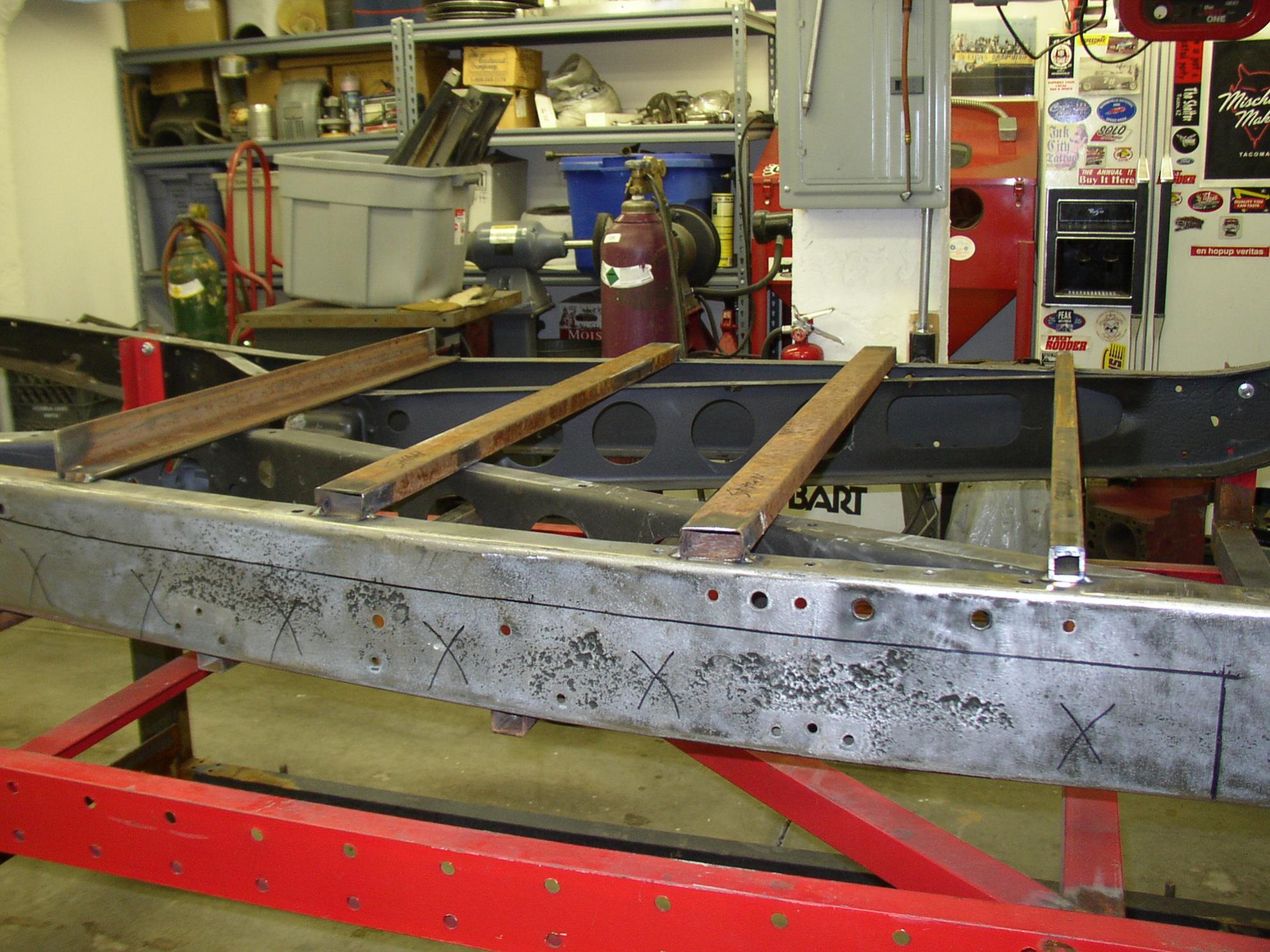

    My vision for this car has been a little different than most. I can never just do something the easy way. I always gotta do things the hard way. This coupe will be a hiboy and chopped about 5 inches. I sold off the fenders,running boards, and bumpers that were savable but pretty rough. I have never liked the looks of stock 34 frames. They have ugly front frame horns (in my opinion) and the side rails are pretty boring. Along with the fact that this car is not going to run the stock gas tank, the rear frame horns have to be modified to look right without it. I plan to put that in the trunk behind the passenger compartment. I decided that major modifications were in order to get this frame to look like something that good old Henry would have come up with if his cars had the option of no fenders and the frames showed like most hotrods.
    Now I want to start off by saying. I am not the perfect welder. I get the job done. I aspire to be good like Bass,Jimmy White, and some of the other quality builders here on the HAMB. I have a long way to go before that though. I use a mig for everthing that I do. I want a tig unit but so far the funds have not been there for it. Maybe next year.

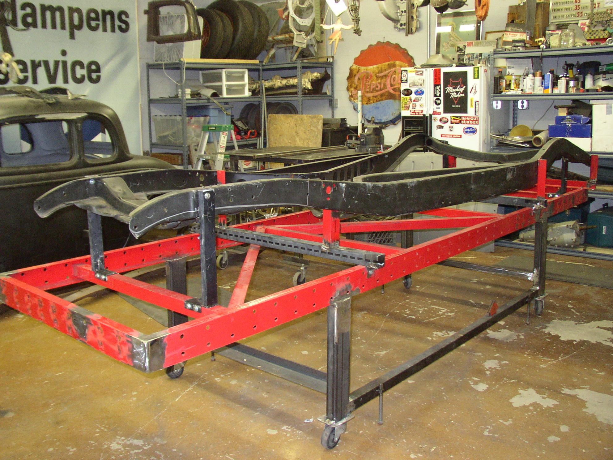

    I built a frame jig out of some pallet racking that I got free from work. This frame was completly straight and had never been hit. Only a few small issues to contend with . It had a lot of pitting on the side rails were the body contacted the frame and were the running boards were attached. That issue will be addressed later on in the thread. Now I have no idea how to post pictures and add text under each picture explaining every detail like some of the other build post. Maybe I'll figure that out later. I will start by posting pictures of the car as I got it and after I lost the fenders.

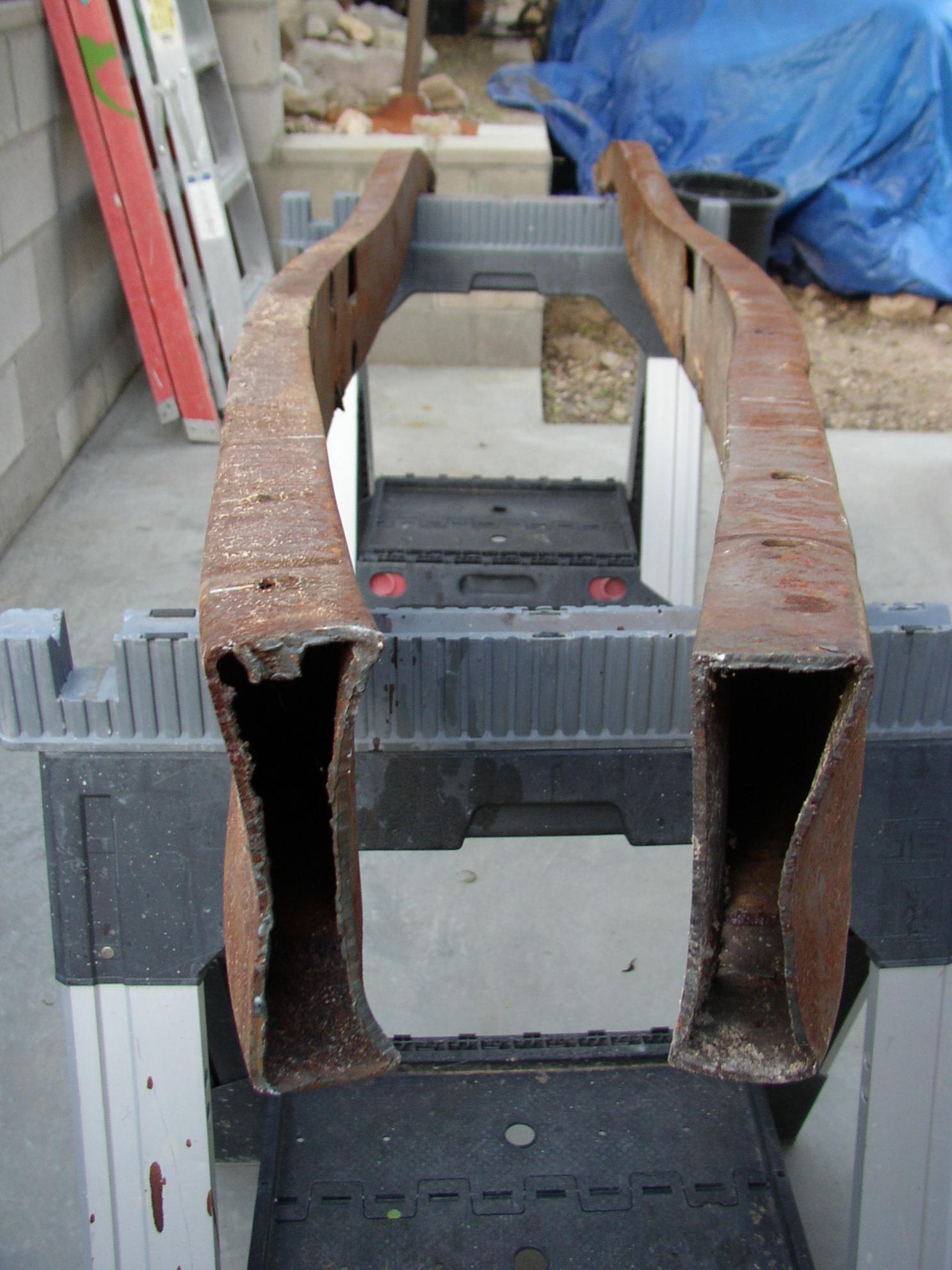

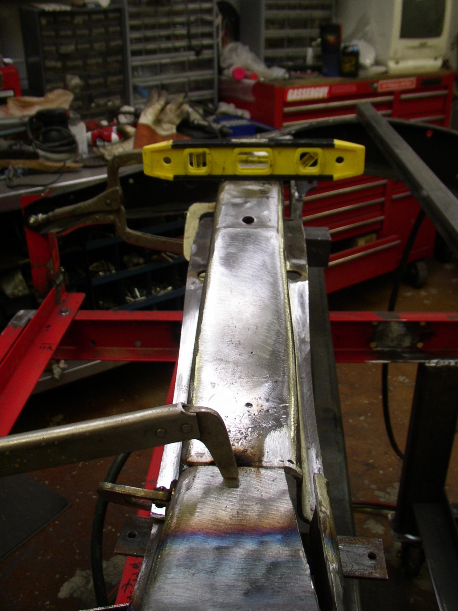

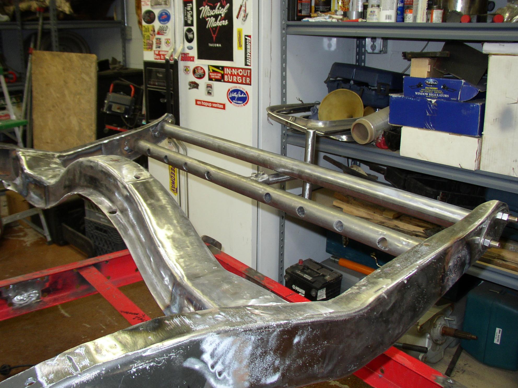

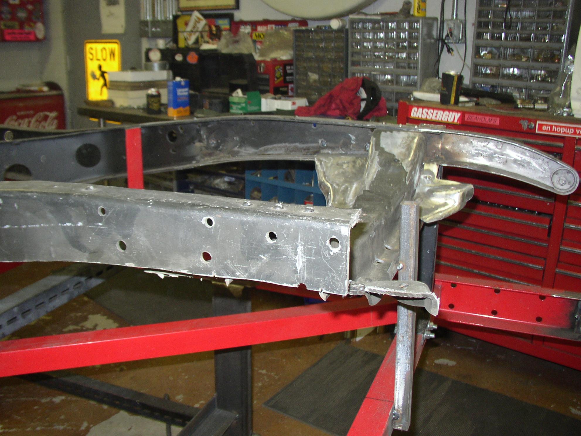

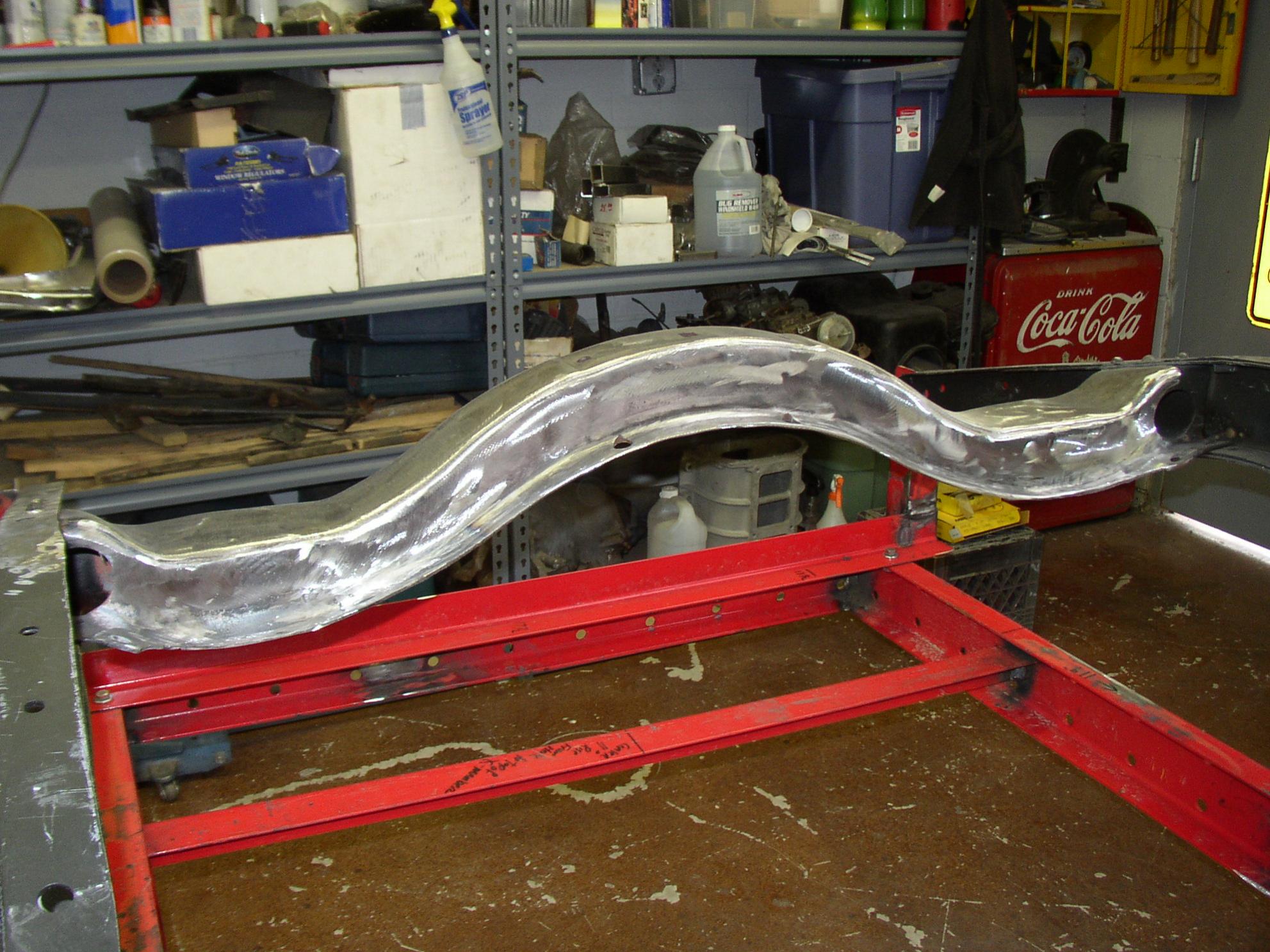

  3. I posted a thread last year on a tech week on putting a 28-29 Model rear crossmember into the 34 frame retaining the ends of of the 34 rear crossmember. I will repost the majority of those pics to keep things in line. If you have questions feel free to fire away. Most pics are self explanatory in nature. Here is the rear modification so I can use the Rodsville quickie
    ls1yj, mgtstumpy, Stogy and 1 other person like this.
  4. Eric, You really need to call me. I tried to call you awhile back and thought you fell off the grid. Eric has known me since my Washington days. I consider him a friend. Ok, Back to more rear crossmember mods. The bottom side of the crossmember will get finish welded and boxed for strength when I turn the frame over later.

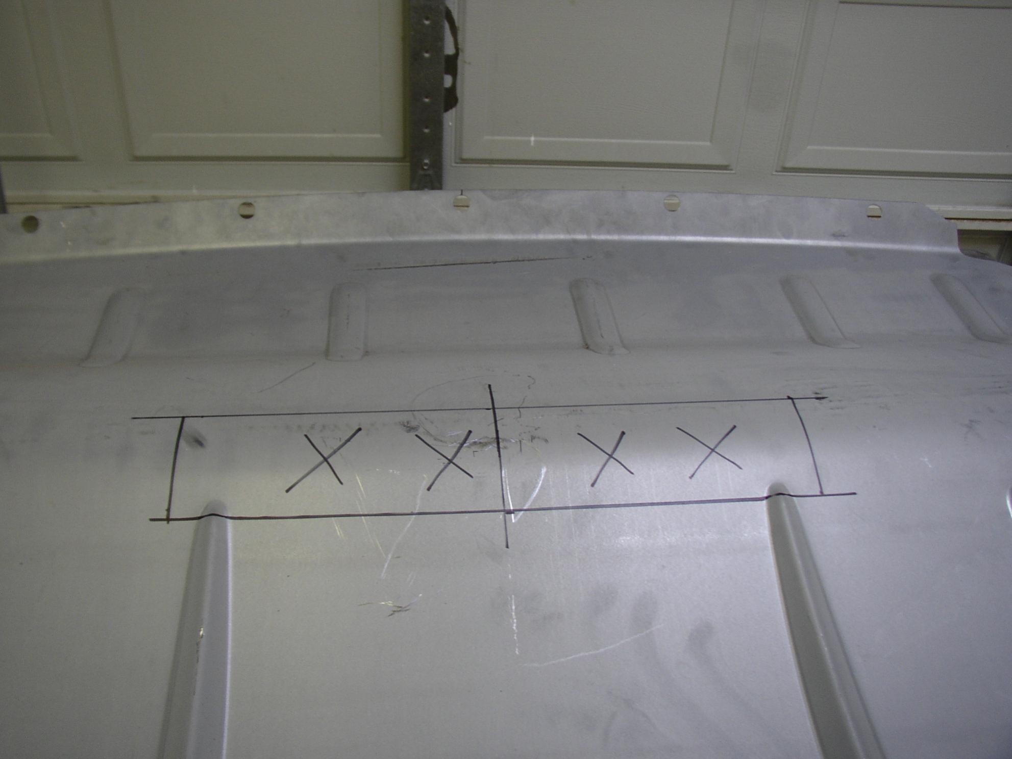

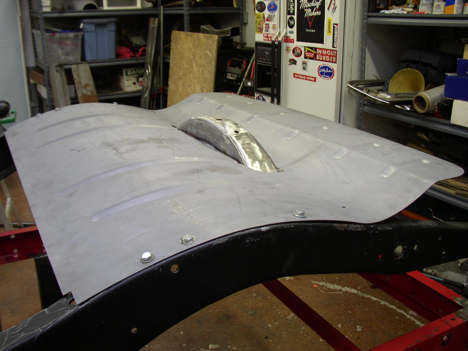

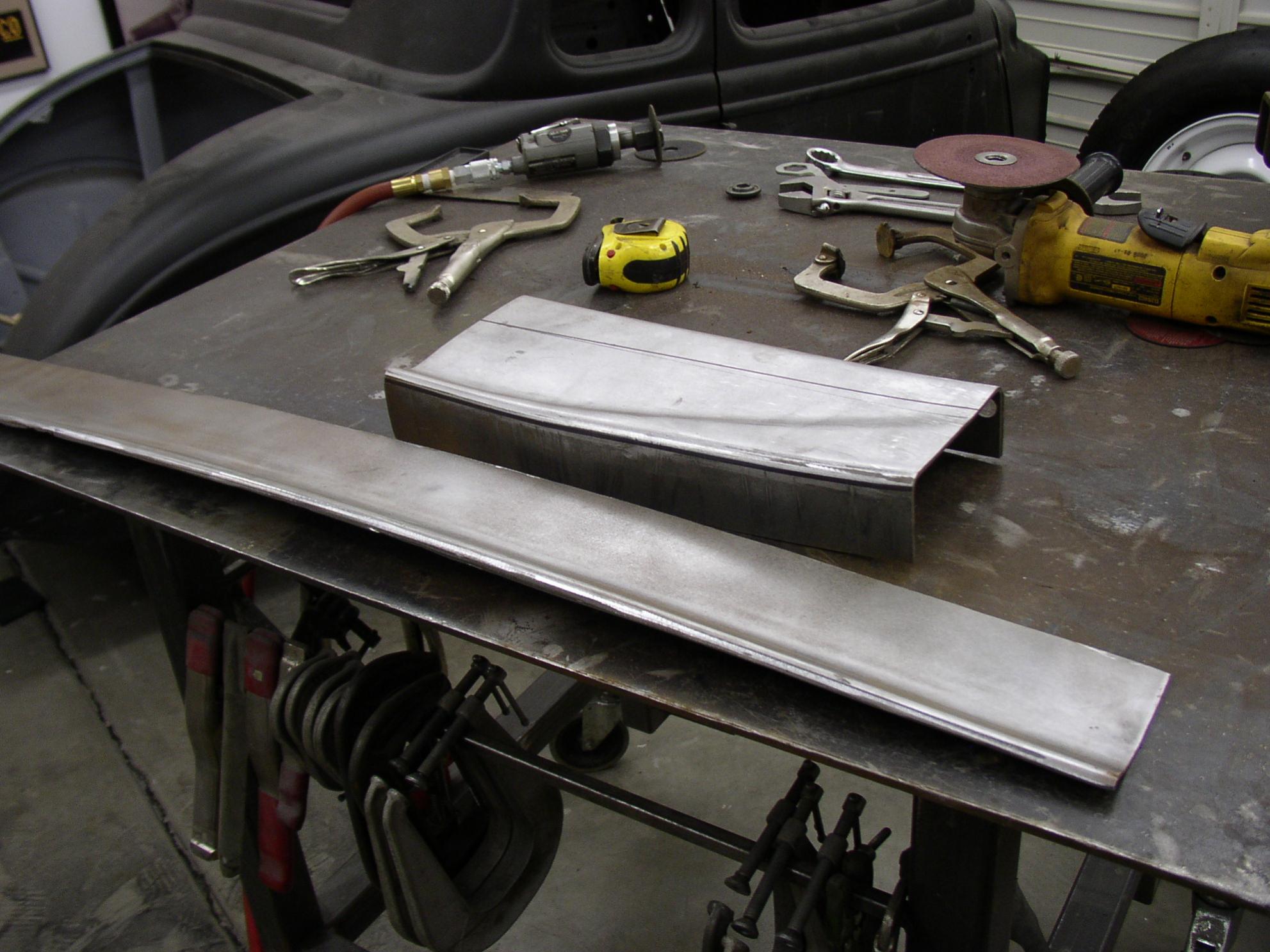

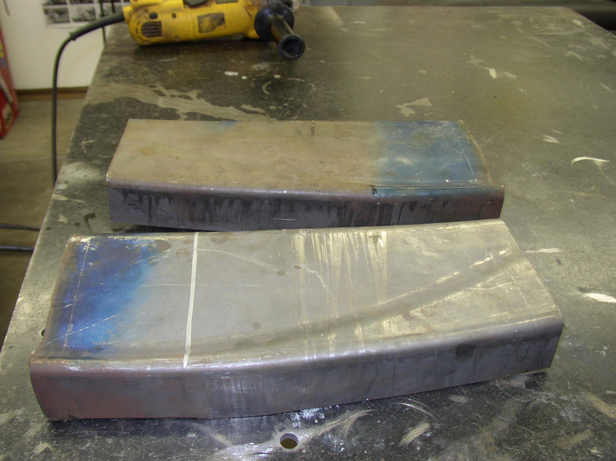

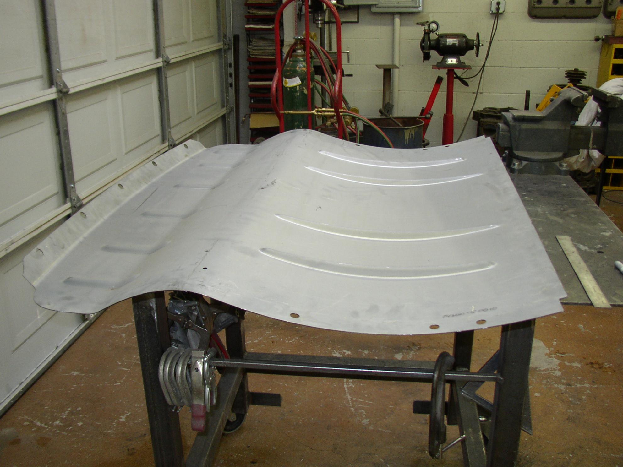

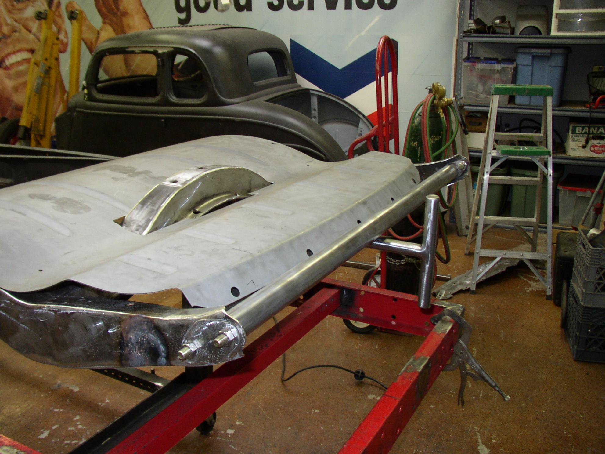

  7. Now I wanted to address those long rear frame horns since I would not be using the stock gas tank( I have the stock one for sale if anyone needs a pretty decent tank. Pm me. It will be cheap) I bought a new rear floor section from Steve's Auto in Portland Or. The rear portion of my coupe has been poorly fixed in an amatuer restoration job in it's former life. I will have to fix that later. The new rear floor pan would give me the the dims for making the changes to the rear frame horns. I deciced to pie cut the ends and bend them up to the desired height and I cut off the rear portions and switched them from side to side and flipped them over. This gives the horns a kinda high tail effect that I like but never have seen anyone do. Here are some pics.

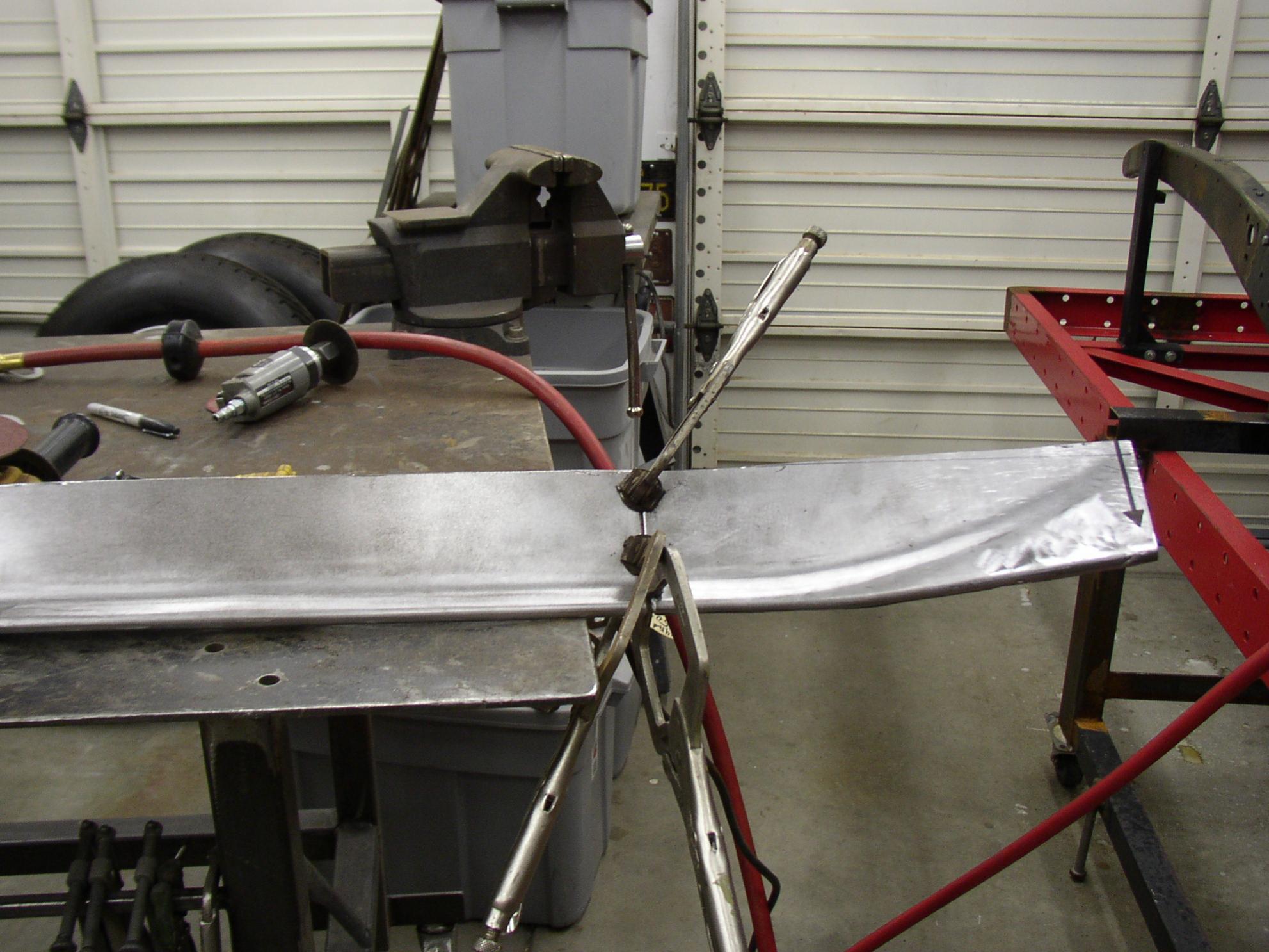

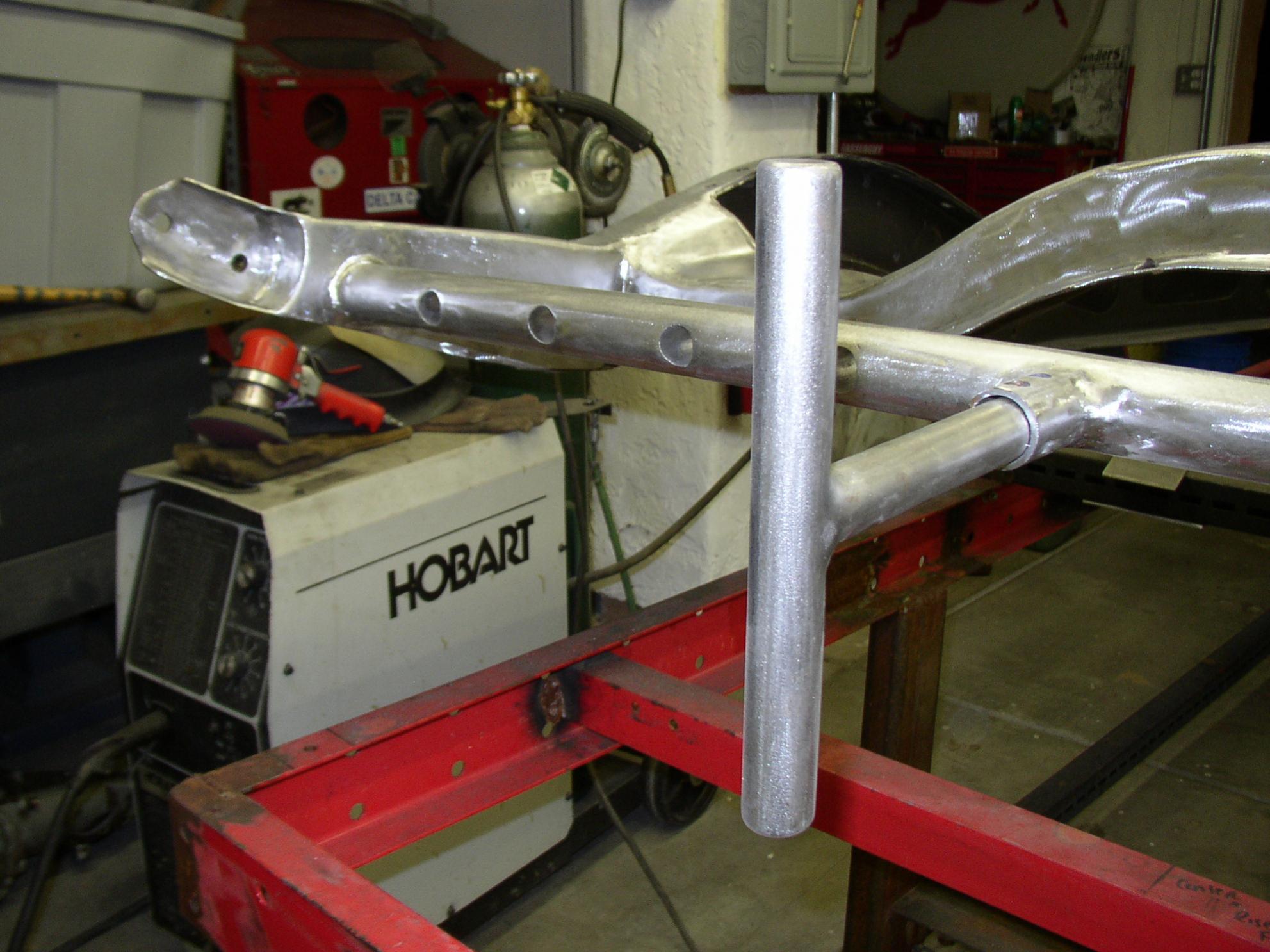

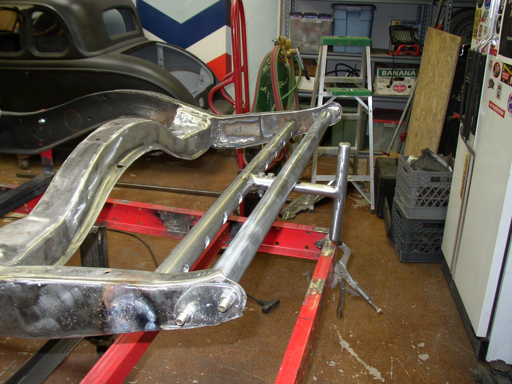

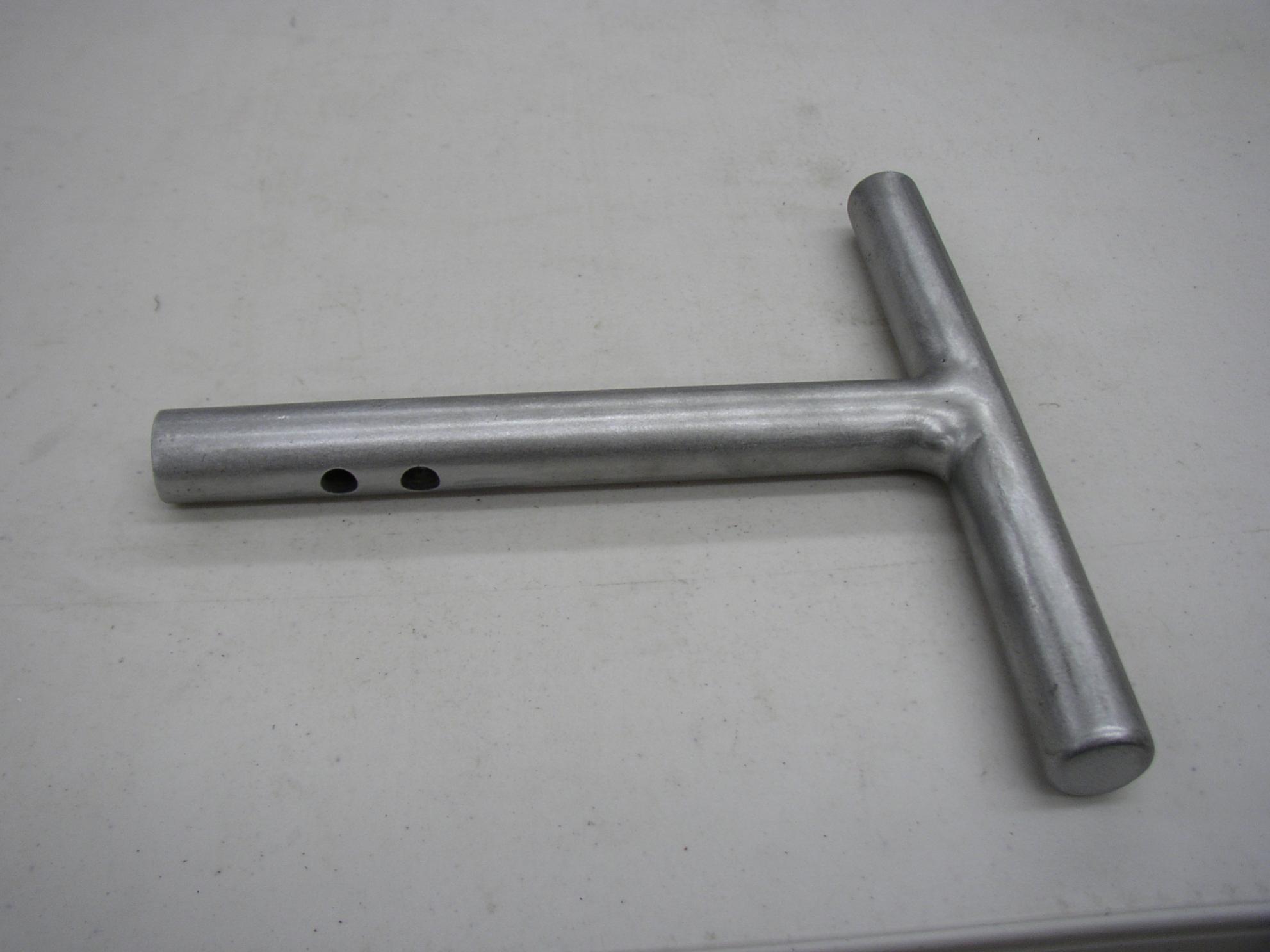

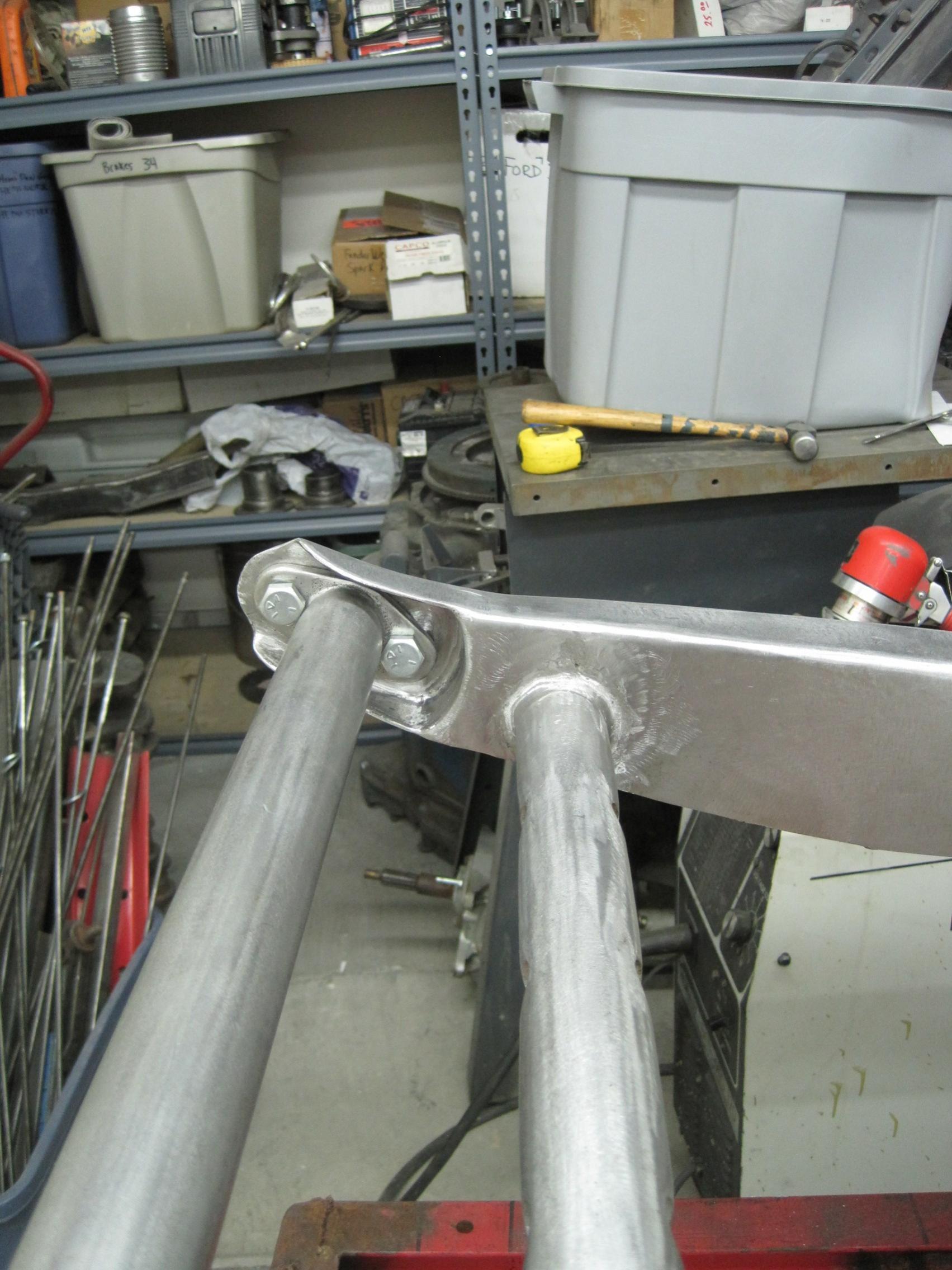

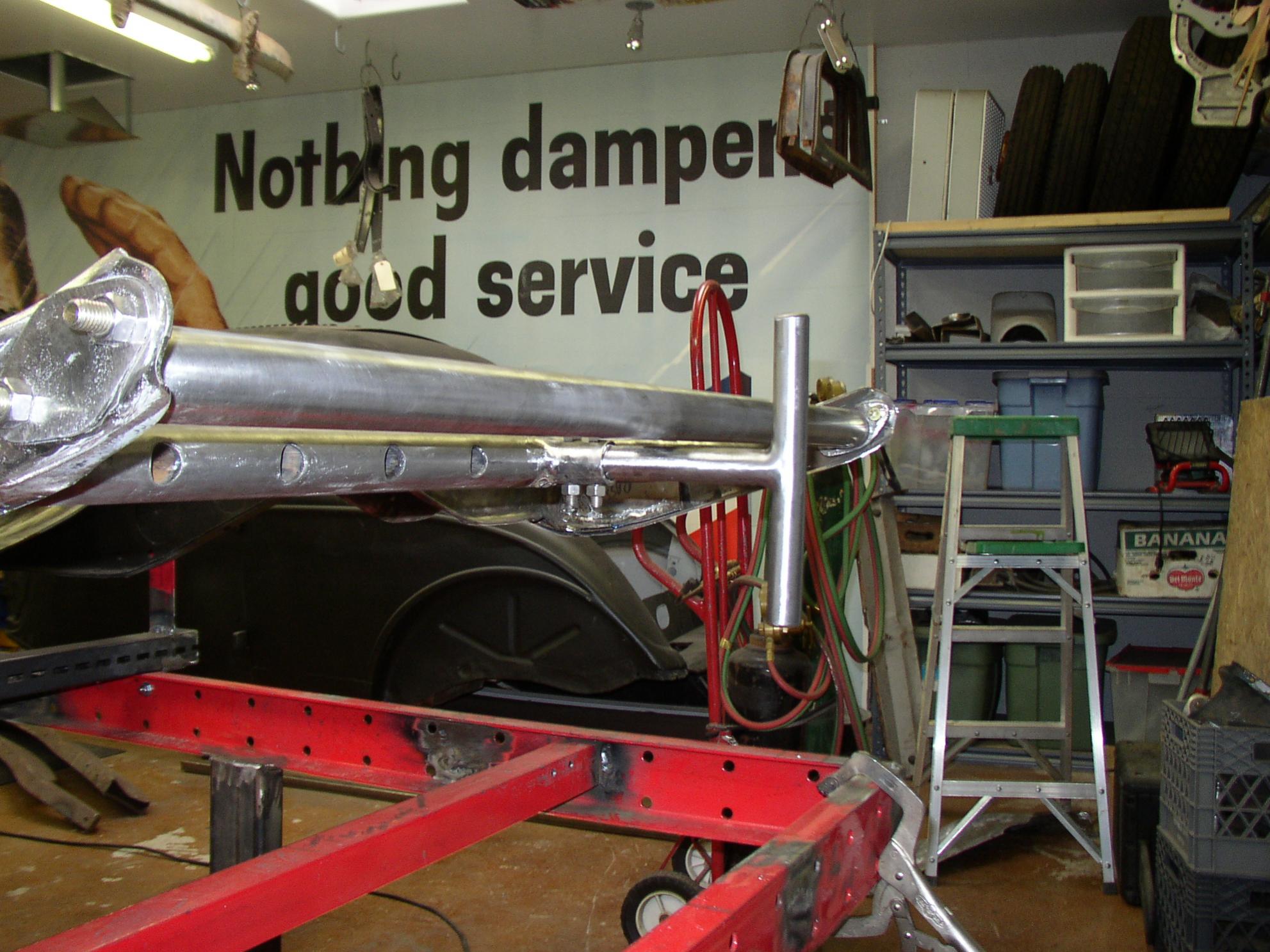

  11. I am going to try again and see if it will let me post more rear frame mods. I added a rear spreader bar made from the stock one but modified and a bar to mount my push T bar of.

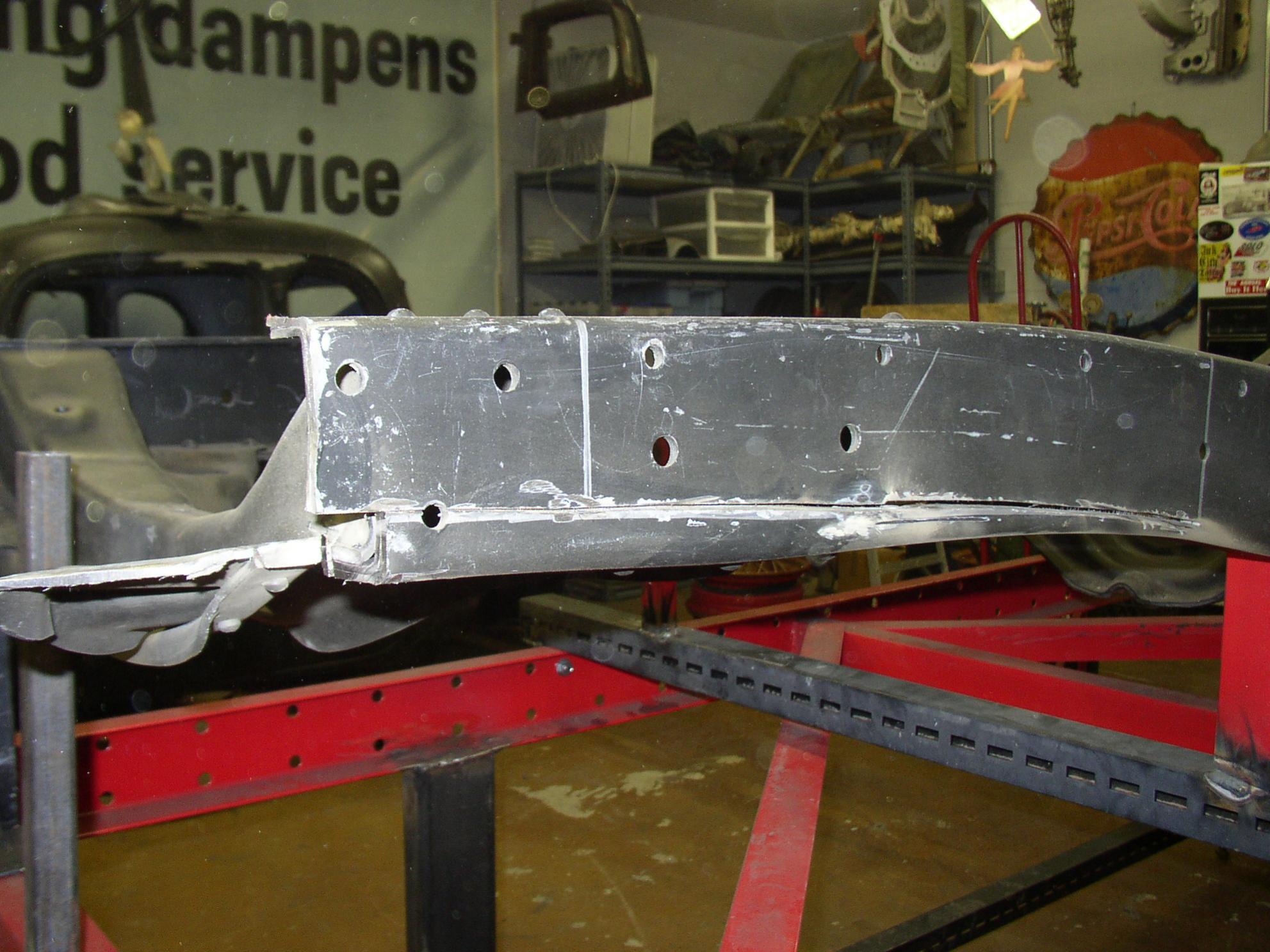

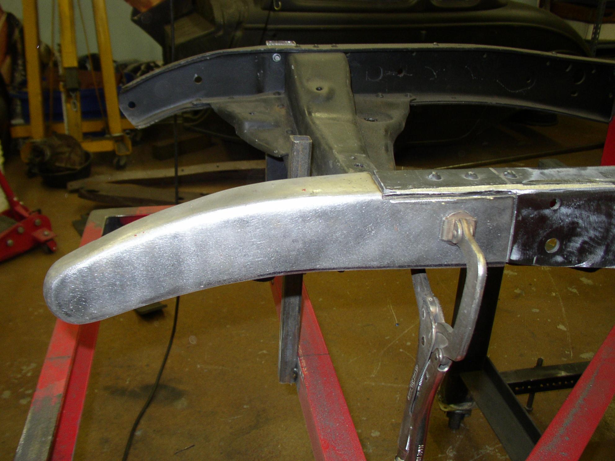

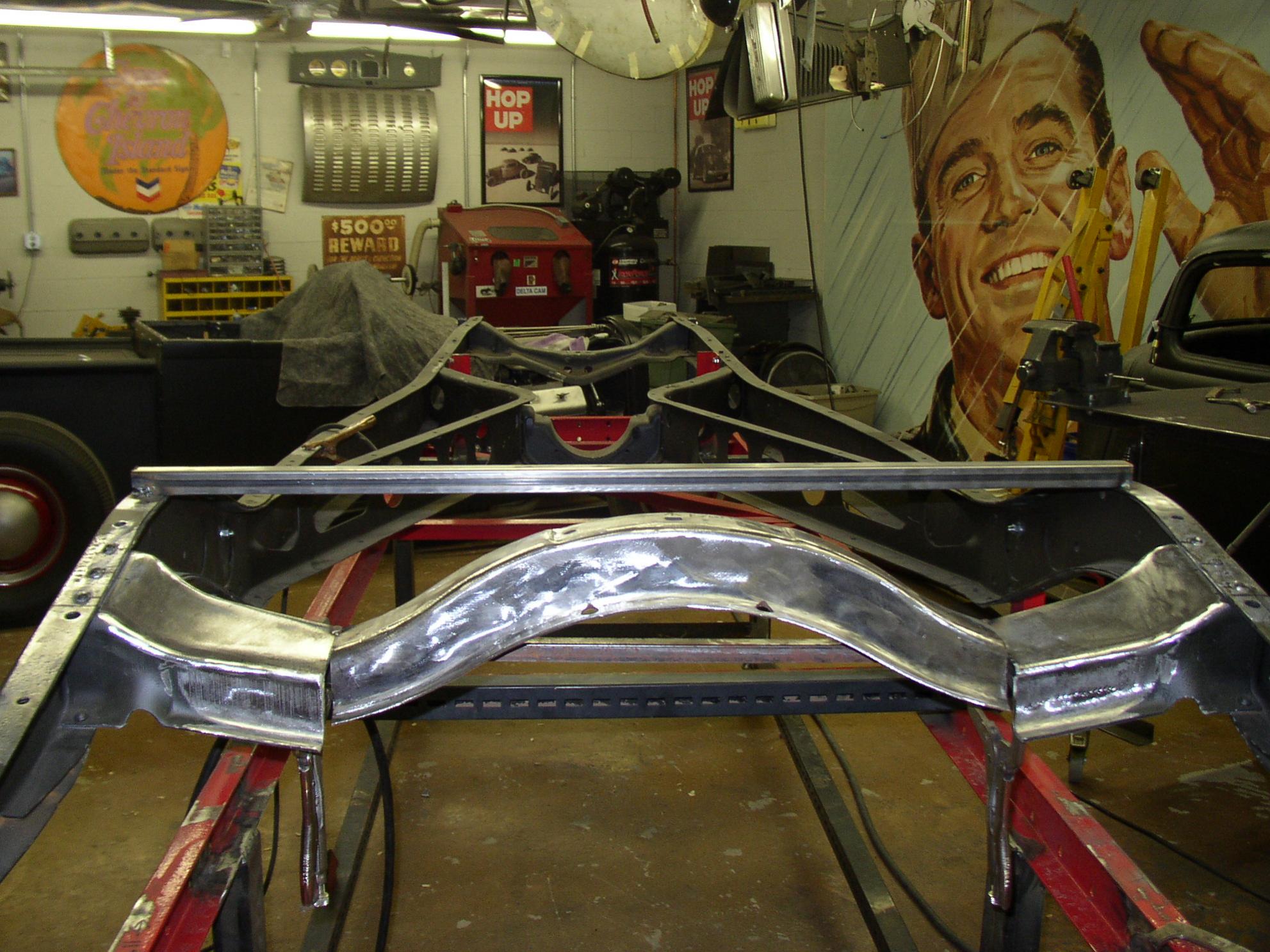

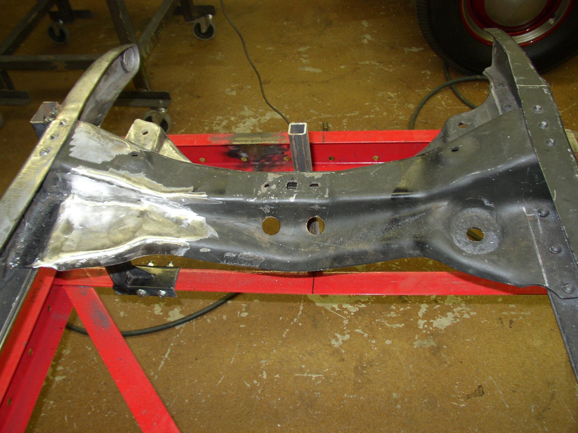

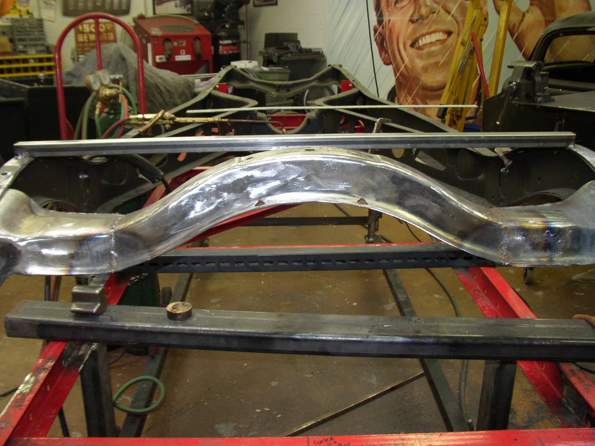

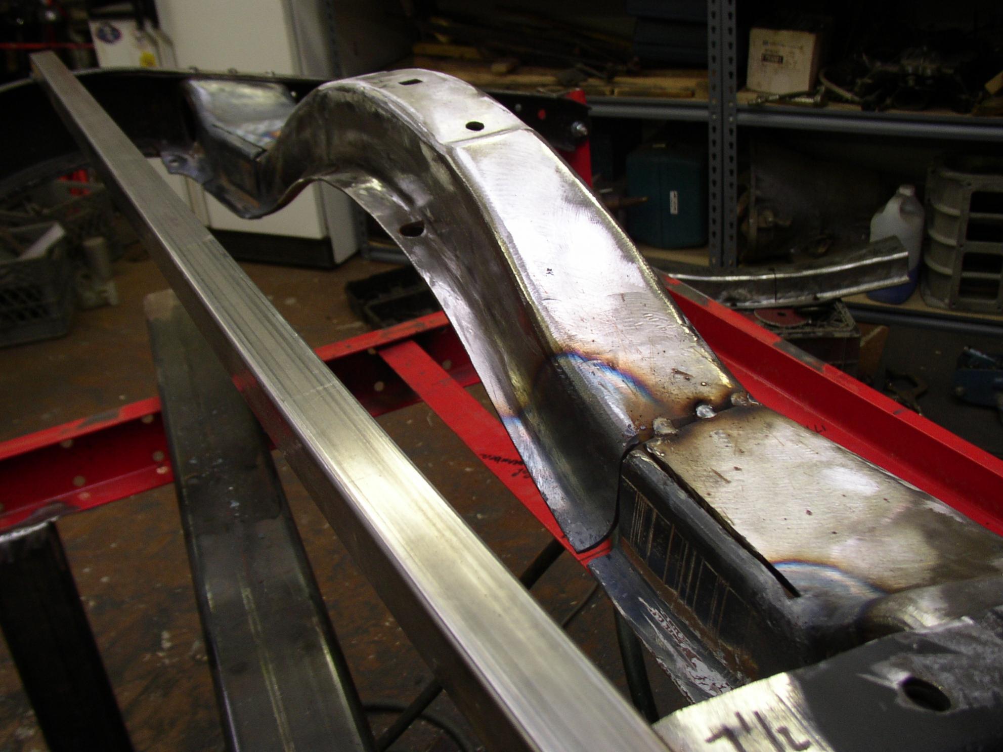

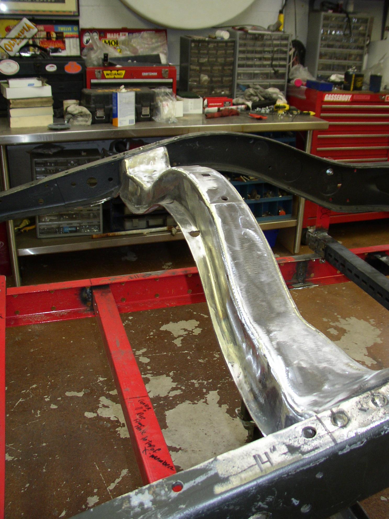

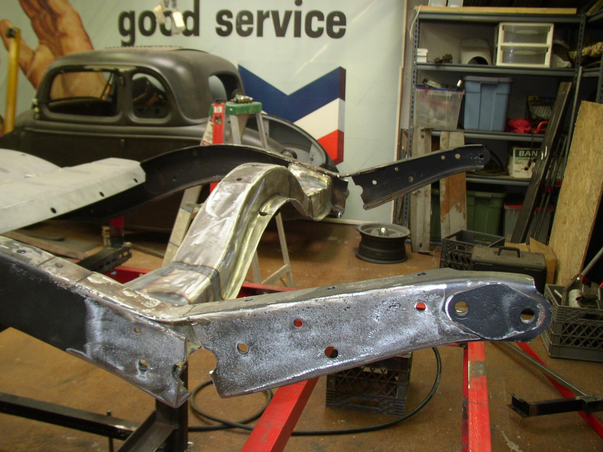

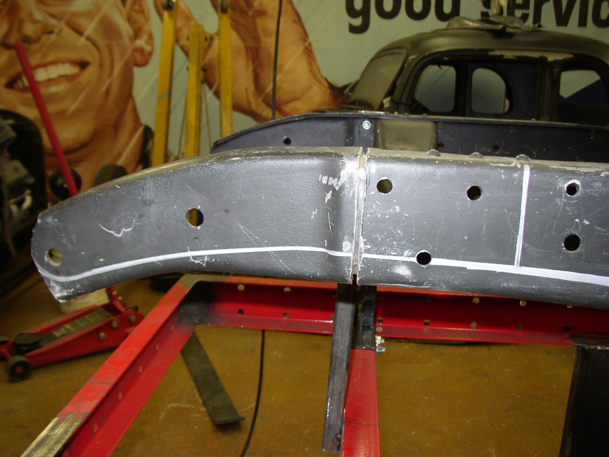

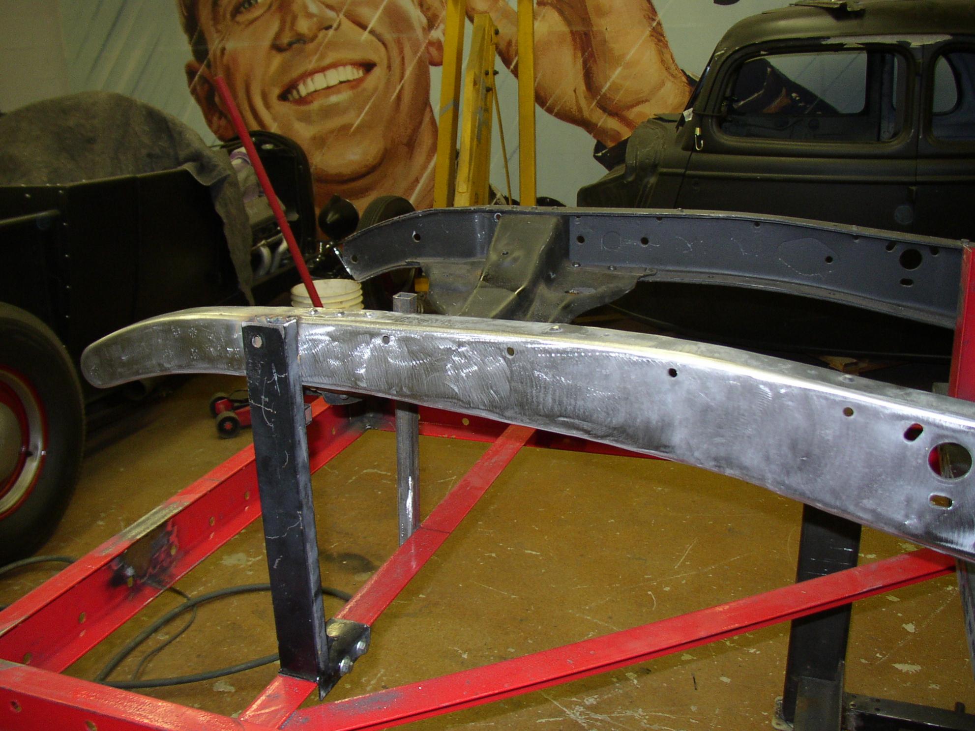

  13. The next order of business was too get after those bulky front frame horns, I have always like the slimness of Model A frame horns. I made this modification on my 32 frame under my 29 rpu and like the way it turned out. These may not be quite in order here. I had to modify the front cross member after this because of the slimmer frame horns Lots of work here. I left the majority of the stock crossmember in place so I could utilize all my stock sheetmetal mounting points as well as the radiator mounting point

  15. Kevin, You know I have told you about this project for many years. This is the year to get after it. Hey Kev!, Squeak Bell said he would help me chop this sucker when he gets back from NZ. You wanna come over and help since your so good at it?Ha !! Would love your help my friend. More front crossmember pics to follow

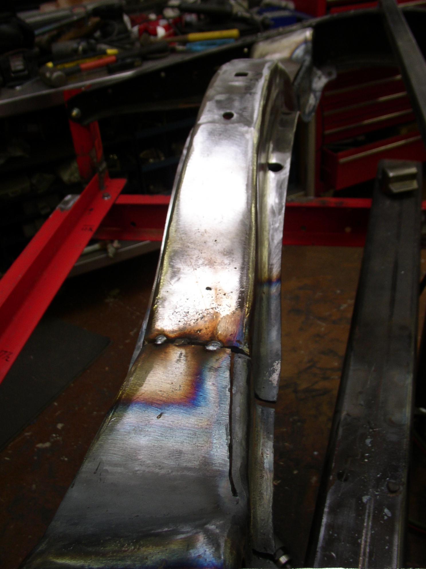

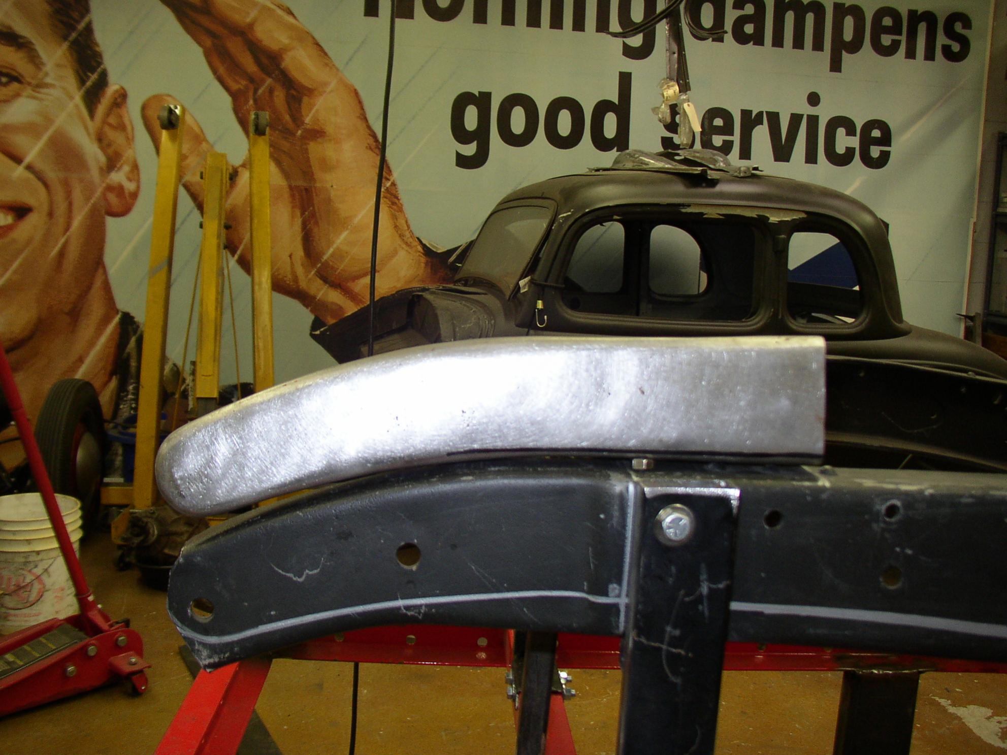

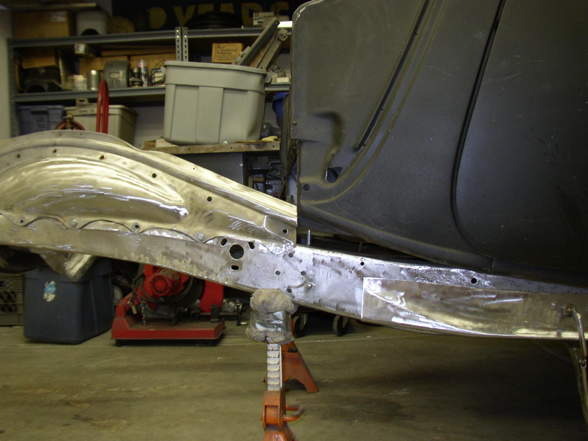

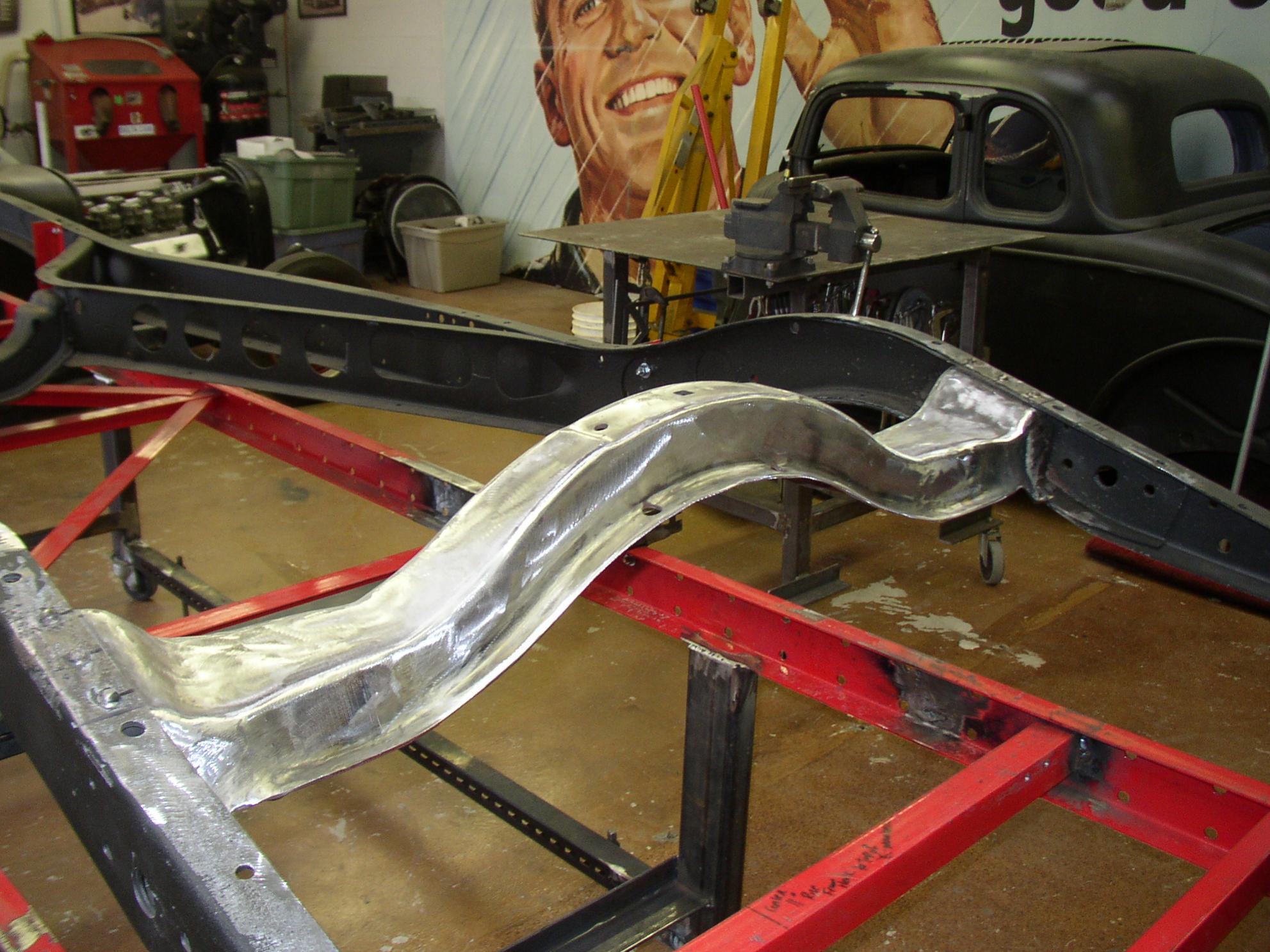

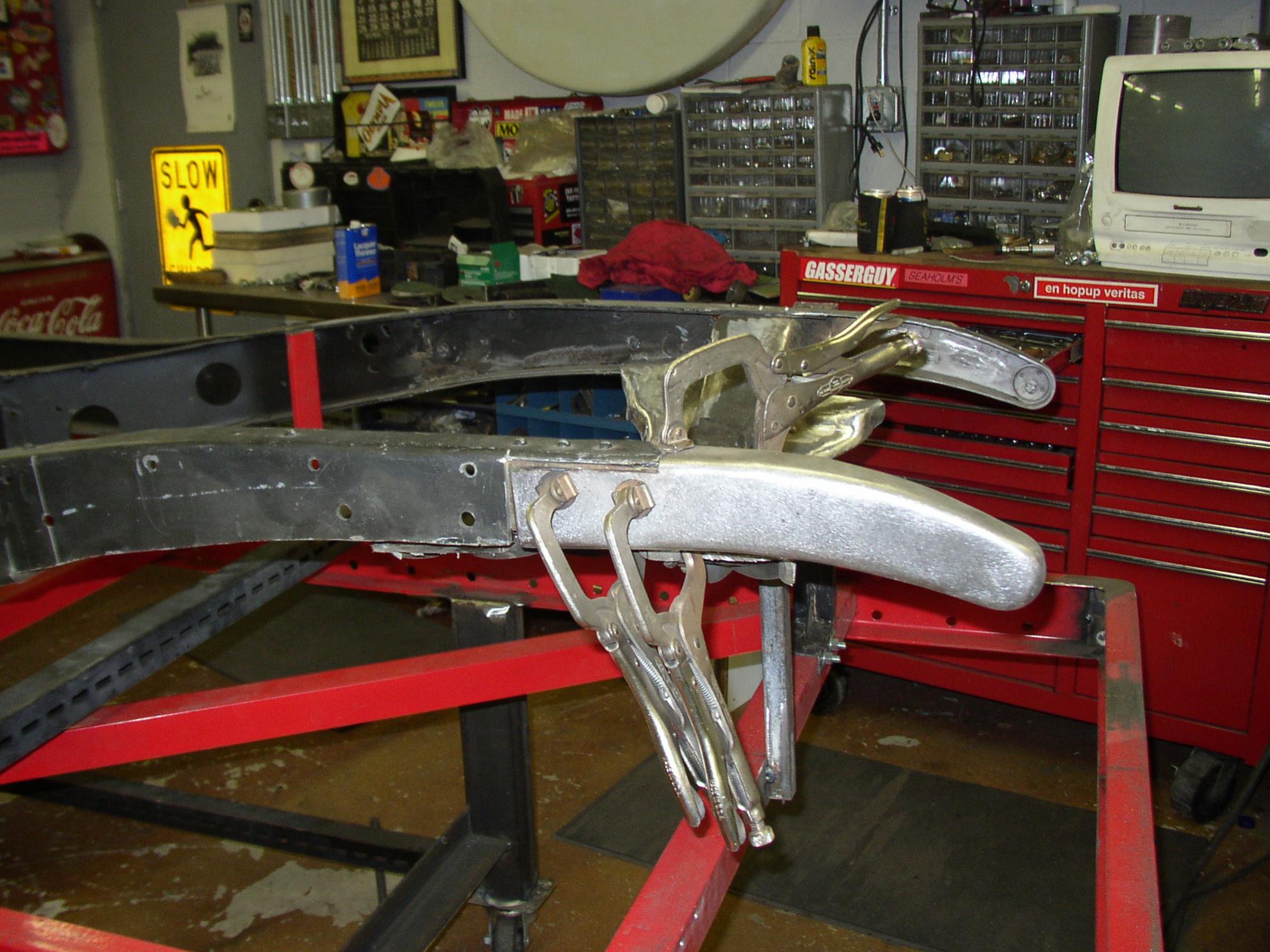

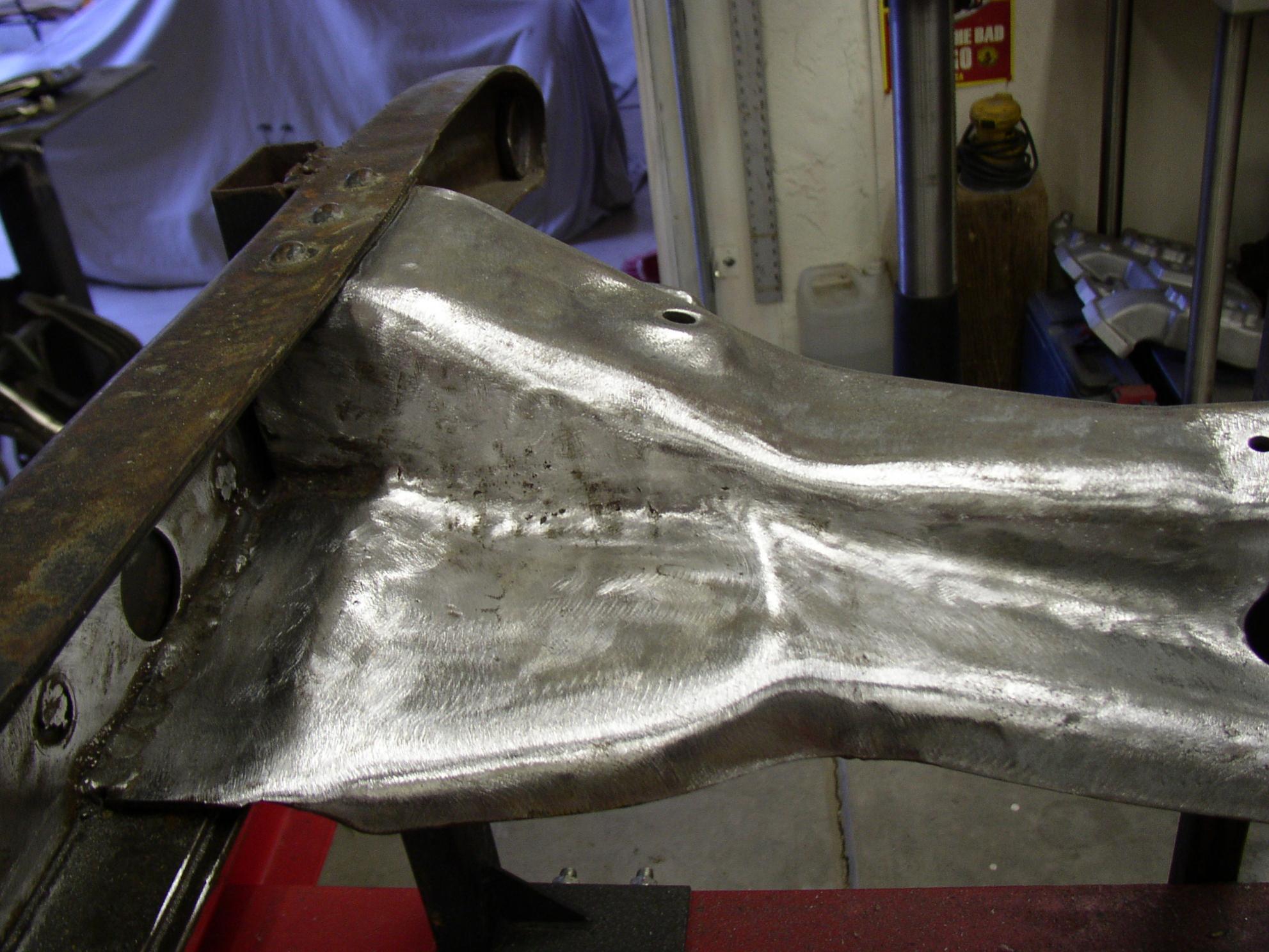

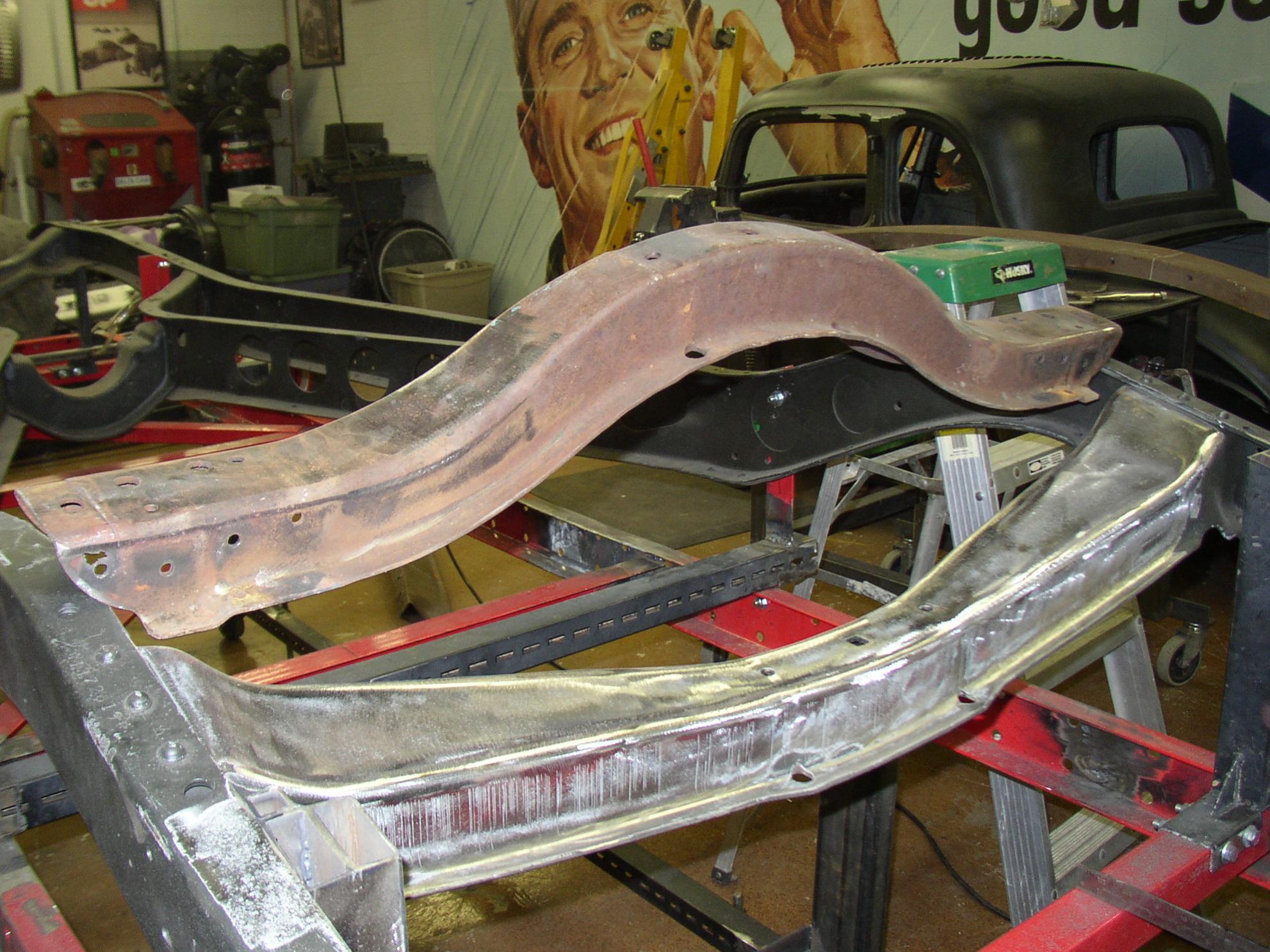

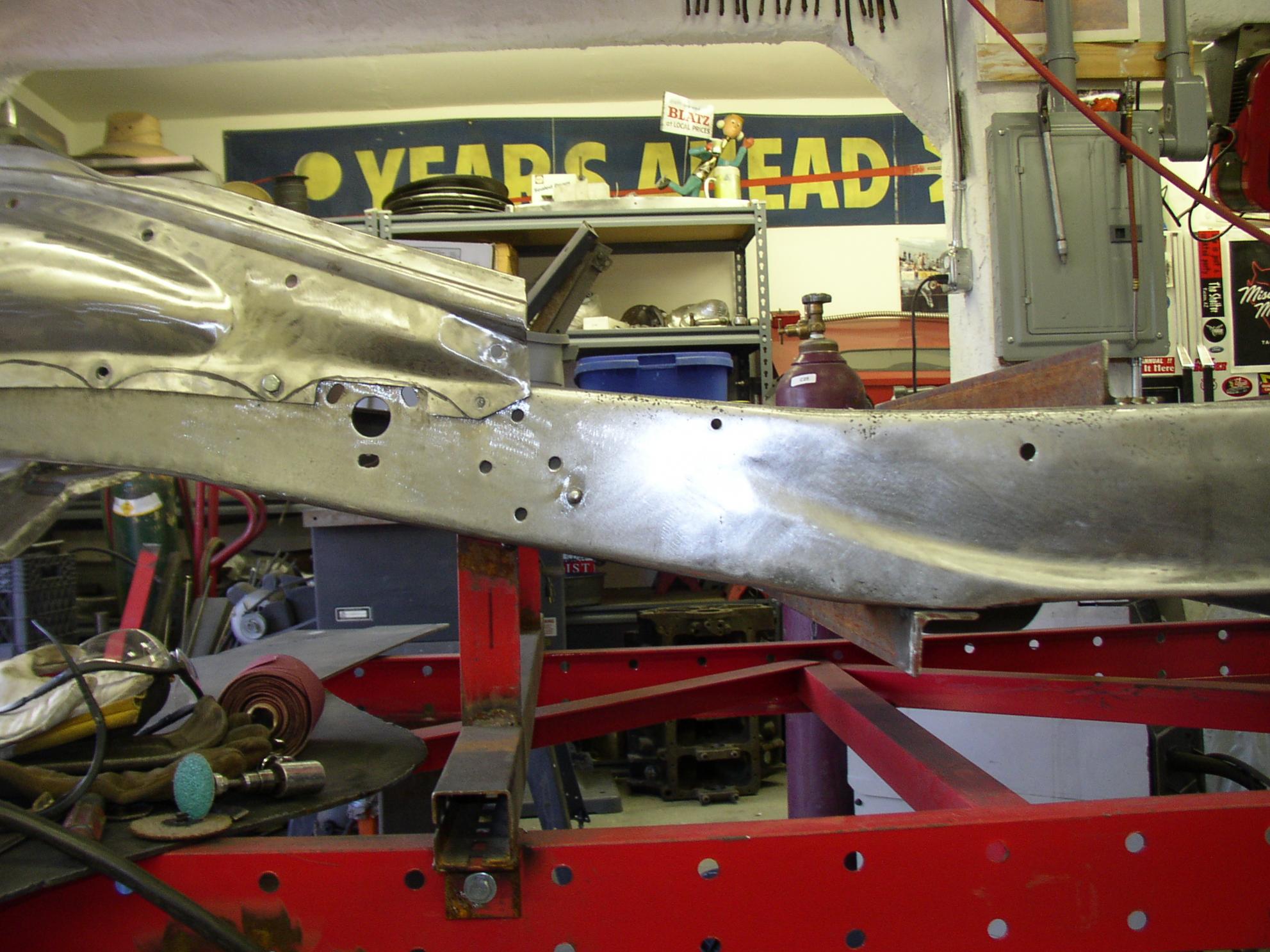

  19. One of the things I have never seen done is graft 32 reveals into a 34 Ford frame. I have seen a couple of old pics of 32 rails under 34 but never the mod I am doing here. There was a mopar coupe in the LA area that used 34 front sheetmetal on it and used the 32 frame. When I saw that car I knew for sure that I was going to go to the trouble of adding the 32 reveal. I talked to my good friend Squeak Bell about this and he thought I could pull it off. He just happened to have a junky portion of some 32 rails that I could use. Duane at Kiwi Konnection had a couple of short pieces to throw into the mix for me. I decided that the reveals need to be a little longer than stock so I added about for inches on to them so it would visual look right. I sent a few pics over to Brian Bass for a healthly second opinion and had my buddy Shawn from here in town come over and take a look as well. I want the reveal to swoop up into the body lines on the inner splash aprons like it belongs there. I think I have suceeded in the look I am after. Time will tell when I get the body back on the frame.

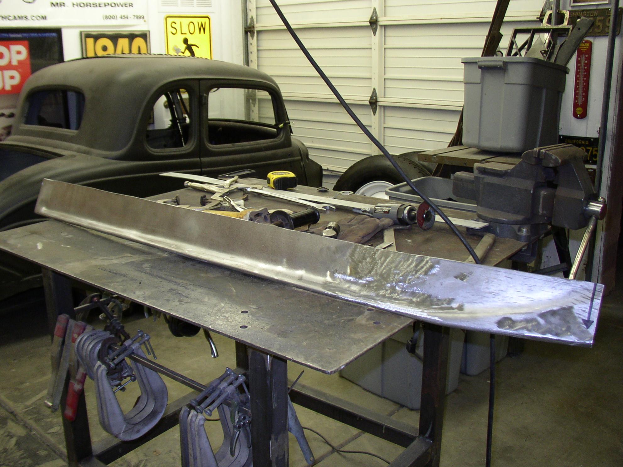

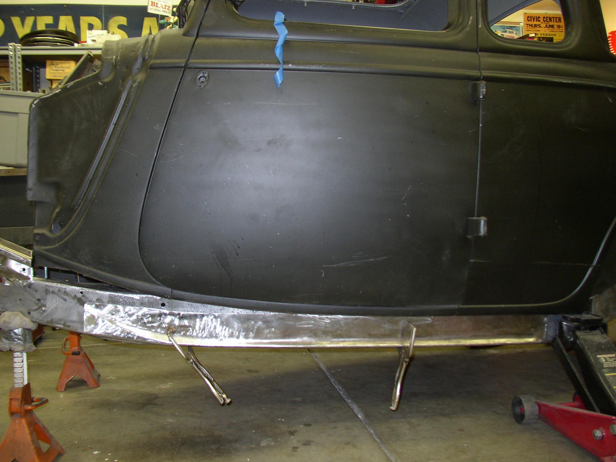

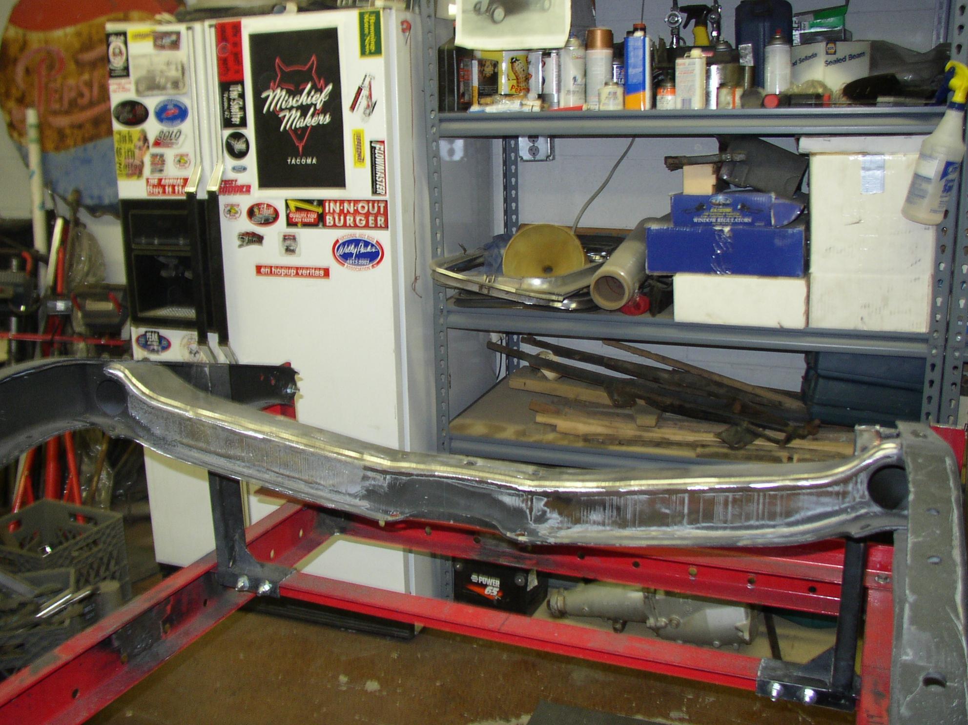

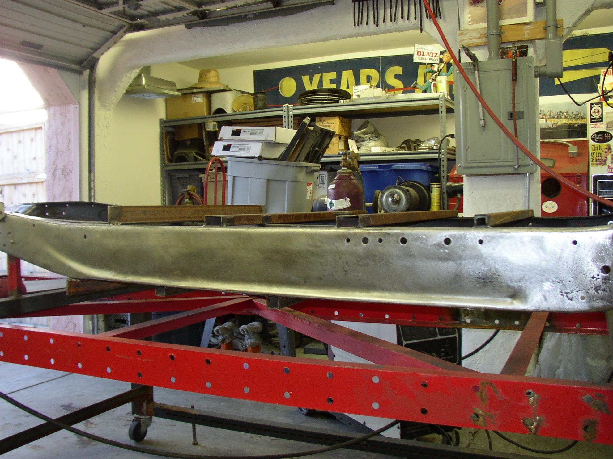

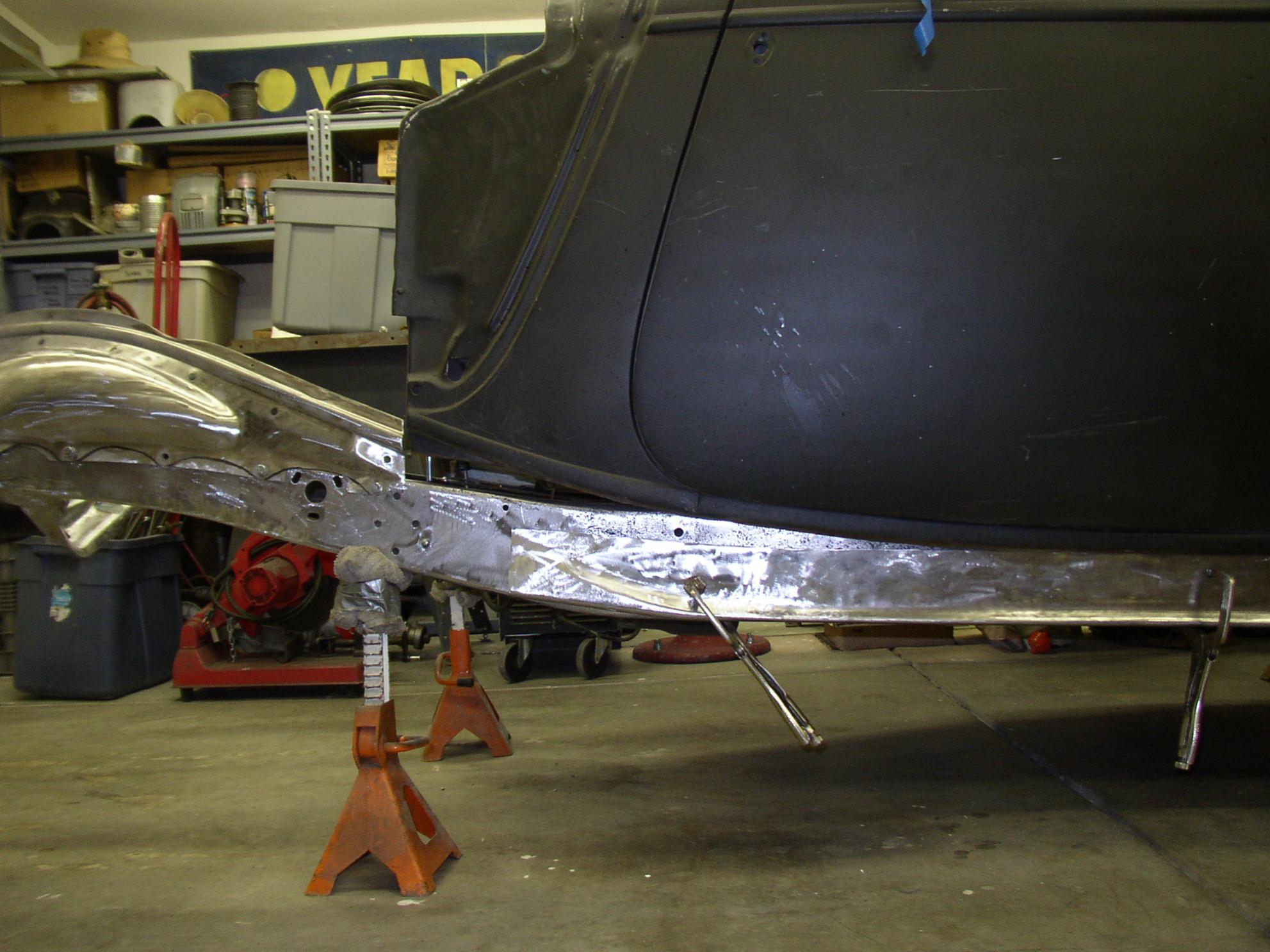

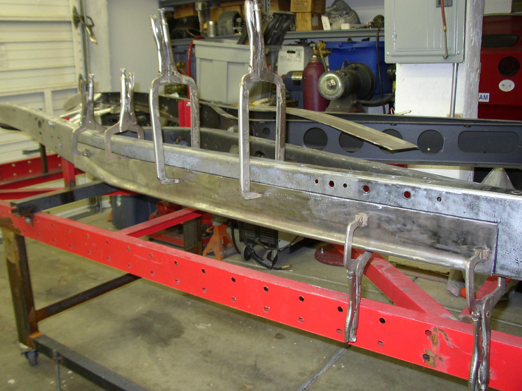

  21. More mods on the 34 frame rail. I have just finished the drivers side this weekend. I still need to finish up the bottom welding on the frame. Can't get to it in the frame jig very good.

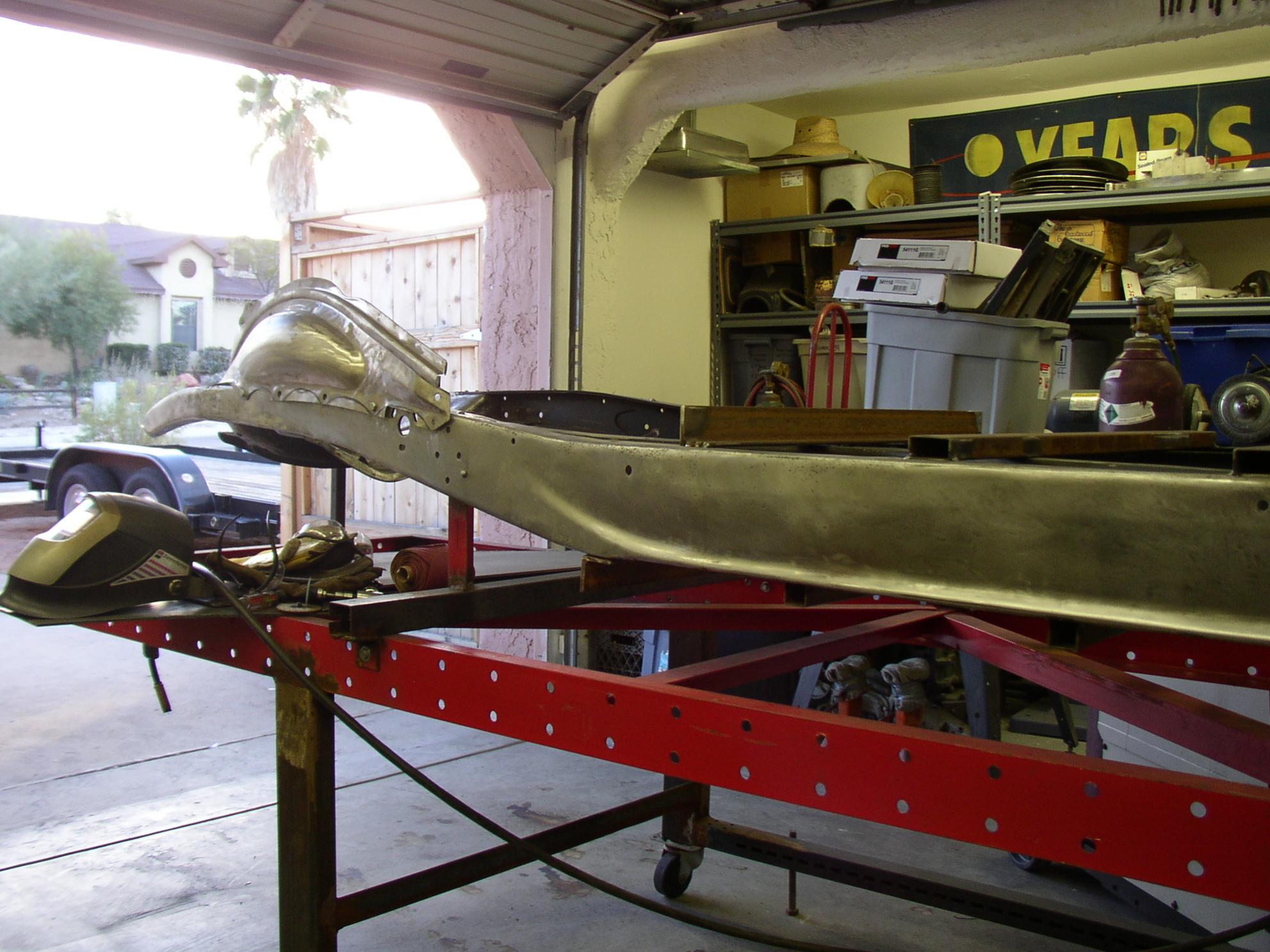

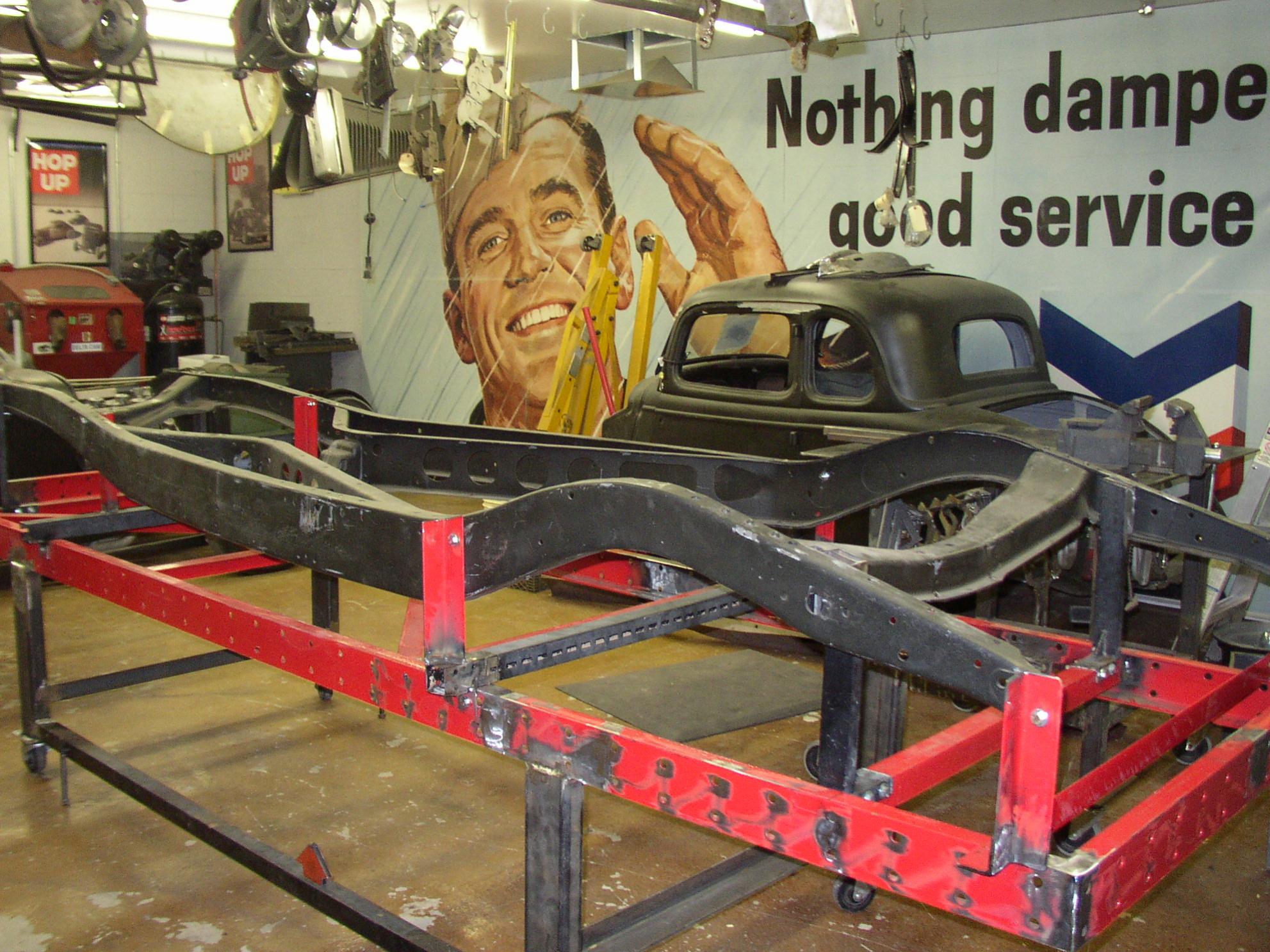

  24. Here is the look I am after. I am kinda a hack but I will get there. I think it looks good so far. This week I gotta get after the passenger side.

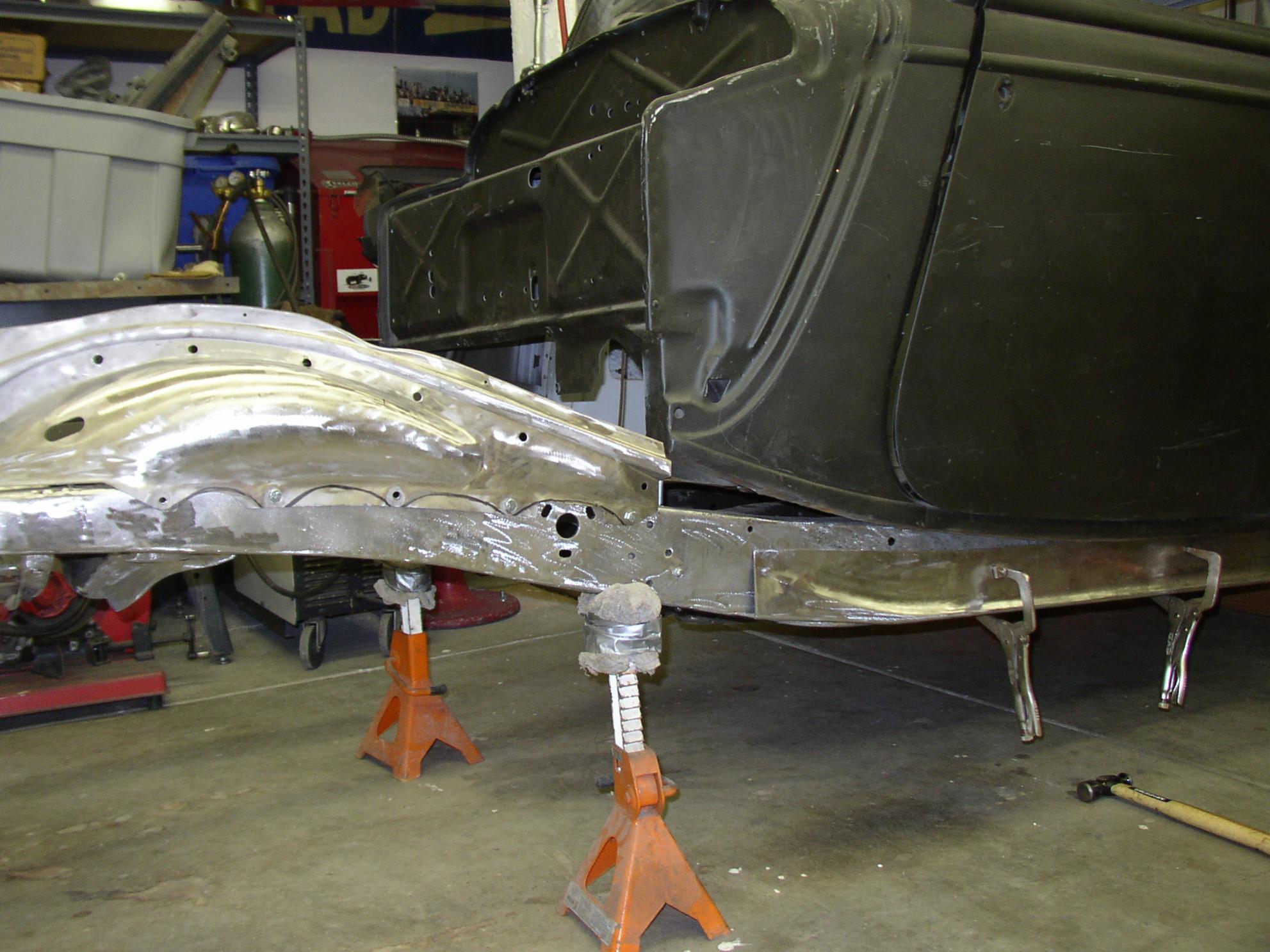

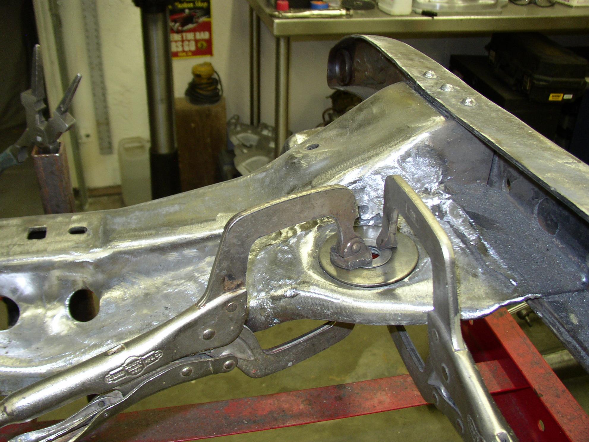

  26. Here are a couple of random shots that I missed earlier.

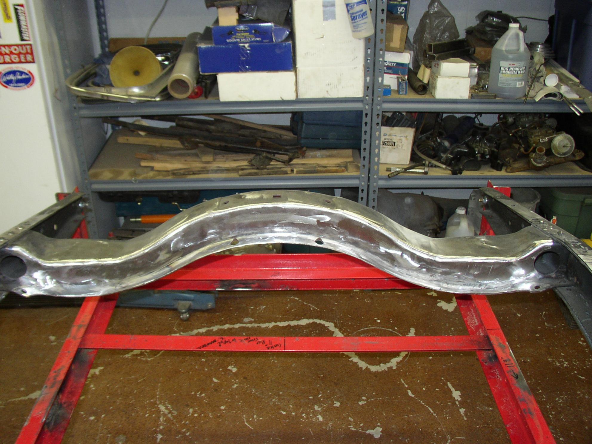

  27. I must mention this as I am sure someone will be wondering about the strength of the frame mod. I will be plating the entire section behind the reveal with flat stock to regain the structural integrity of the frame. I also will be adding the boxing plates from Ionia Hotrod shop with belled holes. Great product. I highly recommend the boxing plates. This frame will be solid.

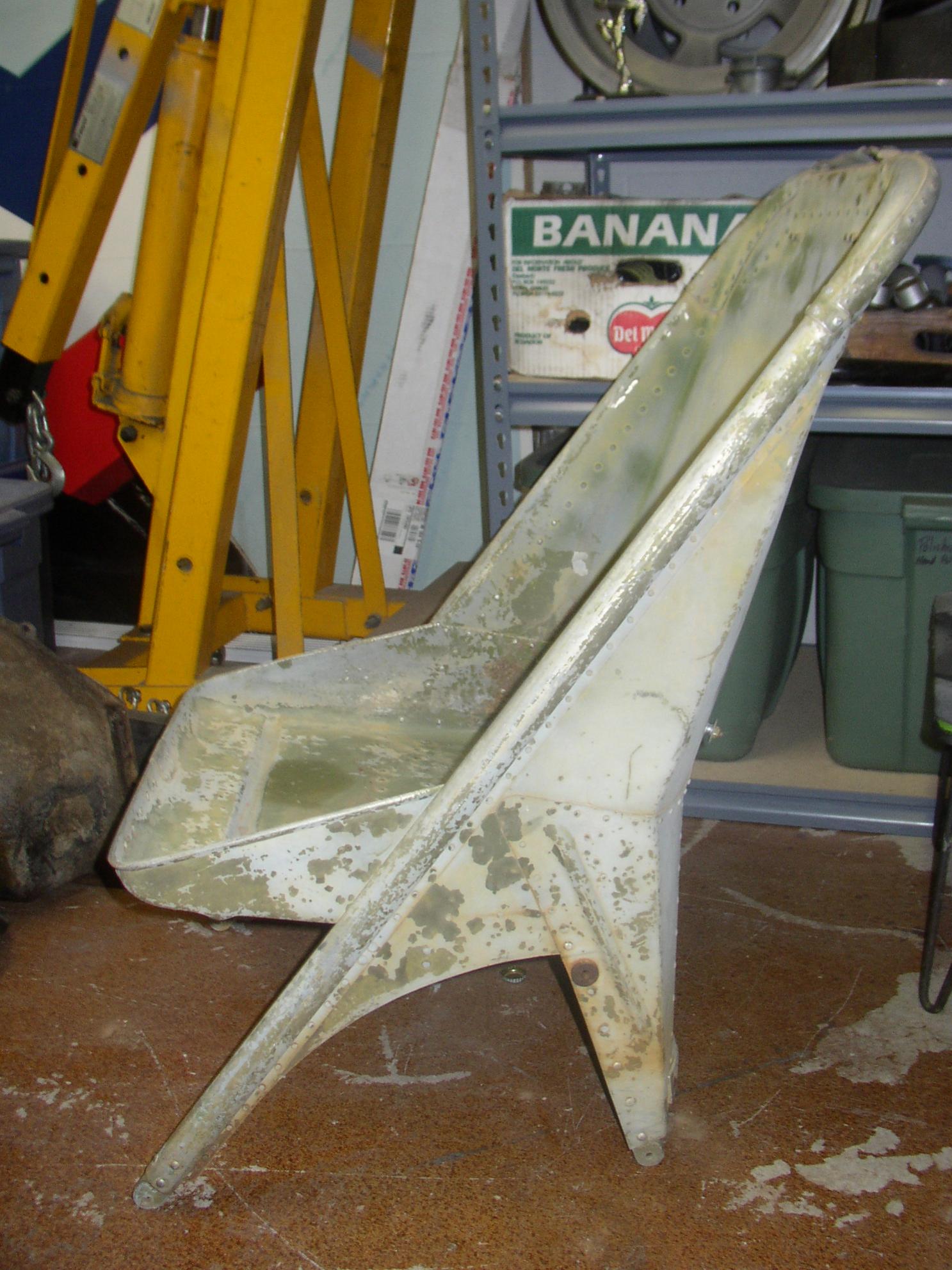

  30. As I am done the pics of my frame mods so far I think I'll give you a little taste of some of the stuff I have gathered for this project. Parts are always cool to look at. Here are the aircraft seats I am going to modify to work in the car. I scored them here in Tucson for 175 buck for the pair. I have no idea what they came out of. Any guess? They are more comfortable than some of the other one that I have sat in.
