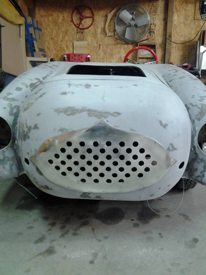

    The motor was painted with all the various attachments in place and was damned ugly. I detailed the engine room and made it pretty. The small grill the car came with was pitted and peeling chrome and compared to the Ziegler car was too small and I think a bigger grill looks better. I cut that out of a piece of 1/4 " aluminum, pounded it with a 5 lb sledge in a pile of sand to get it to curve to fit the car, then drilled the holes. Need to polish it up now

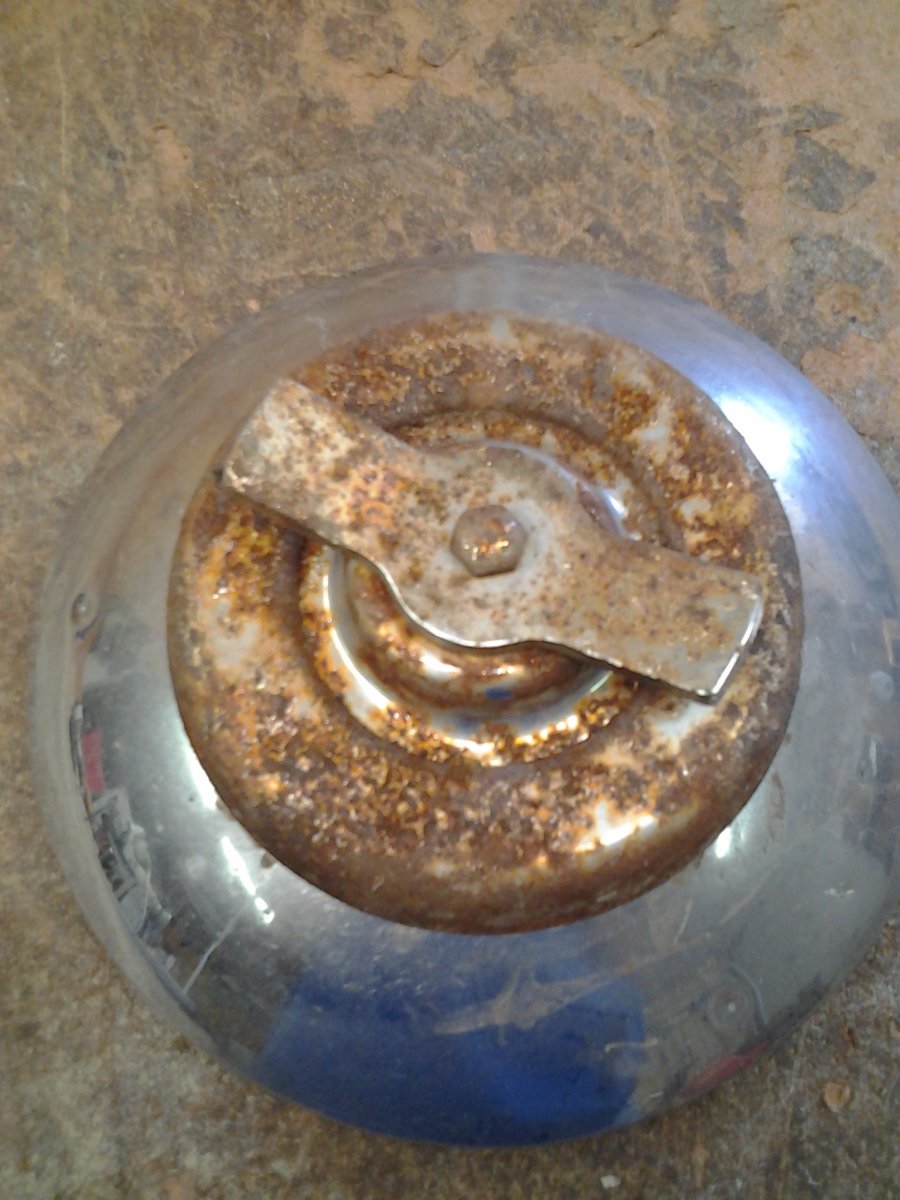

    The wheel covers were nasty. They were nothing more than Crosley hubcaps with a center and spinner added, both poorly chromed.I tricked them up. The center now is made from a stainless steel catfood bowl and the spinner came from the local truck stop. I guess truckers use them to spice up their hubs

    I hate to be a critic, and the catfood bowl looks great, but those 3 eared spinners are really tacky 80's looking. You could easily cut out replacement copies of the old ones from stainless if you don't want to pay for chroming. Sure they were homemade looking, but they were period authentic.

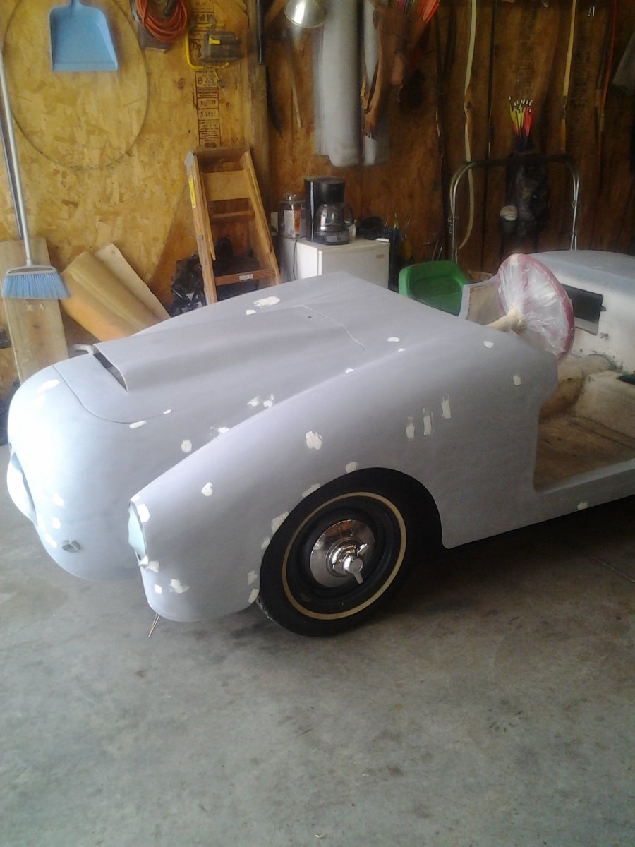

    Shot it this morning. Waiting to let it dry a bit before putting out in the sun IMG_20151023_125242.jpg
