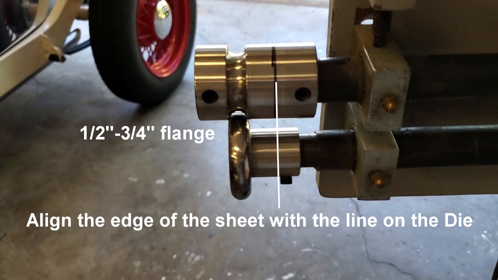

    Great video but I have three questions. Can you post a pic of your bead roller, what were you lining up to the mark on your roller as it looked like you were a ways away from the edge, and what’s th enamel of the music you used?

    A budget bead roller will not feed .062 Aluminum very well. You must have at least a 1/2" flange so that the die has enough friction to pull the material through the dies, plus it's very difficult to control the feed while trying to add the bead along the very edge without an flange.
    The mark on the Die is used as a guide along the outer edge of the aluminum sheet, you can also draw a line where you want the bead on the sheet.
    View attachment 5443692 [/QUOTE]
    Well that’s a neat tip! Thanks.

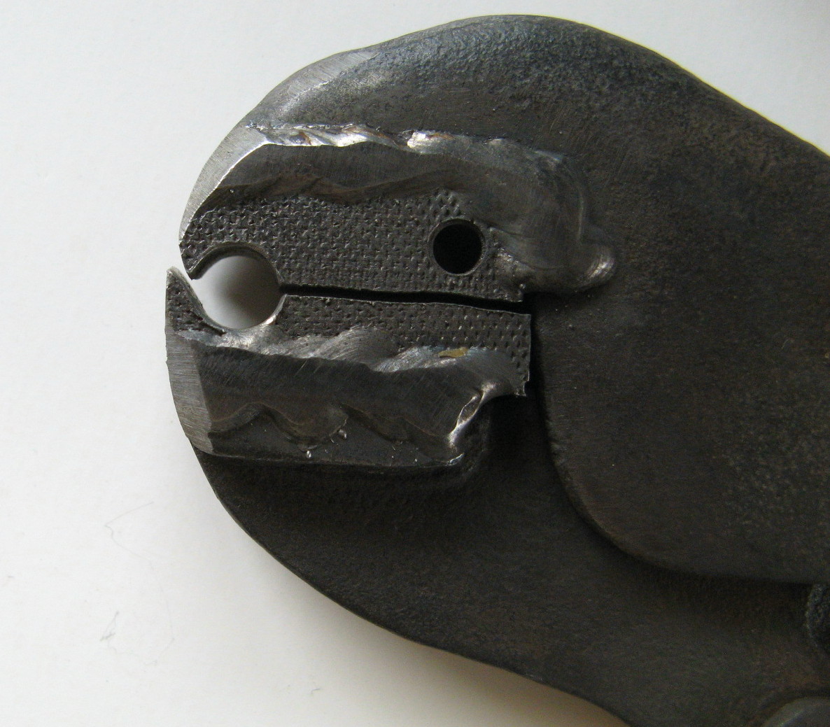

    I have found a pair of vice grips, modified to accept a wire edge, to be helpful.
