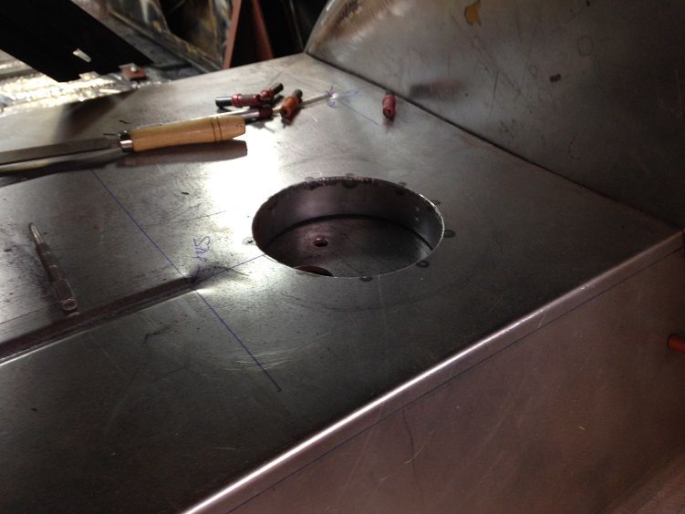

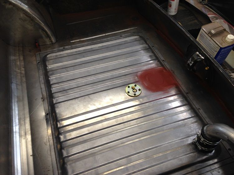

    We finally got the inner tub extensions to the inside of the body done so I figured I’d post some pics, I test fit the gas tank one last time before the paint began to fly and luckily it still fit.
    Here is the top part above the C notch, when lay’d out the diff of the rear end comes above the C-notch about 1/2” so I made the sheet metal go 1-1/4” above the notch to clear the diff, here’s a shot of the collars I made to space up the metal so I can still access the top of the airbag hardware
