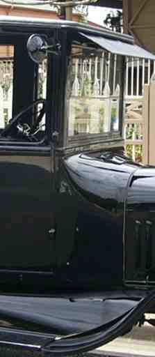

    Ye, it looks like a '23 or '25, because it's the same body. Ford did not re-tool to make a different Fordor body for '26-7, they used the same body they had been using for a few years. They put '26-7 fenders, etc, on them but the body itself is the same as earlier ones. Unlike other '26-7 Ford body styles, this one is built using a wooden framework with the steel panels tacked on, as were all the earlier Ford bodies.
  20. rab71
    Joined: Jan 1, 2007
    Posts: 572
    rab71
    upload_2016-10-12_9-18-35.png This is a 27 fordor.
    This is pre 1925 the black one. It is longer and notice how the hinges mount to the pillar. That pillar is also different. Mine is a 27.
    upload_2016-10-12_9-21-51.png and here again is 27>>> upload_2016-10-12_9-22-20.png

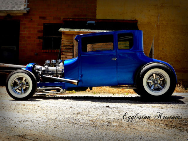

  22. rab71
    Joined: Jan 1, 2007
    Posts: 572
    rab71
    And this. But this one is channeled. I don't really want that.
    kiwijeff likes this.

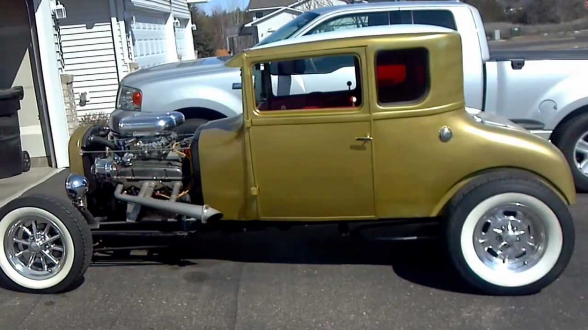

  23. rab71
    Joined: Jan 1, 2007
    Posts: 572
    rab71
    This is great also channeled. But I can't find Fordors...
    kidcampbell71 and kiwijeff like this.
