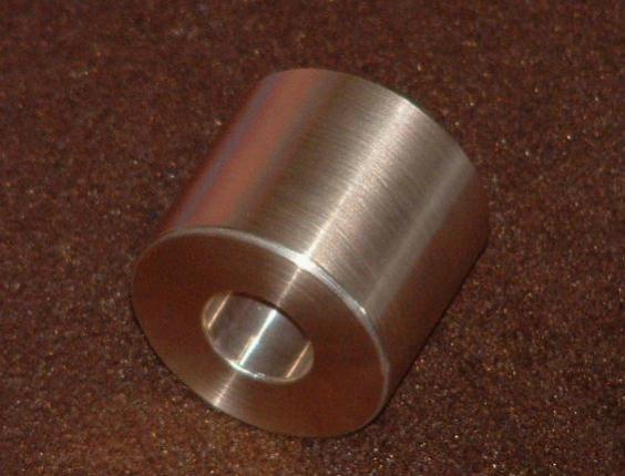

    Here are some bellhousing photos in case anyone is interested in what one of these looks like:
