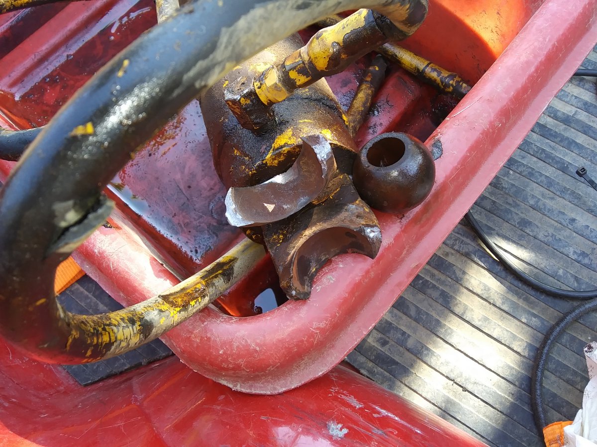

    While we're on the subject, this broke on me yesterday. Looks like it was cracked already. I don't think JB weld is going to do, much as I like the stuff. Hoping I can TIG it tomorrow and get back to work Friday. Should be cast steel no? Going to have to put the ball in first, I guess. No special rod? Maybe add an extra strap around the outside.
