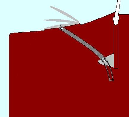

    I had thought this out a little for my car and was going to use a curved alternator bracket welded to a base to mount to the vent, a bolt with spring and make a handle. I dunno if that's enough info to picture it but that was my plan..

    Adjust tension on the bolt with a spring through it, put the handle in a comfy enough spot you could adjust at any speed.

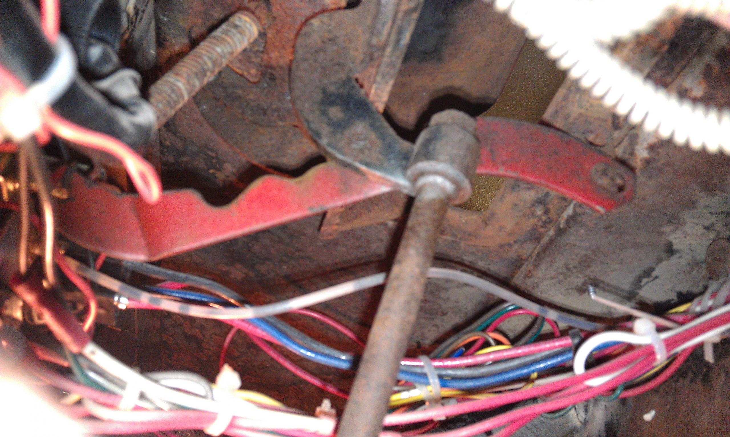

  13. Hi Eric, This is the Willys item and they don't come more basic that that. You could put more notches where needed. JW
