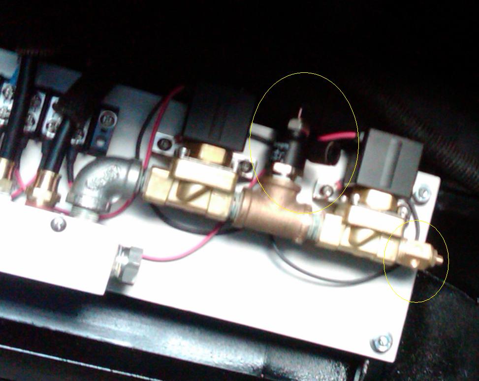

heres a link to some cheap valves on ebay. seach "electric solenoid valve" rather than air ride valves thay are the same thing just a lot cheaper. pay $10 each instead of $40 each http://www.ebay.com/itm/Electric-So...135?pt=LH_DefaultDomain_0&hash=item19c931c76f
